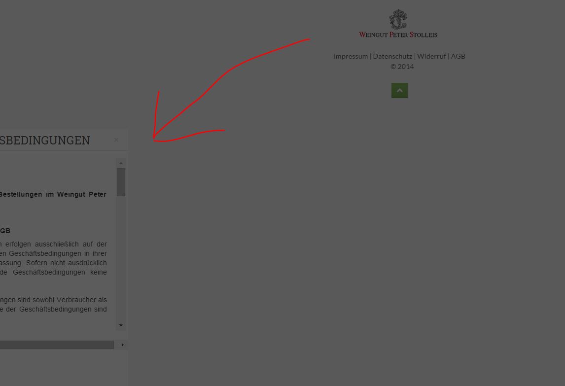

Hello I got a problem with the "terms and conditions" popup. I tried to display it.
The popup in the checkout appears, but the terms were not displayed in a correct way.
The text is displayed in the left corne at the bottom of the popup and you are not able to read the text .
See attached file for more info
Can you help me?

In the HikaShop backend, -> System -> Configuration -> Display tab -> General display options, what's the "Popup mode" set to? Try "Mootools" and save, that should solve it.
(In Deutsch: -> System -> Konfiguration -> "Anzeige" Tab -> Allgemeine Anzeigeeinstellungen -> "Popup Modus")

It works!! Thank U very much !!!
