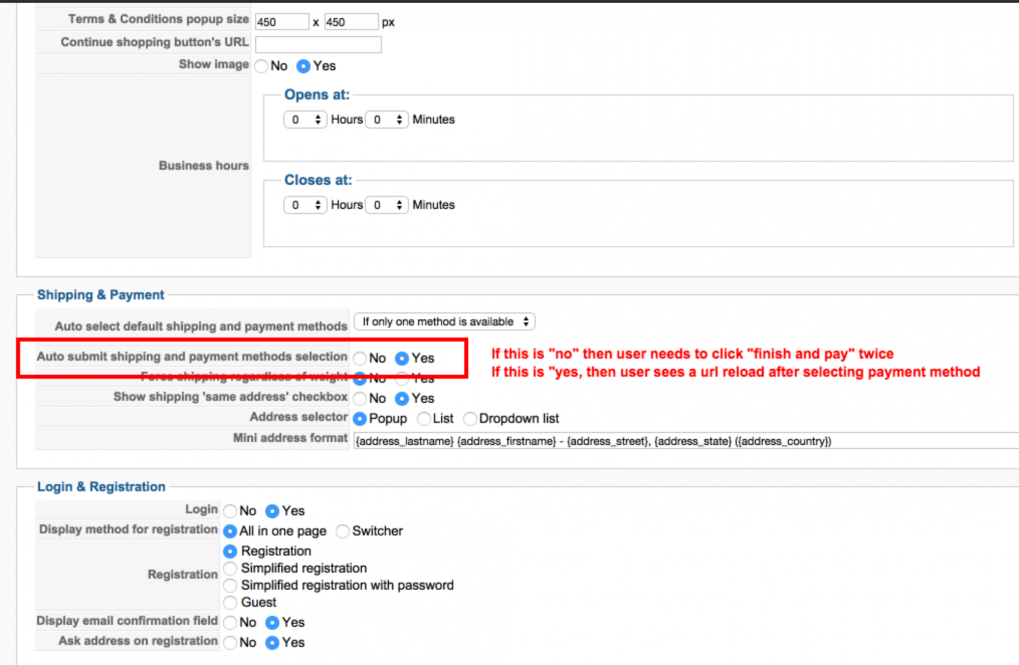

11 years 10 months ago #178107
Sorry, I am still trying to solve both issues (this one and ticket #177624)
Please have a look at the screenshot: awesomescreenshot.com/0ea3s6r503
11 years 10 months ago #178109
if you set that option to YES, your page will automatically "reload" so that the choice of your customer will be submited and that their cart will be updated.

11 years 10 months ago #178217
Correct. I understand.
I would like the page to not reload AND i don't want user to have to click "finish and pay" 2x...

  • Posts: 26386
  • Thank you received: 4078
11 years 10 months ago #178287
It seems but in fact no.
When you select a shipping/payment method ; it will affect the order by changing is price for example.
And also selecting a shipping method could allow you to select some payment method which wouldn't be available before.
But when the cart price changed, there is an obligation to display the final total to the customer before processing the payment.
That's why using an option to auto-select or to automatically submit when selecting ; allow to always display the final total and process the payment when the user click on "finish".
This kind of problem will be fix in HikaShop 3.0 where we planned to make a refactoring of the checkout (using ajax and dynamic refresh).
  • Posts: 241
  • Thank you received: 5
11 years 10 months ago #178294
Ok. I understand. We sell event tickets so the "shipping" is not relevant.
Will look forward to the ajax/dynamic refresh solution and will stick with the url call for now.
