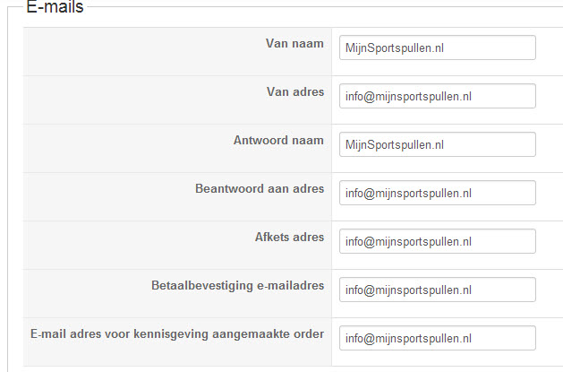

We entered This email address is being protected from spambots. You need JavaScript enabled to view it. as e-mail address in the HikaShop (see attachment) and still the orders are sent from This email address is being protected from spambots. You need JavaScript enabled to view it..
Where is the HikaShop taking the address from?
During the building of this shop this e-mail was entered: This email address is being protected from spambots. You need JavaScript enabled to view it., but later we changed it into This email address is being protected from spambots. You need JavaScript enabled to view it..

We are using the "Van adres" field value for the emails.
Don't you have edited the from address value in the "Sender information" tab when editing an email via the menu System > Emails ?

11 years 10 months ago #178160
That's it!
Thanks a lot!
