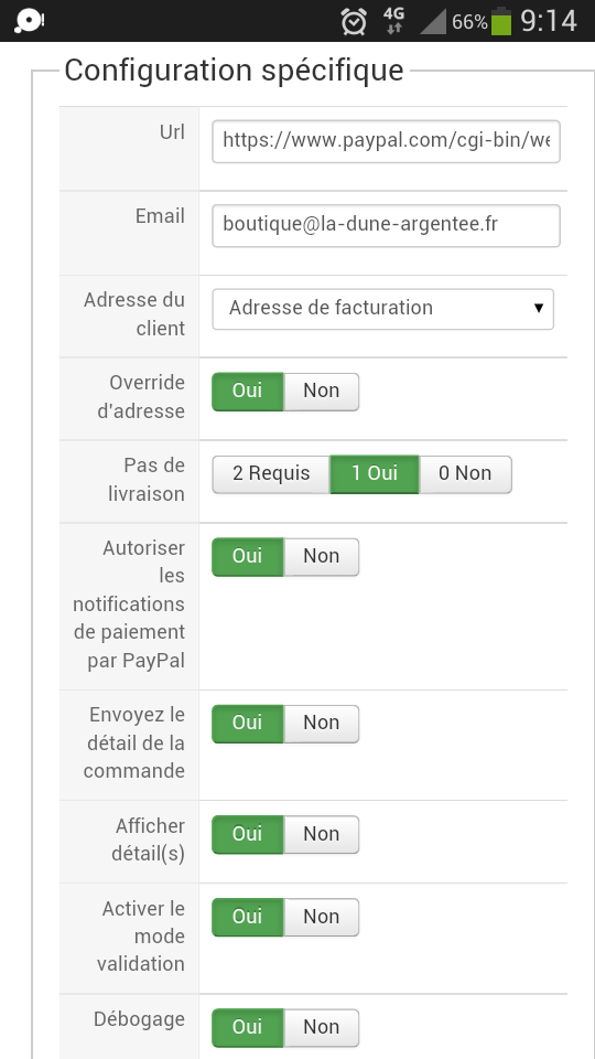

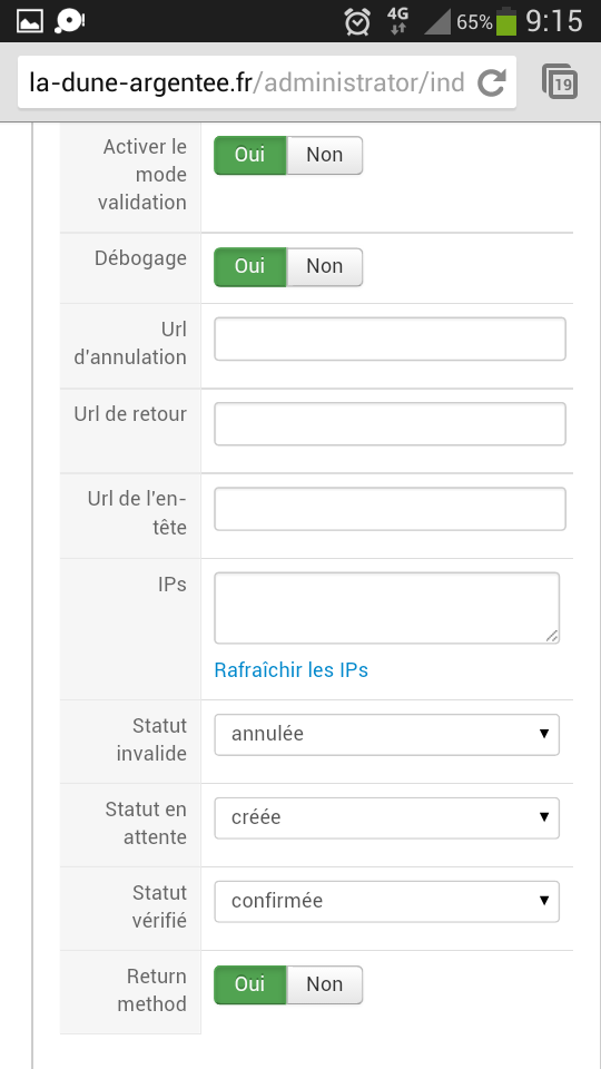

  • Posts: 21
11 years 10 months ago #179584
Thank you for your attention.
This is my PayPal configuration.
11 years 10 months ago #179603
Can you set the "Envoyer le détail de la commande" to NON and test it again ?
Thanks.
The following user(s) said Thank You: Dilak
  • Posts: 21
11 years 10 months ago #179673
Thank you so much ! It's working now !
