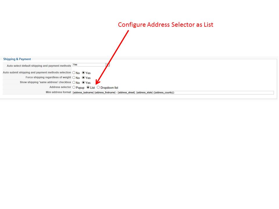

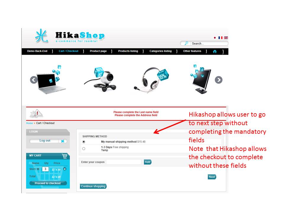

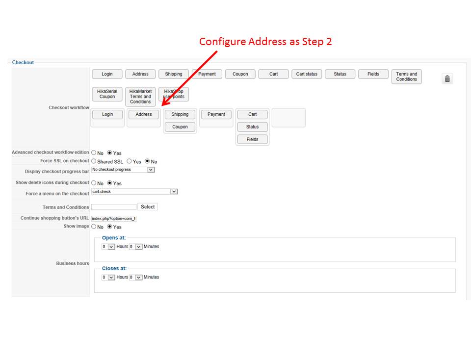

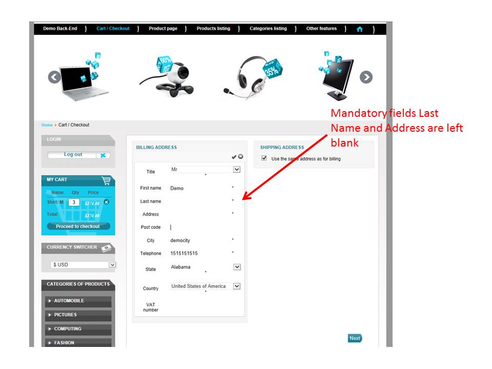

Hikashop allows the checkout process to move on to the following checkout step (and eventually complete the checkout process) without mandatory fields being filled in.
Please see attached images (which was produced on the Hikashop demo site).

Add the code:
if($result===false){
			return false;
after the code:
$addressClass = hikashop_get('class.address');
		$result = $addressClass->frontSaveForm();
in components/com_hikashop/controllers/checkout.php
and add the code:
}else{
					return false;
after the code:
$r = new stdClass();
					$r->id = $result;
					$r->previous_id = $id;
					$ret[$currentTask] = $r;
in the two places of the file administrator/components/com_hikashop/classes/address.php and that should hopefully avoid the issue.
