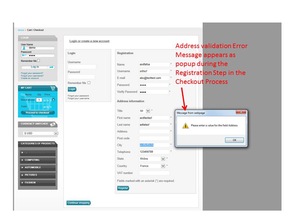

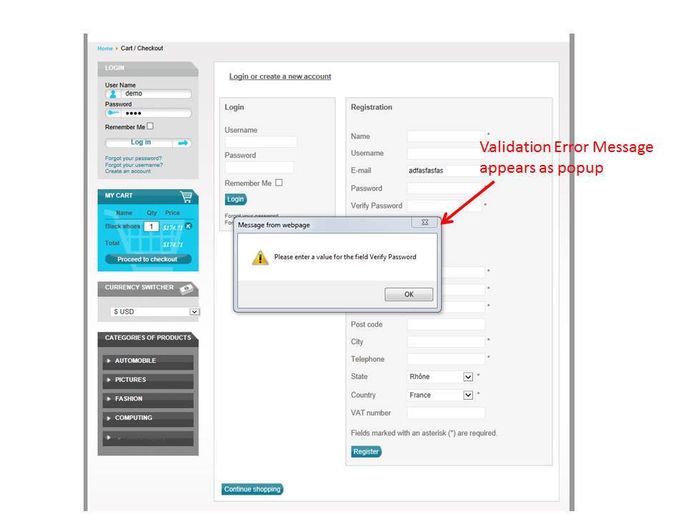

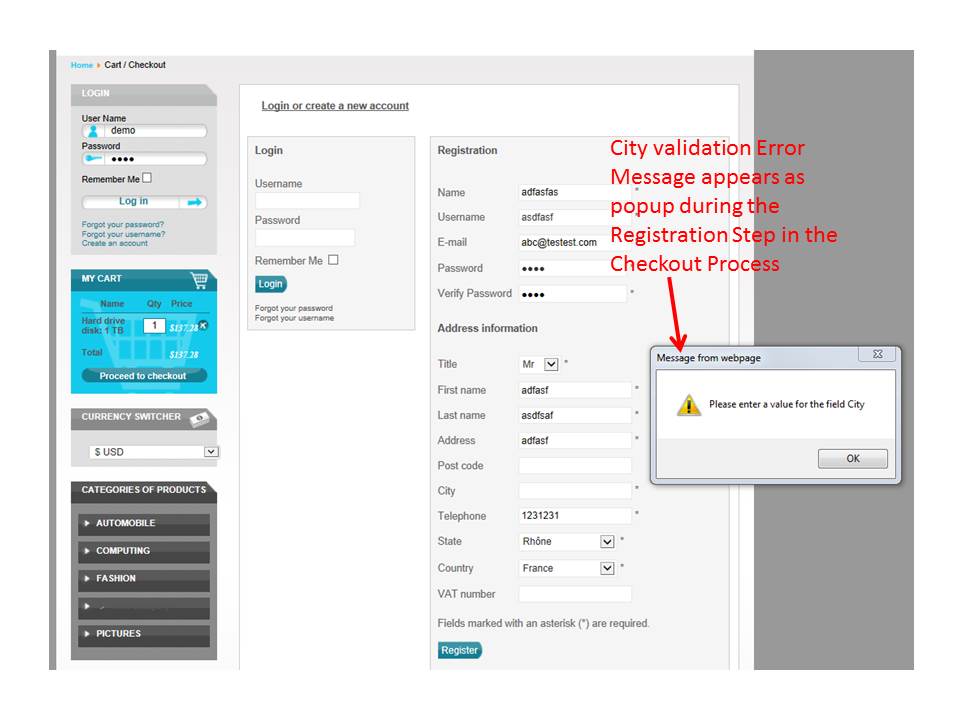

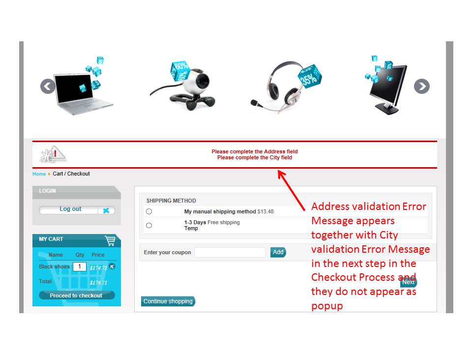

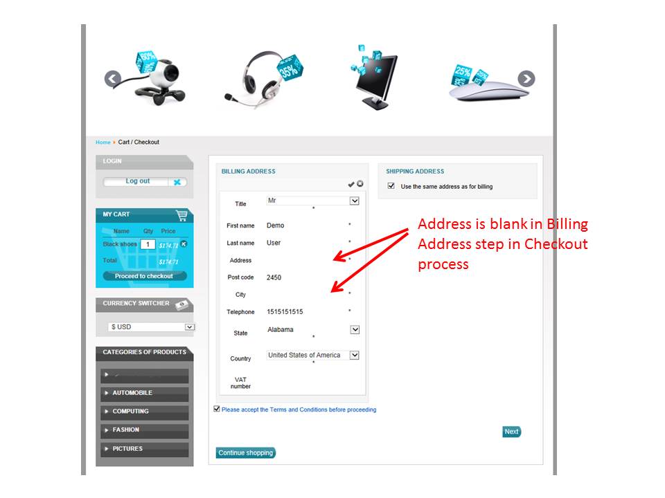

The field validation behaviour and error message display are inconsistent during the checkout process. Sometimes the error is displayed as a popup and the user cannot proceed until the error is corrected (i.e. one error at a time) whilst at other times, the errors are lumped together (and the user is allowed to continue to the next field and/or step) and then, all the errors are displayed together at the Joomla! message area.
Please see the attached images.

We are currently working on a re-factoring of the checkout for HikaShop 3.0
The new checkout will handle it with more consistency.
