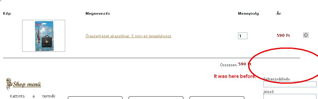

I don't see the checkout button in the basket even I am logged in.
What can be the problem?
(It worked before, I have no idea what happend, maybe I changed something in the options, but I don't remember. I don't think that I caused this because I didn't make any changes except the quantity of the products. Is it possible, that it just happened? I really don't remember that I made changes. Previous Wednesday it was ok, because I received an order that day.)
It's very important for me, because there is no button and there is no opportunity for a customer to make an order. :(

As you can see, I made a Checkout button on the right(Pénztárhoz button).
It's an urgent tinkering solution : ), I used this topic to make it:
www.hikashop.com/forum/4-how-to/28372-pr...oduct-list-page.html
It works but, It's not the normal process. :silly:

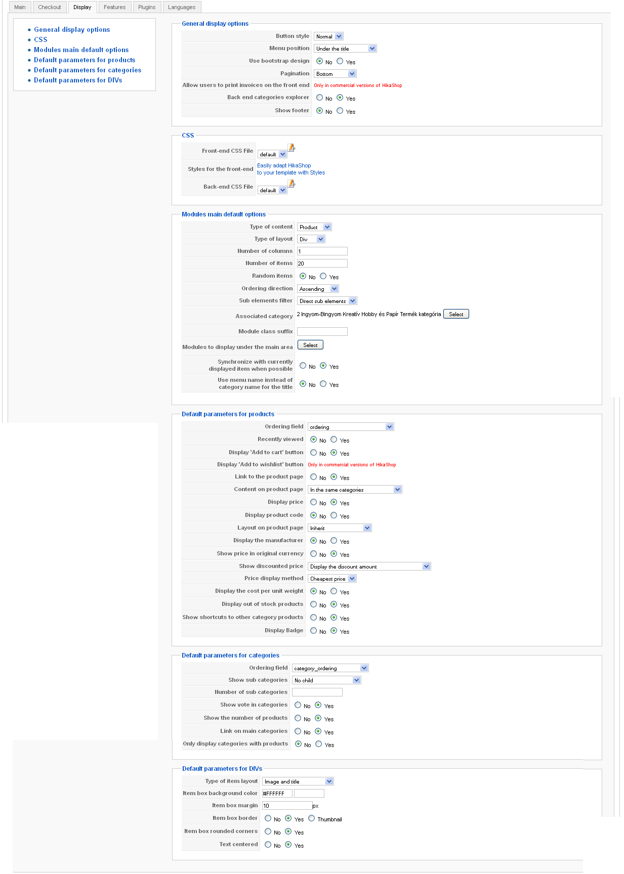

I attach a picture with the Display sheet configuration. I hope this is where the problem is.

Sorry, I wasn't talking about your HikaShop configuration, but your module configuration ; from the "Display > Content modules" menu.

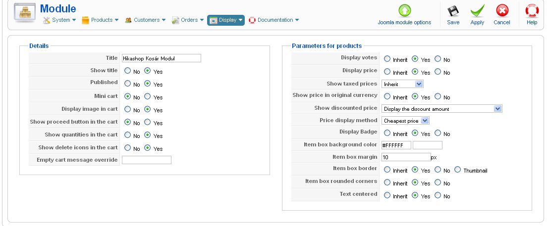

  • Posts: 12
11 years 10 months ago #179974
Sorry, I misunderstood.
I think then this is what is needed:
  • Posts: 86186
11 years 10 months ago #180066
On that page, you have the "show proceed to checkout button" option set to "no". If you want to see the "proceed to checkout" button on the cart module, you'll want to activate that option :)
