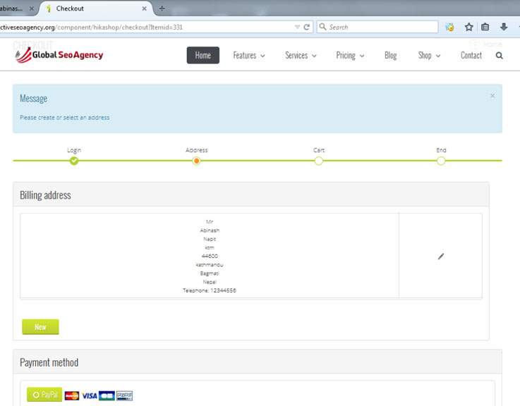

OK look at this image , I have set checkout in default setting that you have it.
1. Account Detail
2.Cart and Selection Payment option
3. Final Check out.
Now look at the picture when i finally check out then a message appears
"Message Login or create an account" But i have already filled the detail in Guest Checkout but also it come same message and checkout cannot be success.

go to this website and then have guest checkout with bank transfer or western union because paypal is not working as i have told you before but you don't respond I have done every thing that you have send me in picture file and also some time it will go to check out and finished checkout but no email will be send to client or site owner.
the is the picture of our website.

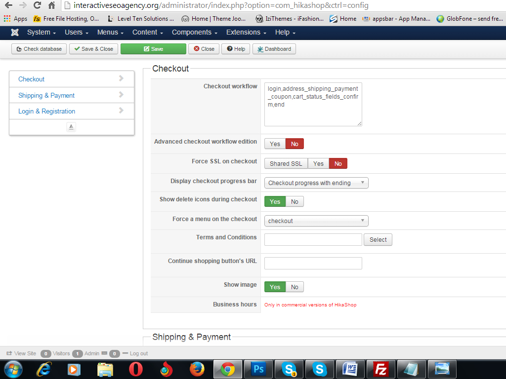

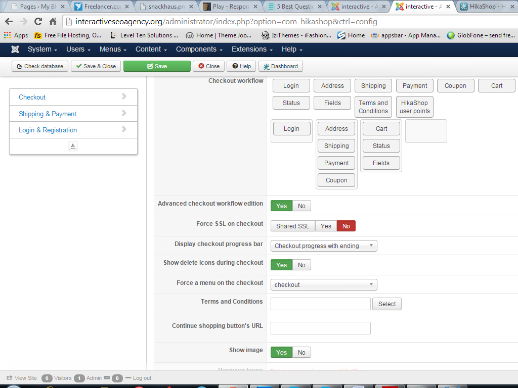

Can you set the "Advanced checkout workflow edition" option to "No" and then show me what do you have through the "Checkout workflow" option via "Hikashop->System->Configuration->Checkout" ?
I just wanted you to show me some screenshots of your "checkout workflow" via "Hikashop->System->Configuration->Checkout" when the "Advanced checkout workflow edition" option was turned off :).

11 years 9 months ago #183741
Sorry for late problem i am send you the picture of check out option please check
