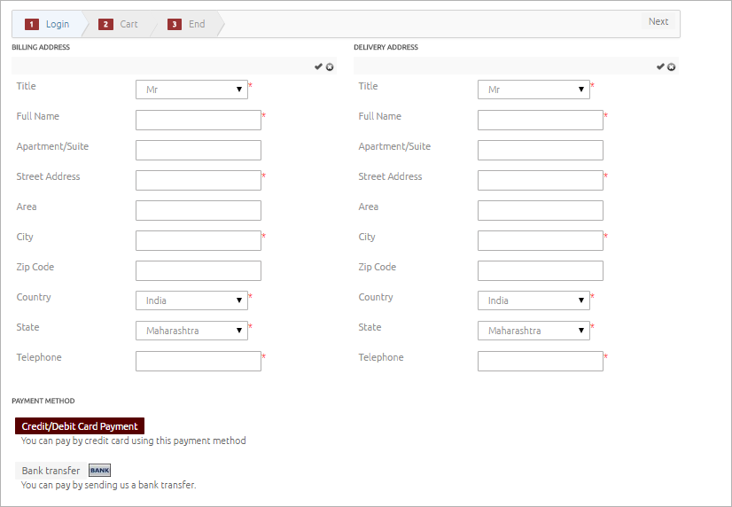

I am attaching a screenshot, rather than writing too much. I need to move the payment button position above the
Login => Cart => End.
Please let me know how to do?

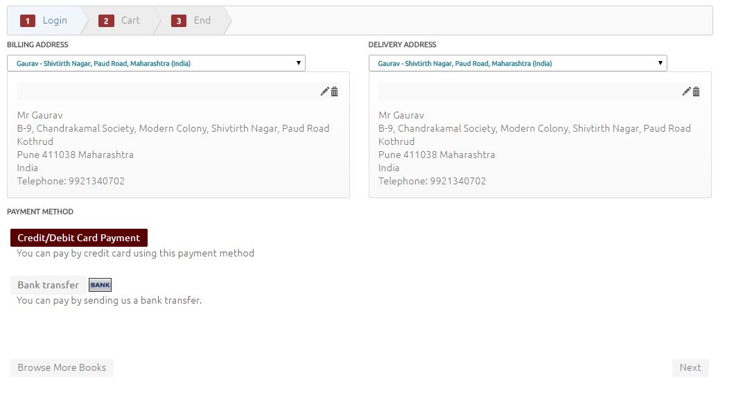

I followed above mentioned step, but still the problem remains same. The payment method still lies below the address entry section. Below is the screenshot. I want it above the line. Please guide.
  • Posts: 86187
11 years 8 months ago #184055
I thought that you wanted to have the "next" button at the top, which is what the code I gave you does.
If you want to move the payment methods selection above the address area, simply modify your checkout workflow in the configuration and drag'n'drop the payment view above the address view.
