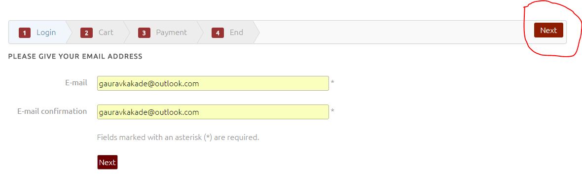

While the user is in the Checkout process. Please follow the screenshot attached. I have marked it with red. I want to remove the next button from there.
Please guide.

HikaShop has no such button at that place by default.
The next button is displayed at the end of the page normally and won't display if there is the login view displayed on the page as the login view tells it not to. But if you customized the checkout views to have the next button display before the display of the checkout views, then but the time the login view tells it not to display, the button has already been displayed. So in that case, you should add more custom code to only display the button when logged in with such code:
$user = JFactory::getUser();
if(!$user->guest){
//button display
That code supposes however that you're not using the guest checkout. For guest checkouts, the code more be a bit more complex.

I am sorry but this is guiding me to nowhere. I have enabled the guest checkout and I want to keep it as it is. I also have done nothing special to add that 'Next' button in the navigation bar (or whatever you call it).
The regular flow includes the 'Next' button below. But I don't want it to be there on the navigation bar.
i.e. in this line ................ LOGIN=>CART=>PAYMENT..................NEXT .
'NEXT' button should be removed, but just the button below the fields should be intact. I hope I am able to clarify my doubt more meaningfully.
Please tell me how to do that, the buyers started to complain about it already!!.

As I said I my first message, there is no next button by default there. So that means that you added in there yourself.
It really seems that you want to undo something that you did yourself and thus you should know better than us how to revert what you changed.
As a simple solution, delete the file templates/YOUR_TEMPLATE/html/com_hikashop/checkout/step.php and that will remove all the modifications you added to the step file of the checkout view and normally that should include the modification in order to move the next button where you added it.

Over in the other thread I linked to previously, Nicolas gave you only one piece of code for the "checkout / step" file. All you need to do is to remove exactly that code in exactly that modified file again. It's really as simple as that.
Nicolas' hint on deleting the entire modified file at the specified location is obviously helpful for testing purposes - to verify that without your modification it works. Needless to say that, as an alternative to deletion, temporarily renaming that file would do the same.
