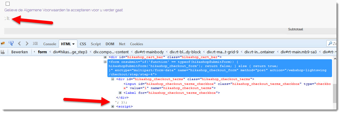

I have added the terms and conditions to the checkout workflow. When It appears I get an extra piece of code on the next line and the hyperlink of the Terms and conditions doesn't work.
The extra piece of code is this '; });
hika001 is a picture of the page. Above how it is shown and beneath the firebug data from firefox

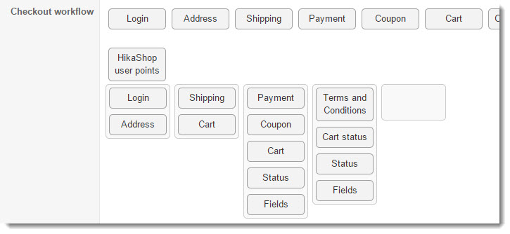

hika02 is my checkout workflow

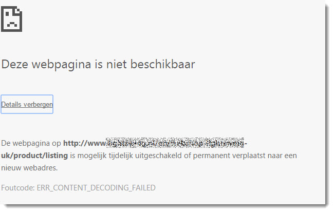

When entering this form I switched to maximum error reporting and after that my shop doesn't work anymore. When I go back to system default for error reporting the shop works again. Strange
hika003 is how the page shows after switching to maximum error reporting.

O and when I click on the link of the terms and conditions nothing happens

About your problem, I think you have a special plugin which "optimize", "minify" or do something with the javascript on the page (plugin which can be a part of your template, hard to say like that).
There is some javascript in the page in order to initialize the popup, this code is a "classical" jquery code
<script>jQuery('#modal-shop_terms_and_cond').on('show', function() {
document.getElementById('modal-shop_terms_and_cond-container').innerHTML = '<div ........... ';
</script>
There is no way that you'll only see '; });' unless something is modifying the rendering HTML.
I recommend you to check the javascript error log of your browser in order to get more details.
I also recommend you to try another popup mode in your HikaShop configuration.

When I set the popup mode to mootools instead of inherit (bootstrap), it works. The code is gone and I can click the link.
When I disable rockbooster (compression) and clear cache and set it to bootstrap the strange code is gone but when I click on the link nothing happens. So it could indead be some compression thing I guess. But what exactly is hard to say then.
I'll just use mootools for popups.
Thanks.
