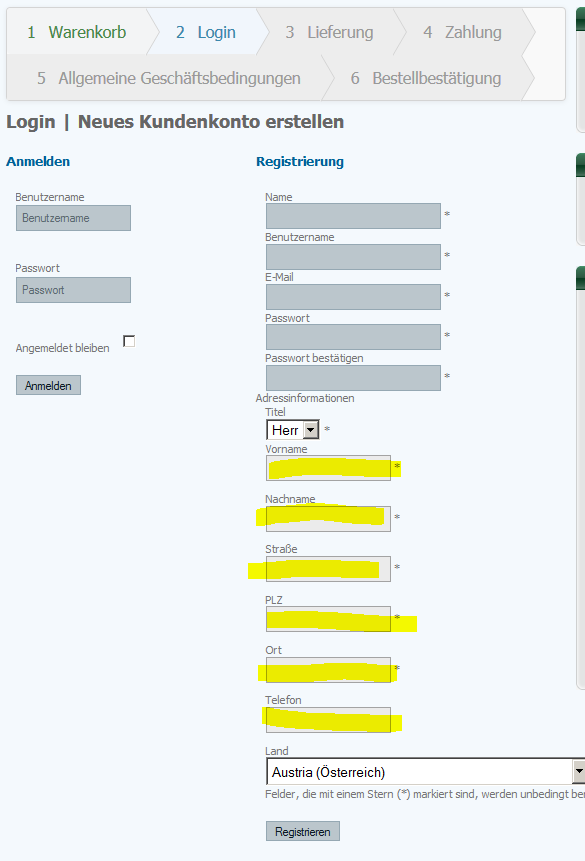

i was lloking for the reason why this fields (please look at form.PNG)
are not the same style as above, can anyone tell me why or where i can change this ?

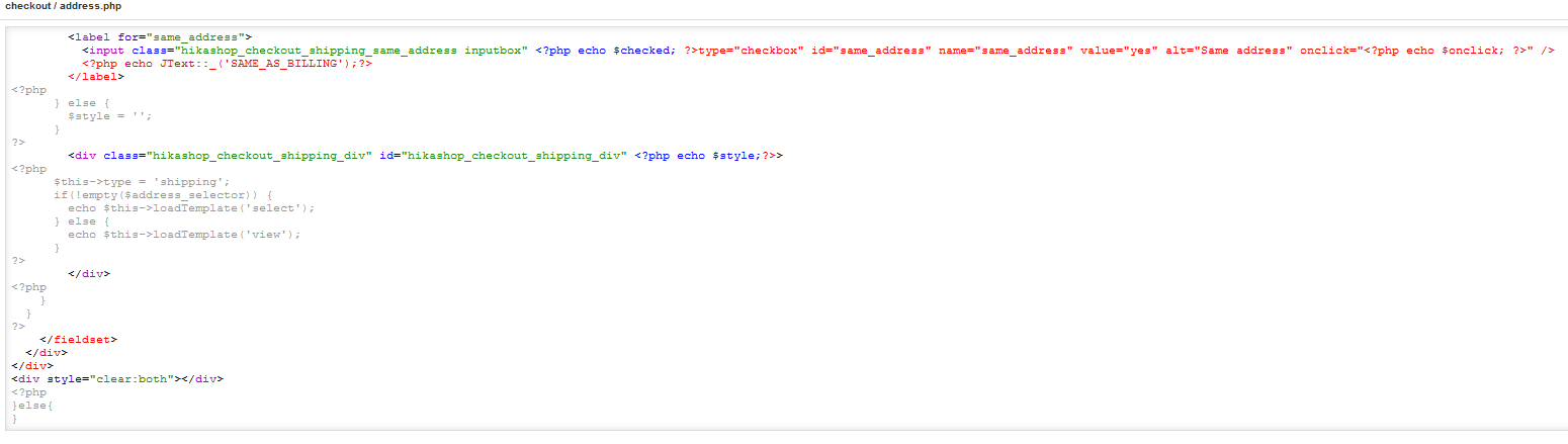

and while i was searching i fonud this part of the code, is this an error (because of the red lines)
or is this Ok ?
please help

First of all, the use of different colours in your browser console are usually used for you to easily identify different types of code. The rest depends on which browser console you're using - refer to its "user's manual". So, nope, red does not mean "error" here.
Then, there's slightly different HTML in use for the different sections of the form, which your present CSS is applying different values for - eventually coming from CSS of your template. We out here can't say more without seeing your site (link?), but you should be able to use your browser console for analysing the present CSS, too.

As already indicated, it's your template.css applying different background colours to different types of <input> tags.
For the widths, the (Joomla) form fields for the first part (username, password, etc) have size attributes set, while the (HikaShop) address form fields do not have this.
All of this can be corrected and standardised with custom CSS. I've given you already a link to the relevant part of the documentation here on the site, and since you're using Firefox anyway, I encourage you to install and use Firebug to even better see and analyse present CSS, as well as simulate CSS changes and amendments.

I couldn't find any product listing on your website so I wasn't able to access your checkout. But as lousyfool said, this comes from the CSS of your template so you should contact your template provider for help.
