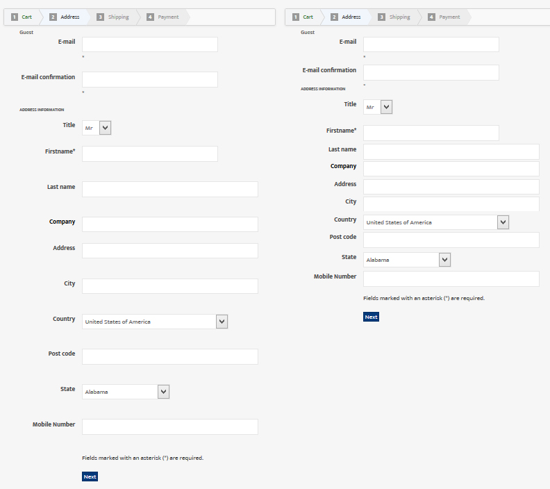

Hi - Where do i need to go to change the layout of my address fields during checkout. I've been at this for hours and hours and just can't find the right css code to do it with.
The attached file shows what it looks like on the left and I want it to look like the one on the right.
Also the asterisk. I managed to find the css for that for the contact informaiton fields and gave it a value of "hidden" but I would just rather get rid of it altogether. I could not find anything for the asterisks for the email fields above. How do I get rid of these?

It can be done with some simple CSS code that you can add in your template's main CSS file:
.hikashop_field_required {
display: none;
#hikashop_checkout_login_right_part .control-group{
margin-bottom : 0 !important;
The following user(s) said Thank You: cr2

That worked perfectly well! thank you. One more thing. What about the email section? both the asterisk and the spacing.

hi, thanks for the response. I'm actually not talking about the system emails that are being sent. I'm talking about the form that the user uses to create an account as a guest. like on the top part of the previous attachment.

You can try to use such CSS:
.hikashop_registration_email_line .controls, .hikashop_registration_email_confirm_line .controls{
color: transparent !important;
height: 30px;
.hikashop_registration_email_line .controls input, .hikashop_registration_email_confirm_line .controls input{
color: black !important;
