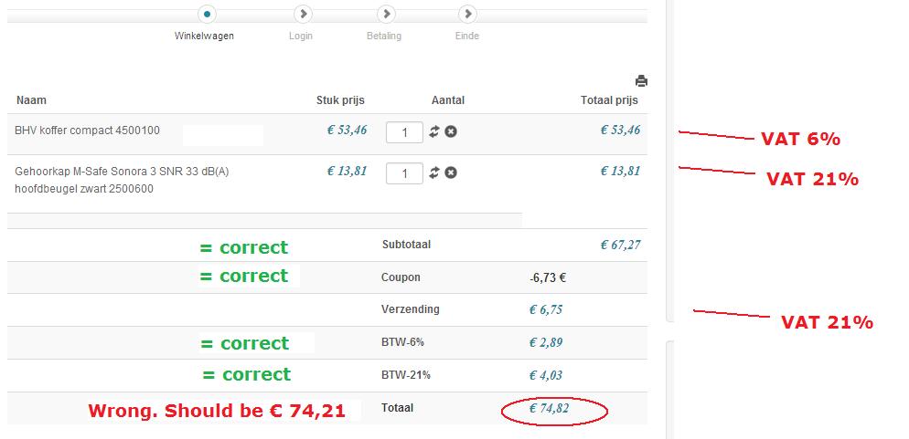

I have something strange in the checkout when using a coupon of 10% discount. I have changed several settings and checked the forum, but I do not know how this can happen. Checked with several articles, but everytime the same problem: the total is not correct.
Only in case the setting is "discount after tax" the total is correct. But in that case the coupon discount is with tax and that is not correct according the tax law.

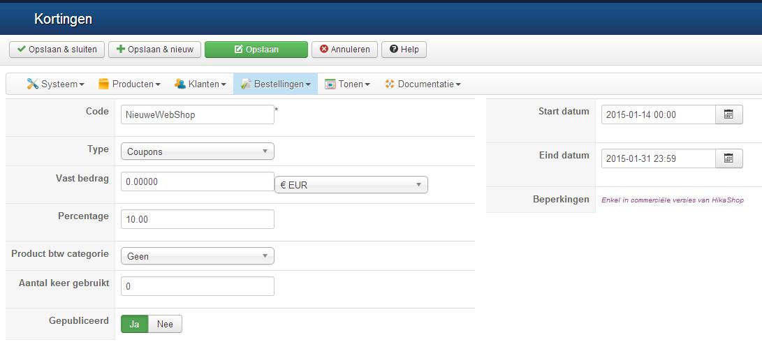

In the configuration of your coupon, you specify that the coupon has to use a product tax category (Geen).
Can you please remove that association with a tax ?

Thanks for your reply. I changed the setting of product tax category.
If setting is ...
geen (=none) --> the total is € 74,82
0% --> the total is € 74,82
6% --> the total is € 74,41
21% --> the total is € 73,41
In all cases the coupon value (€ 6,73) and VAT-6% (€ 2,89) and VAT-21% (€ 4,03) do not change (that is correct; those values are correct). Only the total changes but not to the correct value (should be € 74,21).

11 years 8 months ago #187643
Hello Jerome,

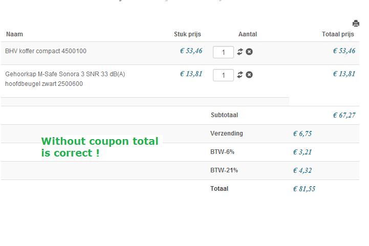

I did some tests and it seems that the wrong total is caused by the VAT over the value of the coupon discount.
See enclosed.
Any idea how to solve ??
Arno

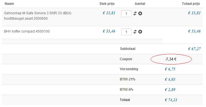

  • Posts: 16
11 years 8 months ago #187644
Here is the attachment ....

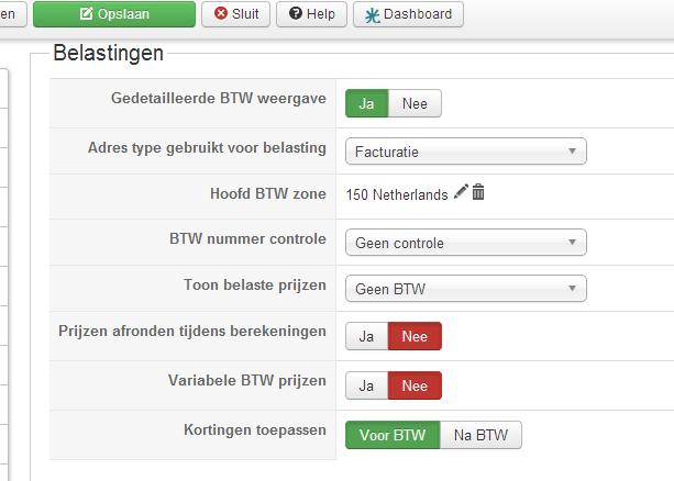

I think that you should set the "apply discount" option to "after taxes" so that the calculations works like you want.

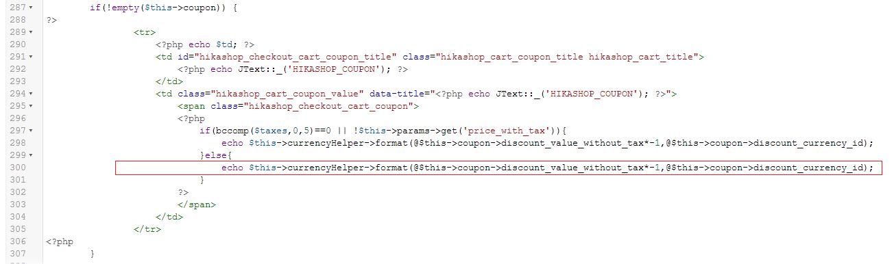

Just edit the file "cart" of the view "checkout" via the menu Display>Views and change the line:
echo $this->currencyHelper->format(@$this->coupon->discount_value*-1,@$this->coupon->discount_currency_id);
to:
echo $this->currencyHelper->format(@$this->coupon->discount_value_without_tax*-1,@$this->coupon->discount_currency_id);
  • Posts: 16
11 years 7 months ago #187875
Hi guys,

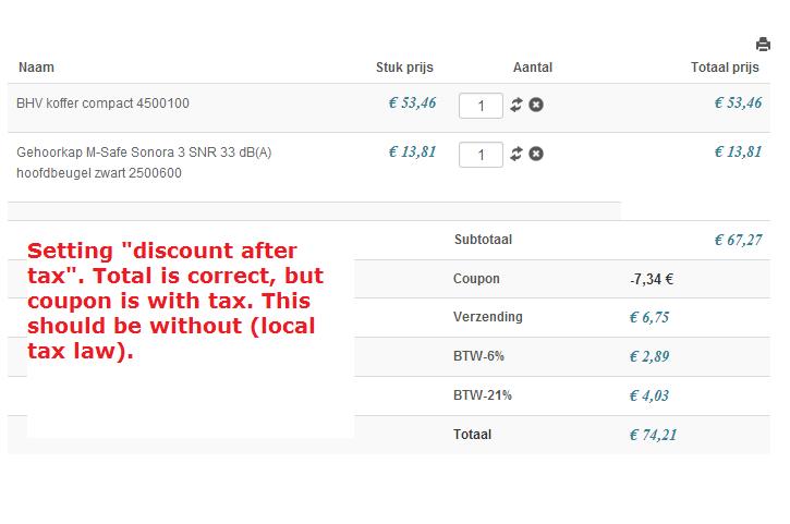

This is probably the best solution. I set the "apply discount" option to "after taxes" and I edited the file "cart" of the view "checkout".
The total is correct, but the coupon is still WITH tax (.. and I have updated the correct template).
Any idea why tax is still included in my coupon value ??
Arno

  • Posts: 26387
  • Thank you received: 4078
11 years 7 months ago #188227
Can you please put a
var_dump($this->coupon);
just after the "echo" line so we will have more details about the coupon content (and the different values of the prices)
  • Posts: 16
11 years 7 months ago #188269
See enclosed file with the data.
Kind regards,
Arno

  • Posts: 26387
11 years 7 months ago #191627
Sorry for the late reply.
I edited your message in order to be able to see correctly the var_dump.
We can see in the dump that the value of the "discount_value_without tax" is the same than the "discount_value".
So I think that the fixes for the "addCoupon" function might also fix your issue.
The best will be for the moment to test with the version provided by Nicolas:
www.hikashop.com/forum/taxes/873969-erro...html?start=20#187246
