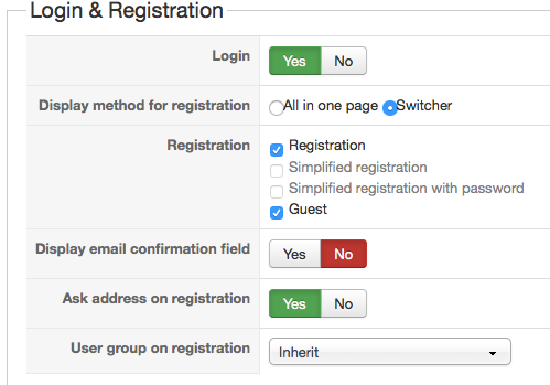

-- Joomla version -- : 3.3.6
-- PHP version -- : 5.5.17
Below is a image of my login and registration setting in the backend. I would like to change the default setting in the front end checkout to guest. I followed the directions of this post: www.hikashop.com/forum/checkout/873355-s...stration.html#181832
I changed the:
$defaultSelection = '3';
to:
$defaultSelection = '2';
The radio button default is now guest but on the right side the registration box is appearing not the guest box to match the radio button selection. How can I get this to work?

There is no option to change the default registration mode for now. That's an option that we're currently working on and that will be in the next version of HikaShop.
The modification is indeed more complex than just changing that line of code in that view. The best is to wait for next version.
