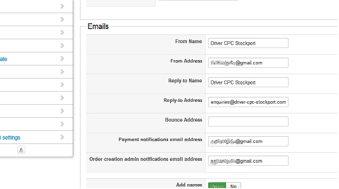

Try to change the "Payment notifications email address" and the "Order creation admin notifications email address" settings of the HikaShop configuration to a gmail address and see if it works.
  • Posts: 35
11 years 7 months ago #188163
Have changed it to my personal gmail. created an order nothing has come through still??

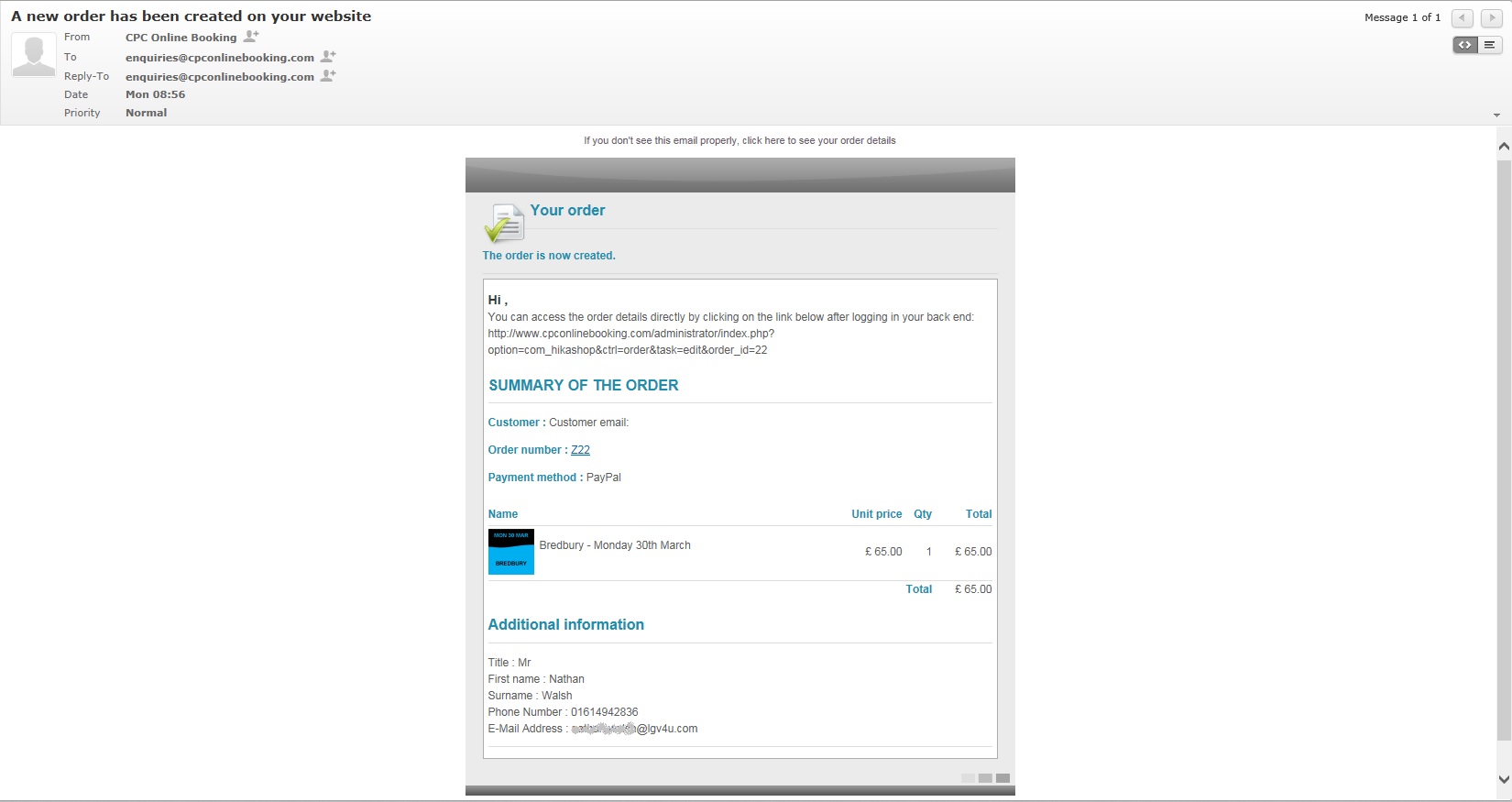

  • Posts: 35
11 years 7 months ago #188661
For Example,
This is what we still get from another site that is using an older version of Hika shop 2.3.2
This is sent straight to the enquiries@ address as you can see.
