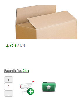

11 years 7 months ago #188341
Thanks for your help but for our case this resolution don't work.
We don't want to let the client see how many products we have in stock.
We only want that if the client try to order more that the stock the quantity value will get the stock value (it's working now) and if we decide that the package it's for example 20 units and we have 150 units we don't let to order for example 30 units.
We want that if the client try to insert 30 the system alert him that he can't order 30 units and show how many he can order, in this case he can order only multiples that 20.
For example if I try to order 30 only can order 20 or 40.
If I try 70 only can order 60 or 80.
And the auto-increment will put not (value+1) but (value+minimum)
Like here in this picture
If start with 20 and press "+" I want that the system increment something like:
20, 40, 60, 80, ...
And if the max is for example 150
20, 40, 60, 80, 100, 120, 140
