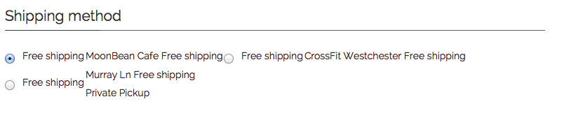

My shipping methods are drop-off sites/ pickup sites.
In the checkout screen under "Shipping method", there the price is paced in the front and end of the shipping site. It's a bit repetitive for me . Can I remove one or both price from this location.

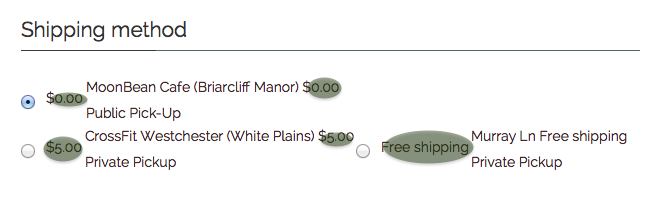

  • Posts: 12
11 years 7 months ago #189259
I highlighted the info I want removed.
I hope this helps.
Thanks you

11 years 7 months ago #189915
I've attached screen shots of the steps I took.
1) before screen shot of what I want to change
2) the file I edited
3) before shot of edited section
4) after shot of change
5) After screen shot of what was suppose to change (as you can see there was no change)
Please let me know what I did wrong.
Thank you

  • Posts: 12
11 years 7 months ago #190094
I found the problem. If I add a shipping fee, then the changes you suggested works. My issue was I had no fee and it showed "Free shipping" ("free shipping" was what i wanted to get rid off). So, I had to add a fee for it to not report it (if that makes sense).
