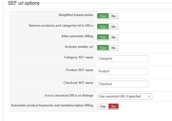

How did you configure the SEF section of the Features tab of the HikaShop configuration ? Could you do a screenshot ?

SEF url options see screenprint.

If I turn off the option 'Activate smaller url' then I don't get the 404 error but get the Categorie Listing view instead of the Checkout view ?!?
If I turn on the option 'Activate smaller url' and remove the Checkout SEF name (empty the field), the checkout view is visible : problem solved !!
Thank you for pointing me in the right direction!

Yes, I was thinking that the Checkout SEF name could be an issue :)
It's great that you found the solution yourself !
