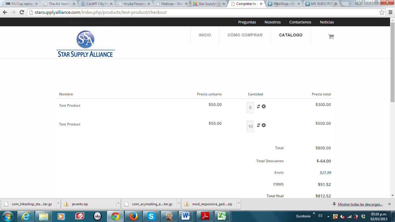

We successfully launched in Panama last year and are now expanding to the rest of Latin America.
However, as shown in the attached screen shot, the tax (ITBMS) and shipping (Entrega) are being shown for Pamama before we know where the buyer resides (these amounts are taken off) when the country is entered later in the process)
How do we stop the tax and shipping appearing before the country is entered?
Thanks,
Mike
11 years 7 months ago #189495
By default HikaShop take the "Main tax zone" option value in Configuration > Main > Taxes for the taxes calculation.
So you just have to set another main tax zone for this option to not have the taxes loaded until the customer is registered.

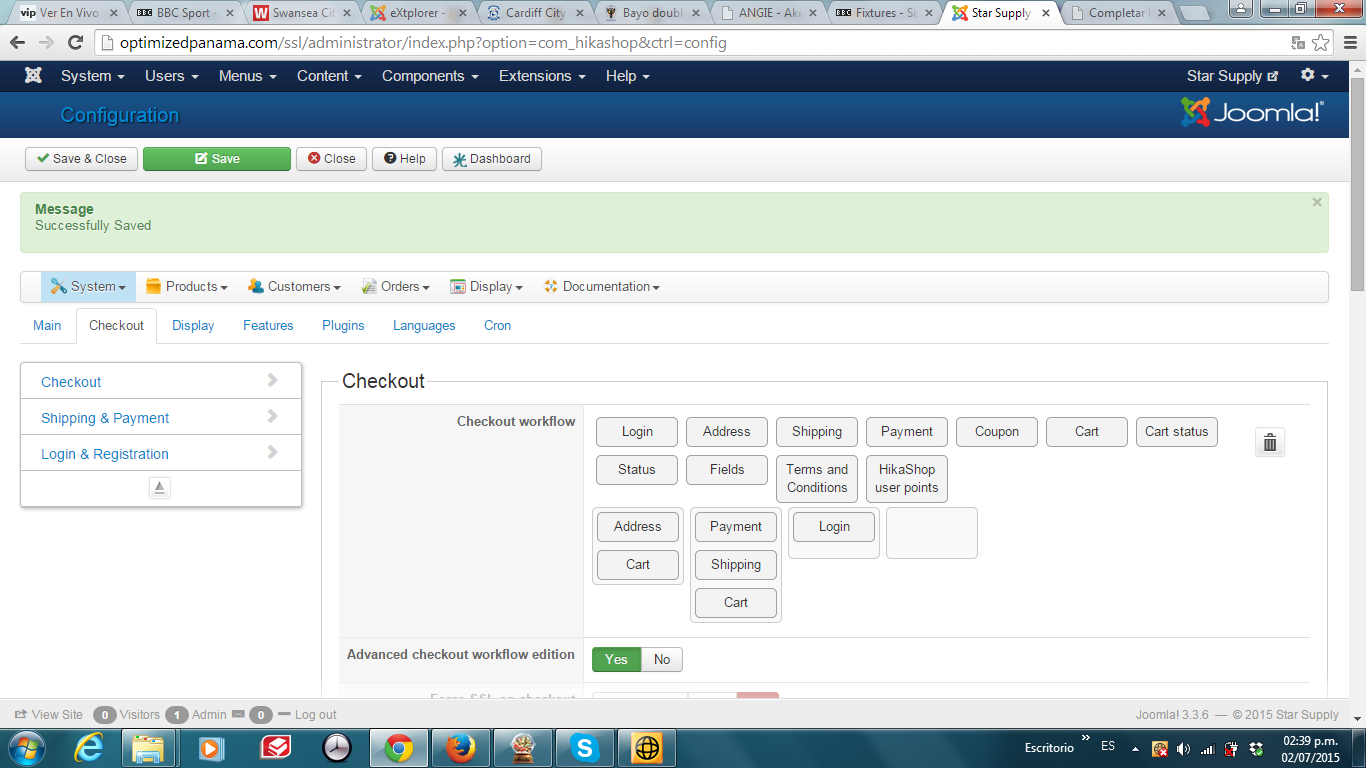

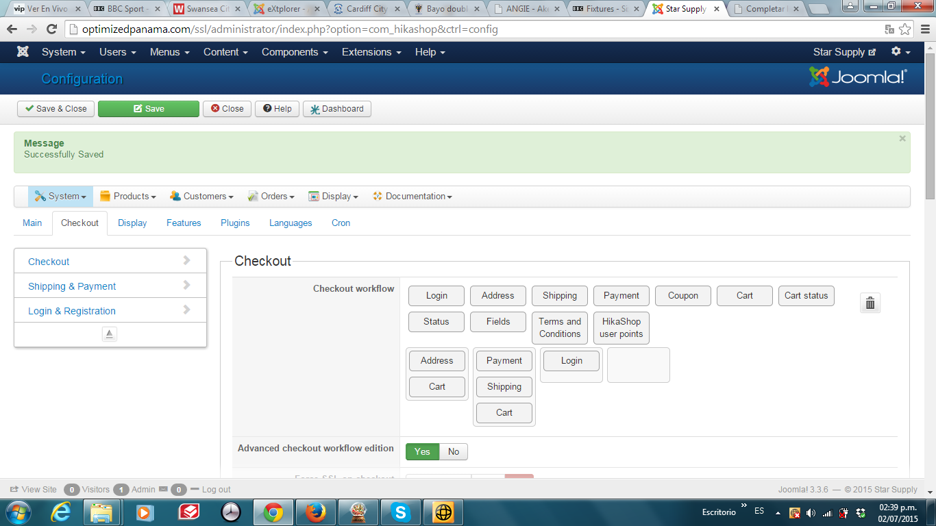

  • Posts: 122
11 years 7 months ago #189936
Thanks for the link.
I have now changed the setup to the attached but I still get a page with the Cart before I see the address step.
How can we eliminate this Cart as it is showing the default country calculations before we know the country of delivery?
Thanks,
Mike
  • Posts: 86212
  • Thank you received: 14219
11 years 7 months ago #189943
Remove the "Cart" view from below the "Address" view in that case.

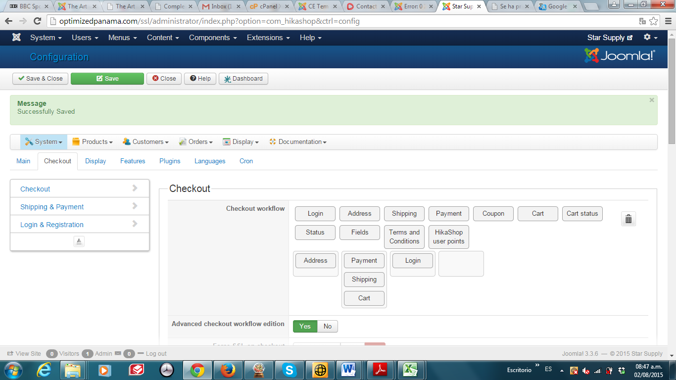

  • Posts: 122
11 years 7 months ago #189979
Hello Nicolas,
By removing cart from under address I get the error This webpage has a redirect loop and the checkout does not display.
Please see the attached screen shot for the configuration that is causing this error
Mike
  • Posts: 86212
11 years 7 months ago #189982
Move the login view in the same step as the address view.
It's not normal to have it after as you need to be logged in/registered/guest before seeing the address selection screen.
It's probably why the system is not behaving properly.
