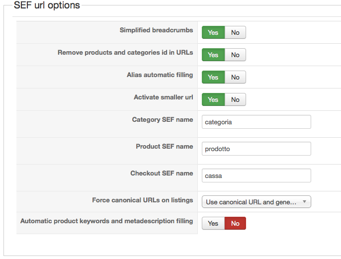

The issue is with the configuration of your SEF settings in HikaShop and the way you setup your menu items in the Joomla menus manager.
Could you do a screenshot of the SEF section of the Display tab of the HikaShop configuration ?

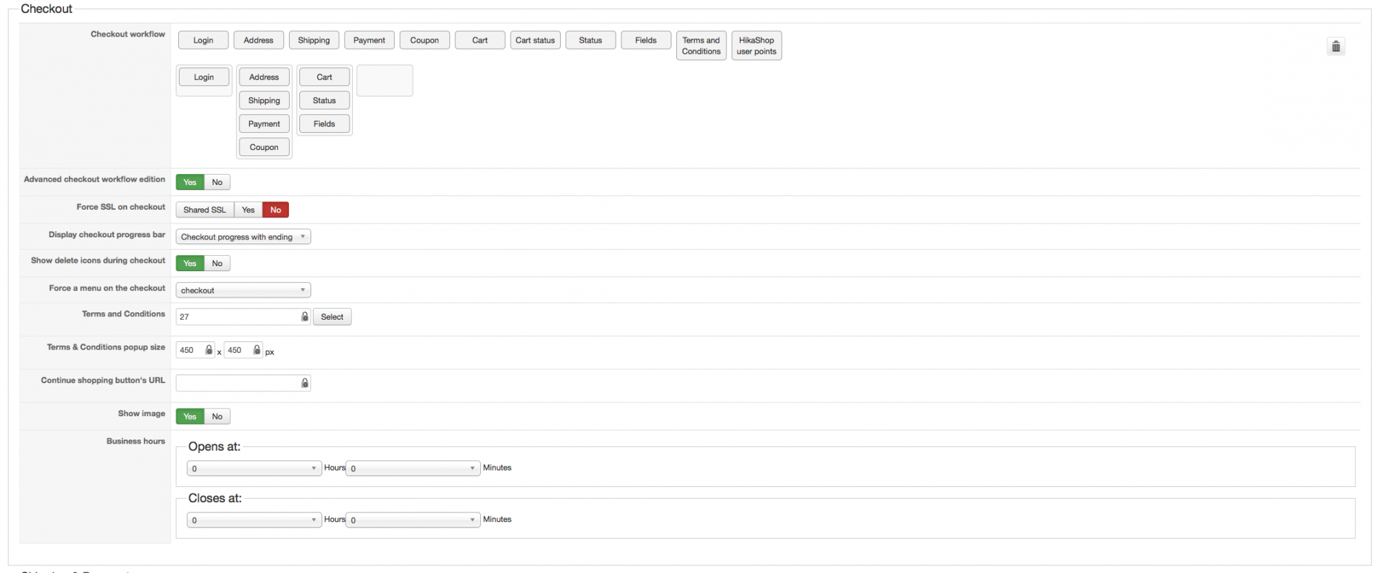

Also, did you configure the "force a menu on checkout" option of the Checkout tab of the HikaShop configuration ? If so, how did you configure the menu that you selected there ? Is it a menu item of the type "hikashop checkout" ?

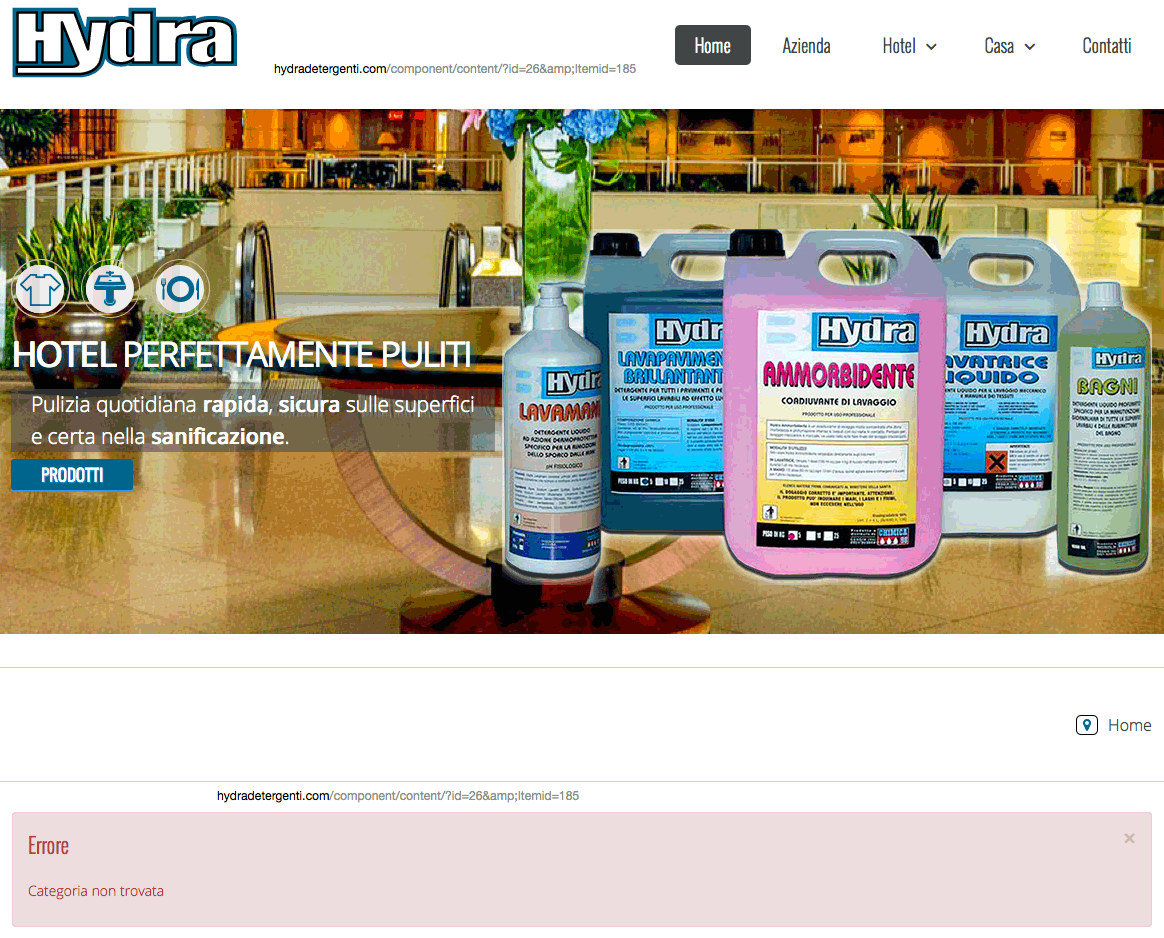

- error.png (the messag is:"error, category not found") appeared when I click checkout in the popup in product view
- sef.png settig of URL SEF
- checkout.png setting for checkout

You still have a weird redirection for the url
http://www.hydradetergenti.com/checkout/notice/cart_type-cart/tmpl-component.html
It should display the view "checkout | notice" but the link result a redirection to com_content ; HikaShop is not called even if it's an url for the "checkout" menu which is a menu pointing to HikaShop...
For what I see, it is an issue with the SEF and the router

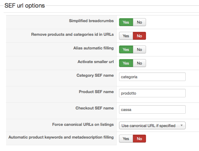

thanks for your attention. This is my sef configuration in Hika, I think everything is ok, for you?

The SEF settings of the HikaShop configuration look correct.
