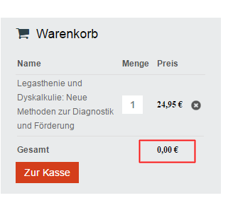

ive got following problem with the HikaShop Cart Module:
A ) Refreshing the page causes the cart Module to display 0 for total price ( Not with all products)
B ) Deleting a Product from the HikaShop Cart Module sometimes cause the Modul to display 0 for the total price ( Not with all products)
C ) Visiting another category causes the Modul to display 0 ( Not teste with se´veral products)
( Steps to reproduce the problem/s:
A ) Go to Category "Bücher" and add any Product. Refresh page by pressing F5.-> Total price 0
B ) Go to Category "Bücher" and add the first 2 products. Delete 1 in the cart module .-> Total price 0
C ) Go to Category "Bücher" and add any Product. Change to another category -> Total price 0 )

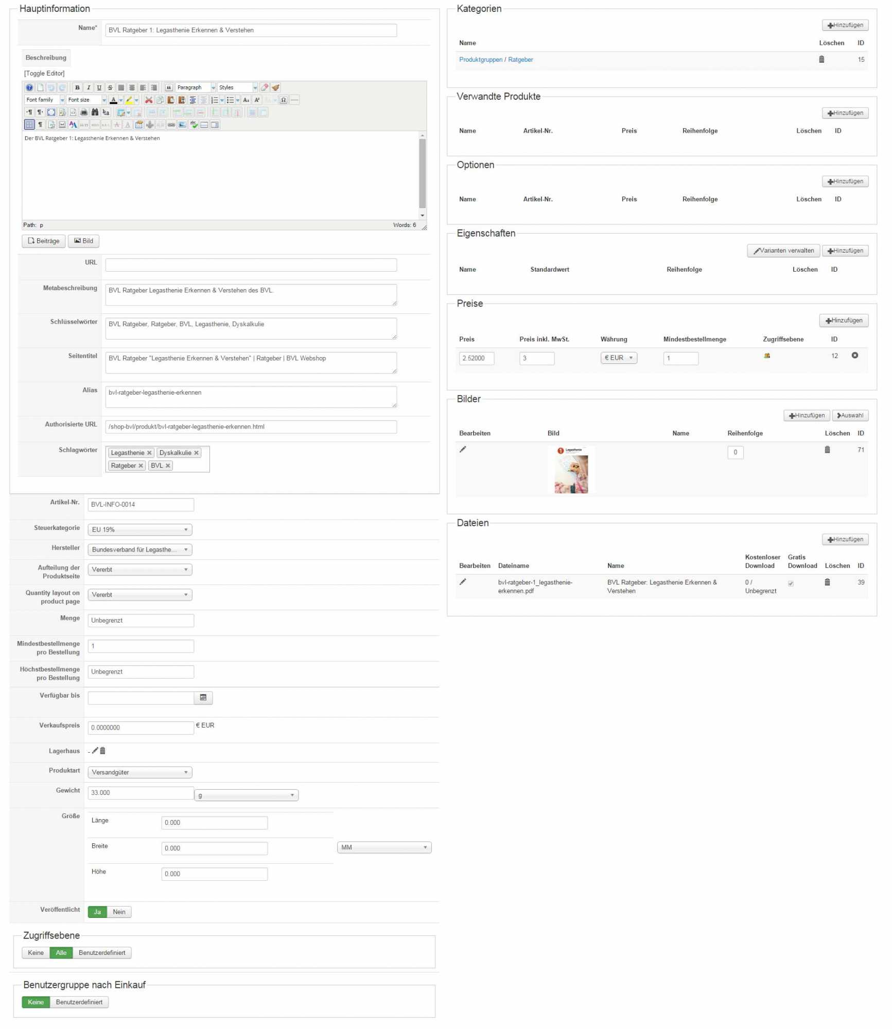

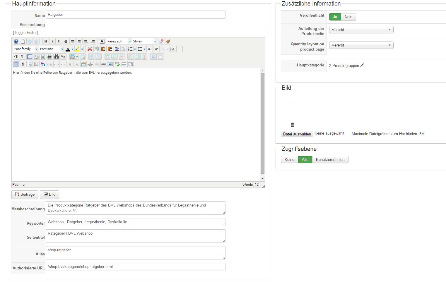

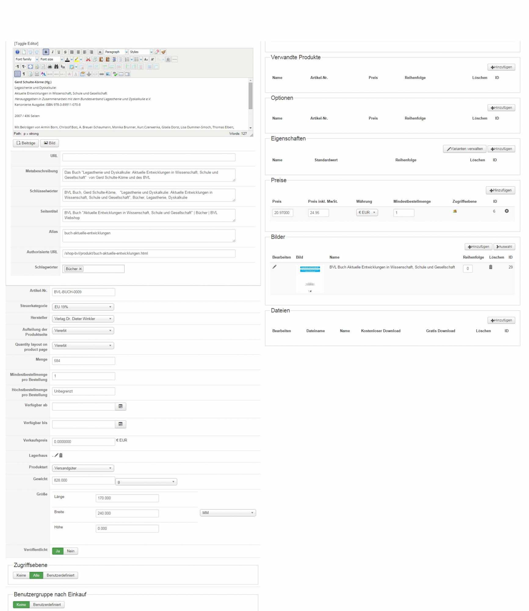

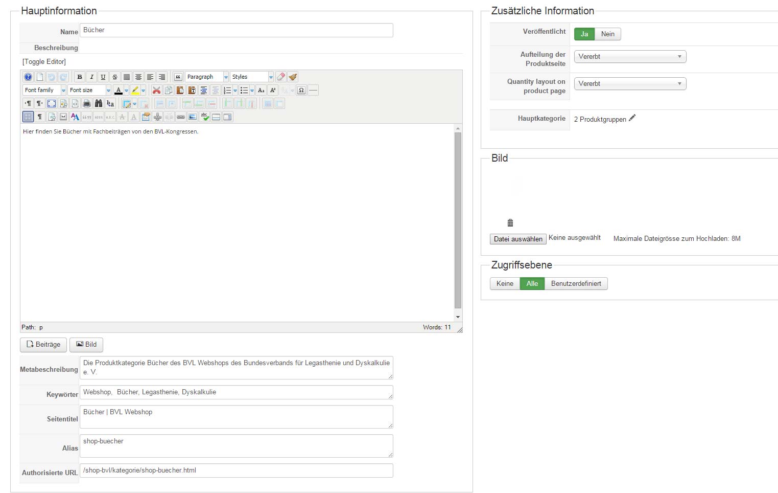

thanks for your answer. As far i know i didnt set anything special for the category "Buecher".
I attached the config for both cats and for a product inside it. I hope this helps.
