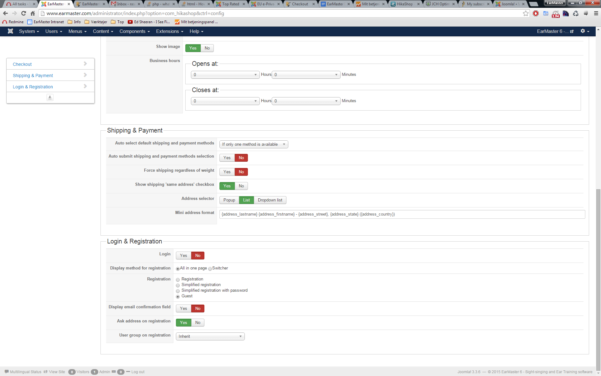

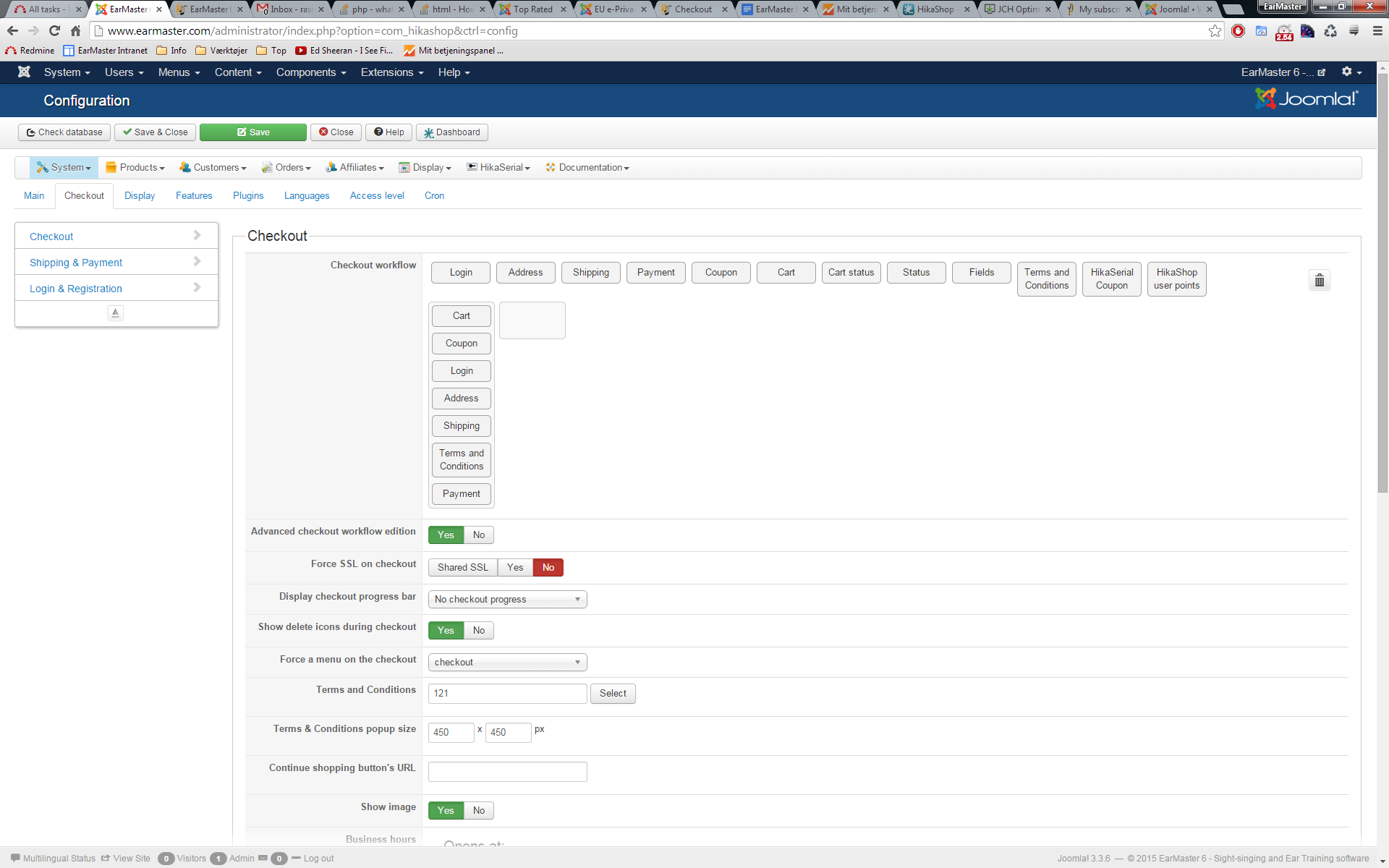

  • Posts: 135
11 years 6 months ago #191911
Hi!
Part 1 of the Checkout conf:
Part 2 of the checkout conf

  • Posts: 135
11 years 6 months ago #194961
Thanks for looking at this.
The error is happening when the "List" option is selected, which was our first choice. The current "Dropdown list" option, which is the one you found in our shop, seems to be working as intended.
We can revert it temporarily to "List" so you can have a look at the error we get. If we set it back to "List" today between 1pm and 4 pm, would that be enough for you to check it, or would you prefer a different time?

  • Posts: 135
11 years 6 months ago #195155
Hi!
We have changed the address view back to "List" so that you can reproduce the problem (We won't change it back before hearing from you).
After doing some further testing we have also found out that the problem happens in Internet explorer 11 and on a Ipad's safari, no matter what option we select in the backend
