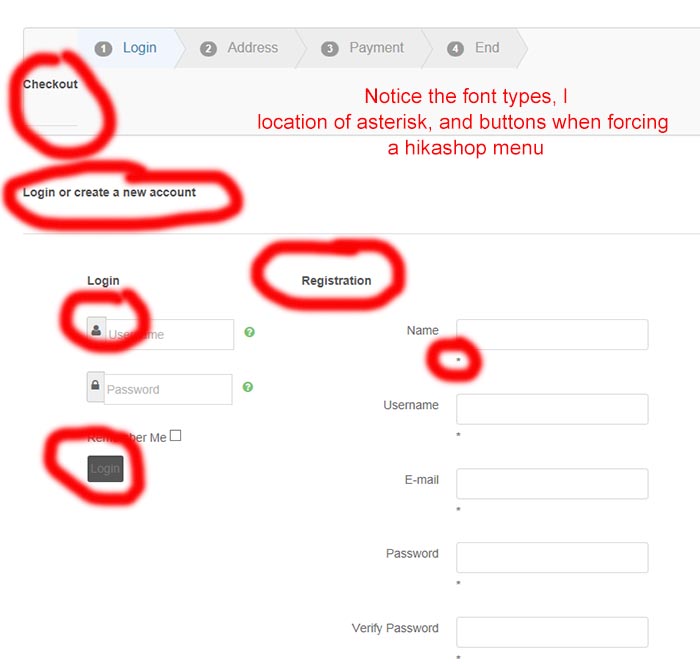

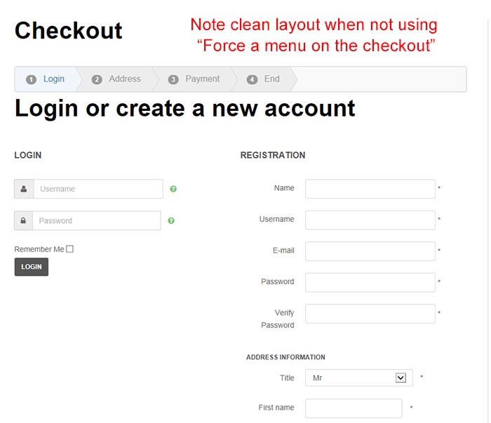

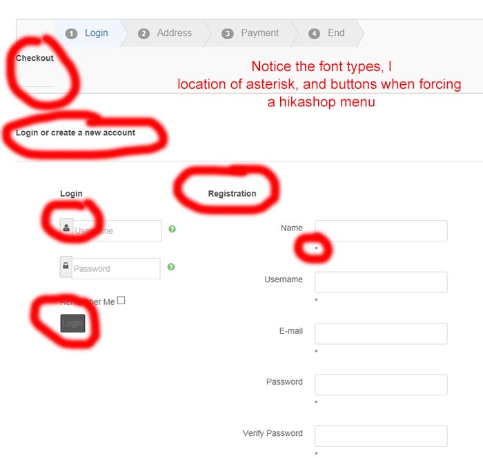

We lost the page layout, typology, and button formatting when we created a checkout Hikamenu menu item and Forced the menu on the checkout.
I have tried all the options in Display > CSS for the Front-end CSS File (old, default, & none) but none of them match the clean layout that is displayed when we don't use the "Force a menu on the checkout."
Does anyone have a solution such as a suffix class or something?

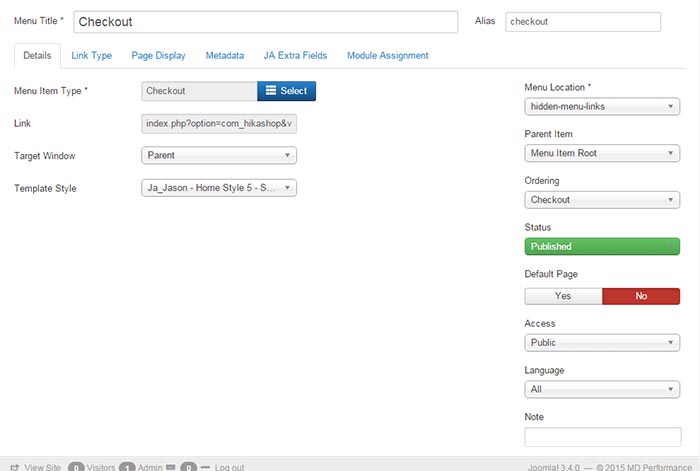

Attached is the menu item-detail. Do you need more detail? if so what sort of detail do you need?

11 years 5 months ago #192280
Okay, I have set the "Force a menu on the checkout" to None. So the checkout looks the way we want it, but all 41 products are displayed below the checkout. This is the issue are tying to fix by "Forcing the menu".

  • Posts: 85952
  • Thank you received: 14142
11 years 5 months ago #192315
Using the force a menu on the checkout is indeed a good way to configure what modules to display or not on the product page.
So you'll want to use it.
The issue you have with it is that you configured the menu item that you selected in that option with another template or some specific template options leading to that issue with the styling.
