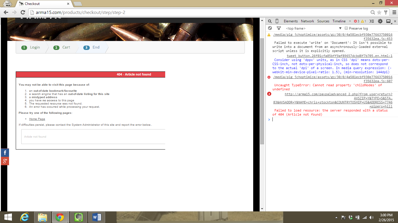

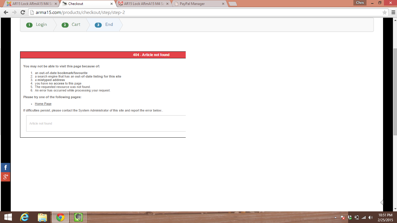

After_End must be messed up as i got an error mess
  • Posts: 92
11 years 6 months ago #192169
-- url of the page with the problem -- : arma15.com/products/checkout/step/step-2
-- Joomla version -- : 3.4.0
-- Error-message(debug-mod must be tuned on) -- :
(function() {
var _fbq = window._fbq || (window._fbq = []);
if (!_fbq.loaded) {
var fbds = document.createElement('script');
fbds.async = true;
fbds.src = '//connect.facebook.net/en_US/fbds.js';
var s = document.getElementsByTagName('script')[0];
s.parentNode.insertBefore(fbds, s);
_fbq.loaded = true;
window._fbq = window._fbq || [];
window._fbq.push();
enqueueMessage( JText::_('THANK_YOU_FOR_PURCHASE') );
After_End plugin must be messed up.
I added a FB script to this to help track conversions sales. My only thought is that some how I must have put the script in the wrong place? The first Screen Shot is of the error I got and it didnt send me to thank you page.
The transaction works and charges the customer it just does not give them a "thank you" page as configured in the after_end.

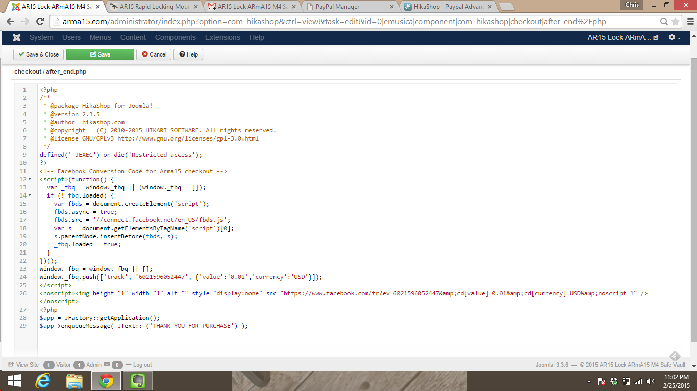

I also took a screen shot of my after end hopefully we can find the error. Here it is:
<?php
* @package HikaShop for Joomla!
* @version 2.3.5
* @author hikashop.com
* @copyright (C) 2010-2015 HIKARI SOFTWARE. All rights reserved.
* @license GNU/GPLv3 www.gnu.org/licenses/gpl-3.0.html
<!-- Facebook Conversion Code for Arma15 checkout -->
<script>(function() {
if (!_fbq.loaded) {
fbds.async = true;
_fbq.loaded = true;
window._fbq.push();
</script>
<noscript><img height="1" width="1" alt="" style="display:none" src=" www.facebook.com/tr?ev=6021596052447&cd [value]=0.01&cd[currency]=USD&noscript=1" /></noscript>
<?php
$app->enqueueMessage( JText::_('THANK_YOU_FOR_PURCHASE') );
11 years 6 months ago #192186
If you remove the script, do you have the 404 error ?
Please try to put the code after the thank you message code.
Could you check if there is no Javascript error present on the page ?
  • Posts: 92
11 years 6 months ago #192293
I put the facebook code after as you said. Still getting the error. I turned the Java Script tool on and took a screen shot.

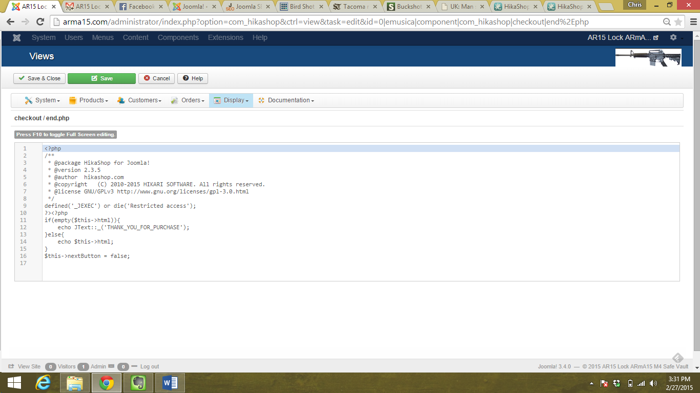

  • Posts: 86112
  • Thank you received: 14209
11 years 6 months ago #192309
I don't think that it comes from the after_end view file and the code you posted looks good.
Your error either comes from the customization of the "end" view file or the end files of the payment plugin you're using.
  • Posts: 92
11 years 6 months ago #192465
I am not sure the "End" code is messed up as it hasnt been edited in anyway. I took a screen shot of it anyway.
As far as the plugin I took a screen shot of the settings. The only thing I can think is the redirect url is blank but I figured that is only if you want to add a custom redirect url. I took a screen shot of the plug in settings. The DEBUG was turned on could this have affected anything? I turned it off since it doesnt appear to be providing any extra info.

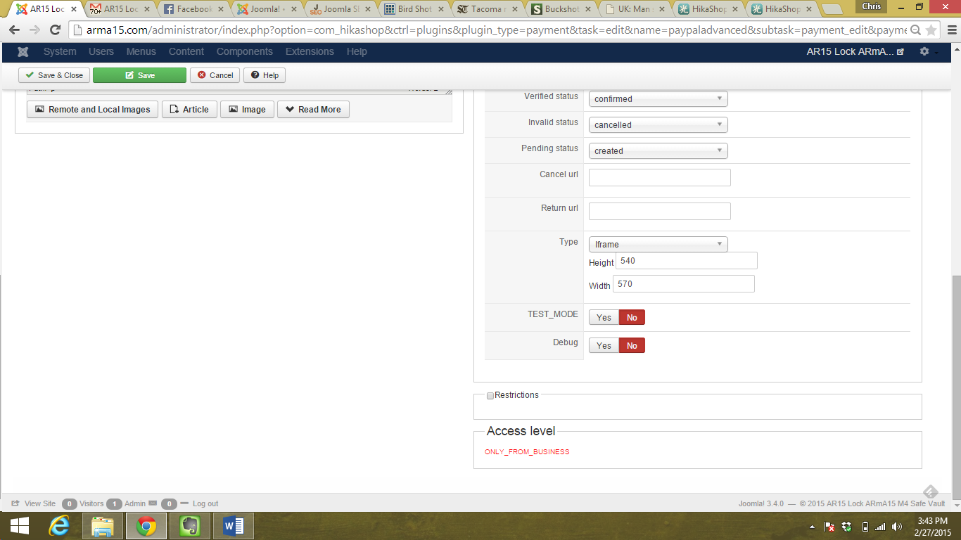

  • Posts: 86112
11 years 6 months ago #192532
I've checked your website and I think that it comes from the settings of your PayPal advanced payment method.
Can you check that the URL you entered in the "return URL" parameter there is valid ?
What if you change the "type" option ? Does it help ?
  • Posts: 92
11 years 6 months ago #192593
I changed the type to form and if you look at the return url it is blank. Should there be something in the return url? Please see screen shot above. I am not sure if the return url has to have something in it or not?
Changed the form "type" back to iframe as it redirected the user to a paypal site which defeats the purpose of that plugin as I want the customer to do it all on my site.
Last edit: 11 years 6 months ago by target4fun.
