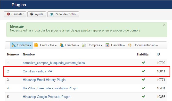

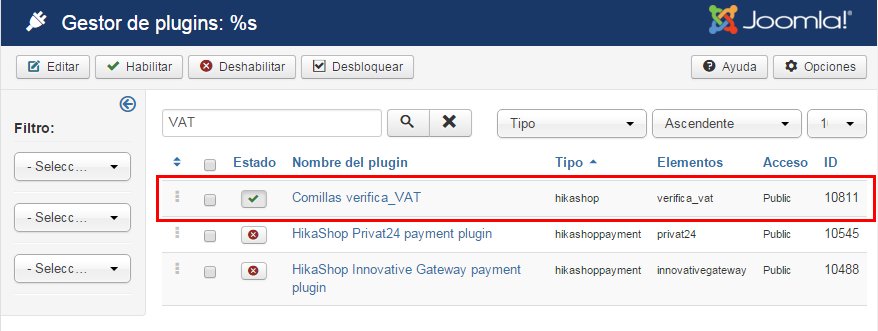

  • Posts: 79
11 years 6 months ago #193828
Hi Nicholas.
I had create my own plugin, I instaled it without errors, and I published it.
When I select HikaShop -> System ->Plugins->New. I can see it in the list (plugin-list.jpg). When I click on it, Joomla opens it in Joomla Plugin Manager (plugin_Manager.jpg). I saved it, and it appears enabled at Joomla Plugin Manager list (plugin_Man_list.jpg) but not at HickaShop System->plugin list.
The only thing I need to know is how can I invoke it? (I also attached php code and plugin xml.), because, I understood, when you install and publish a pluging, this plugin overrides every helper function you use into plugin.
Please, correct me if I'm wrong.

  • Posts: 86214
  • Thank you received: 14221
11 years 6 months ago #193984
You need to deactivate the option "VAT number check" of the HikaShop configuration so that the VAT check is not done anymore by HikaShop.
Then, your plugin will be called automatically just before the address is saved and you'll be able to do the checks you want etc in your plugin.
I checked its code and it looks good. You should definitely get it called in the onBeforeAddressCreate function if you activated the plugin via the Joomla plugins manager.

I look for my plugin in Joomla plugin manager and it is active, but in Hikashop Configuration->Plugins there are no plugins include if I create a new one, edit it and save it like Hikashop message said.

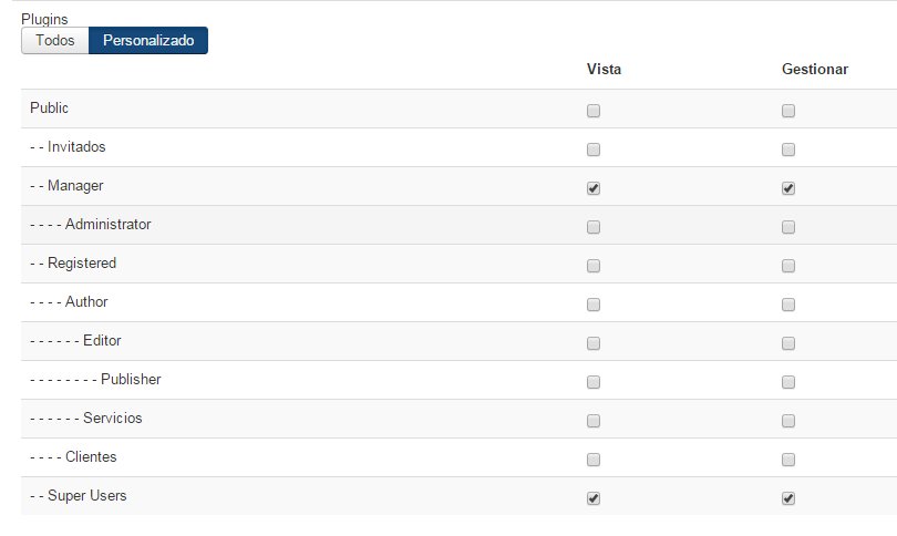

My plugin does not work either in the backend. Maybe this can be influenced by the selections in System-> Configuration-> ACL? (I attach my "Plugins" ACL configuration)
Anyway, my plugin should be displayed in System->Plugins list?. Because there is no plugins also if I add new one via "New" button.

No, you don't need to see it in System>Plugins.
But you need to enable it in the Joomla plugins manager.
Could you provide a copy of the plugin ? It would be easier to tell you what's wrong with it.
  • Posts: 79
10 years 6 months ago #232101

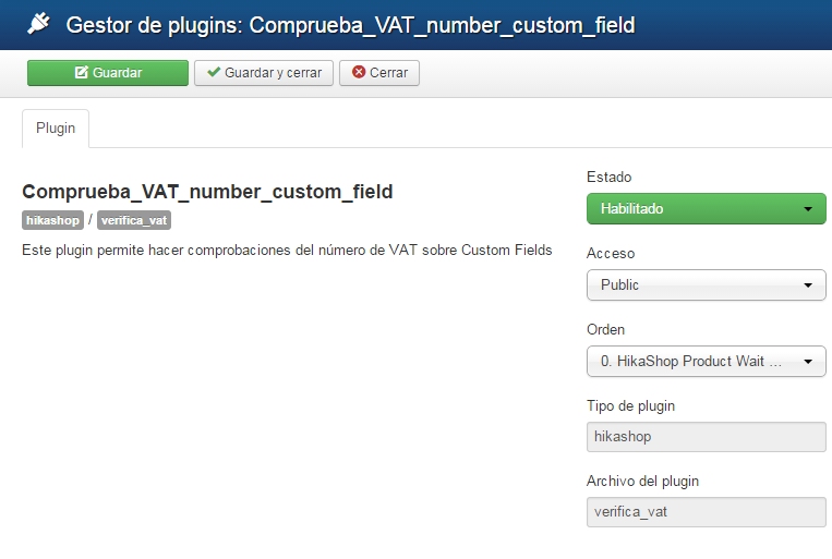

The plugin is enable, as you can see in attached file "hika_plug.jpg" and "joomla_plug.jpg", when I click in "New" button at System->Plugins it appear enabled. In addition I have reinstalled and enabled it in joomla plugin manager and refresh joomla cache in joomla extension manager and still don't work in fronten, neither the backend.
