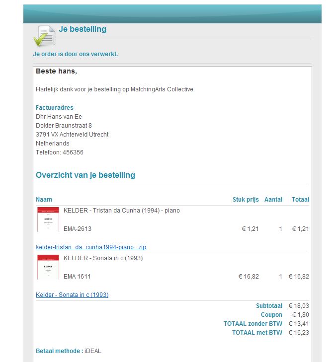

Right from the beginning, even before I made a change* in the email, my product thumbnails are cut off at the bottom (see attachment).
Hopefully you know why. Second question when looking at the code beneath: is there a variable for knowing the product is virtual? Thanks in advance. Kind regards, Hans

11 years 6 months ago #193126
You issue seems to be some css, you can potentially add css rules in order to increase the height of the table lines.
To know if a product is a virtual one, you have to check its weight, if equal to 0, so virtual, else shippable.
The weight can be displayed thanks to {LINEVAR:product.product_weight}
  • Posts: 56
11 years 6 months ago #193214
Merci Xavier,
Maybe it's because I did not do the right thing, but adding css didn't solve my problem. This is what I changed (I added line-height:28px):
<td style="border-bottom:1px solid #ddd;padding-bottom:3px;line-height:28px;">
{LINEVAR:PRODUCT_IMG}
{LINEVAR:PRODUCT_NAME}<!--{IF:ORDER_PRODUCT_CODE}--> {LINEVAR:PRODUCT_CODE}<!--{ENDIF:ORDER_PRODUCT_CODE}-->{LINEVAR:PRODUCT_DETAILS}{LINEVAR:PRODUCT_DOWNLOAD}
</td>
Please have a look at the attached file to see the result. Perhaps you can point out exactly where I have to modify.
Thanks in advance.
Kind regards, Hans

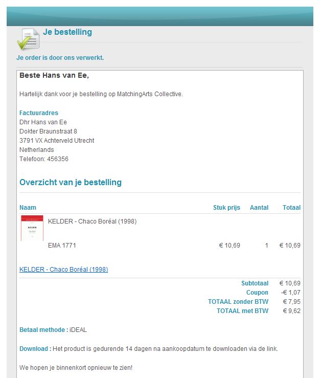

  • Posts: 56
11 years 6 months ago #193562
You are completely right. Of course you can't know how the original thumbnail looks like.
Please see attachment. The border line is missing.
Kind regards, Hans
  • Posts: 86212
  • Thank you received: 14219
11 years 6 months ago #193575
It's better but it's not enough. We need to look at the CSS/HTML of the email itself not only see the image and the issue in order to analyze the situation.
Could you forward the email to contact AT hikashop DOT com along with a link to this thread so that we can do that ?

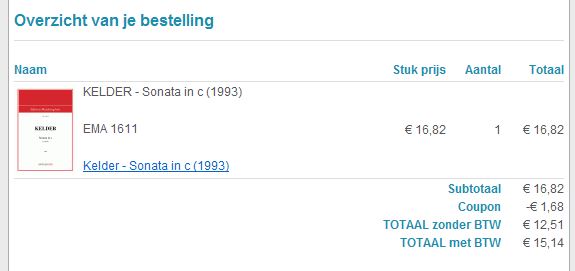

  • Posts: 86212
11 years 6 months ago #193628
I've check the image, both the thumbnail and the original and the border issue comes from the thumbnail generation process, not the CSS or HTML of the email.
The issue with image scale down processes is that they don't handle well stripes. If you have stripes or 1 pixels like that:
on an image and that you resize it to be half as high, you'll either get only black, or only white and no stripes anymore.
That's the same process you're experiencing here.
The solution is either to have bigger thumbnails or to modify the original image to reduce the "stripe" effect by having a thicker border.
When you edit your emails via the menu System>Emails, you have a preload area where you'll find that line of code:
$img = $imageHelper->getThumbnail($item->images[0]->file_path, array(50, 50), array('forcesize' => true, 'scale' => 'outside'));
There, the 50,50 defines the size of the thumbnails in the email. If you increase them, you'll be able to have bigger thumbnails, which hopefully will avoid the problem. So try several values there until you have the border displayed.

  • Posts: 56
11 years 6 months ago #193719
Xavier, you solved it! :) Hans is happy! Please see attachment. Thanks again!
