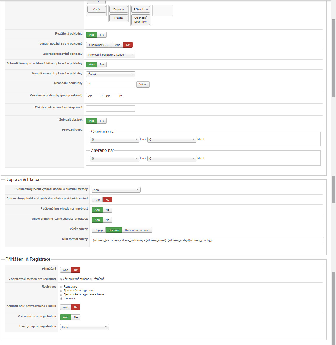

1. Either add the cart view on that step in your checkout workflow or turn off the "auto submit shipping and payment methods selection" option of the HikaShop configuration.
2. How did you configure your checkout settings ? Can you do a screenshot of that tab of the HikaShop configuration ?

1. I just tested it on you website, and your payment/shipping methods seemed to be correctly configured, can you test it again by choosing different Payment / Shipping methods than the default one, and check if you have the good methods on your order configuration page via "Hikashop->Orders->'Your Order'" ?
2.
Regarding your checkout workflow, can you change your back-end language to "English" and send another screenshot of your checkout configuration ?
Thanks.

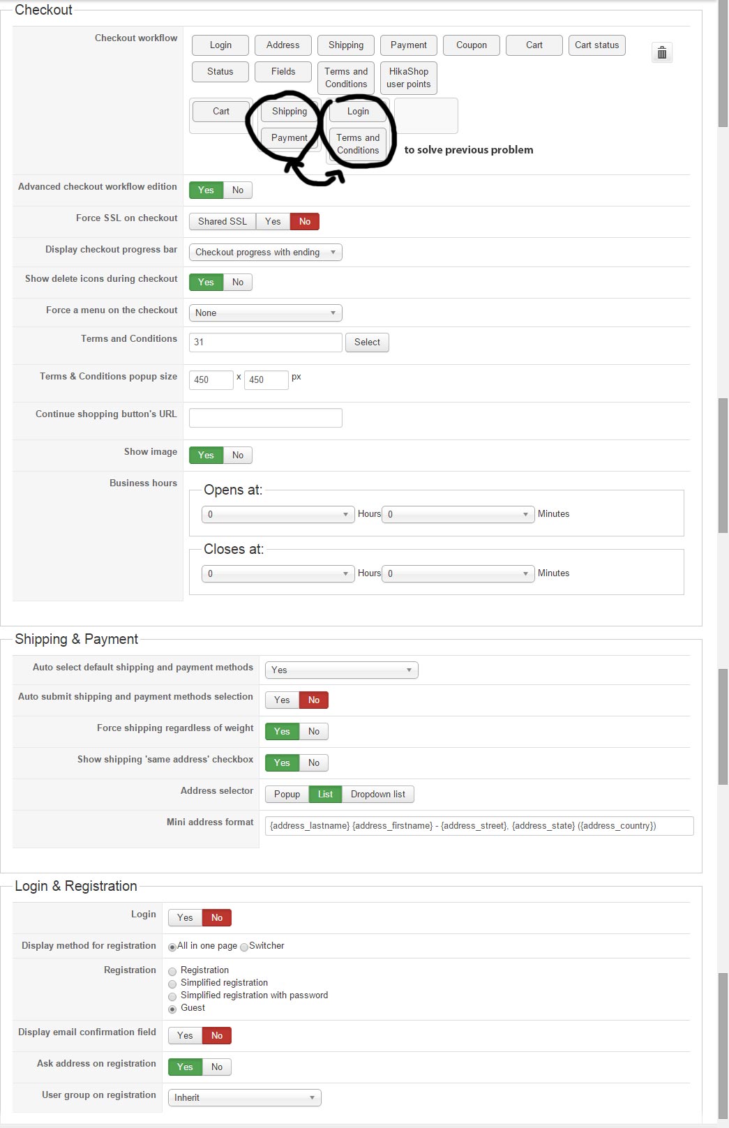

1. I have found source of problem - it was connected with my second issue
logining in at guess checkout reseted shipping and payment methods to default.
So I just swaped those two steps and it solves both two problems
So now its almost ok, but if I set another shipping/payment method than is default and click on this step on button "finish", its just refresh the page (probably save methods change) and I must click "finish" button again to finish order.

Change "Auto submit shipping and payment methods selection"(czech translation on this one is misleading) to Yes for better experience.
As payment method depends on shipping method(you can set payment method only to selected shipping methods), page has to be submitted after change of shipping method to show only allowed payment methods.
With "Auto submit shipping and payment methods selection" set to Yes, page is submitted automatically after change of shipping method without need to click Finish button twice.

When I place SHIPPING AND PAYMENT after CART in checkout, it is ok, otherwise, the problem occures.
  • Posts: 86103
  • Thank you received: 14203
10 years 11 months ago #215121
It's normal that the system moves you to the next step with the auto select and auto submit settings turned on in such case.
Add the cart view to the same step and it shouldn't do that anymore.
