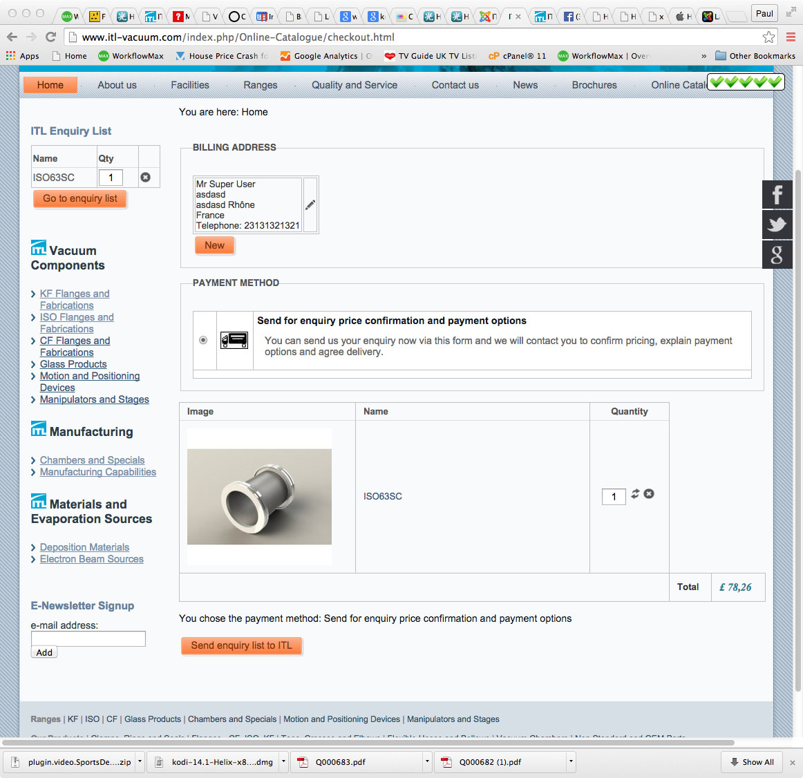

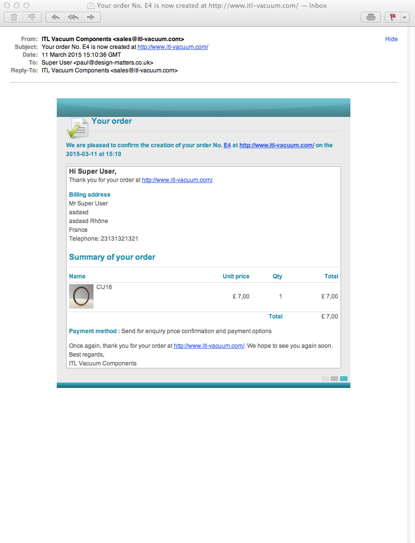

On the checkout and the order confirmation email - how can I remove the total cost field?
11 years 6 months ago #194349
For the checkout, you have to edit the view "checkout / cart" and then in the footer part of the table remove the code displaying the total.
Regarding the email, you have to edit the "order_creation_notification" and the "order_status_notification" one, via the menu System > Emails and remove the code:
<!--{START:ORDER_FOOTER}-->
	<tr>
		<td colspan="3" style="text-align:right;color:#1c8faf !important;font-size:12px;font-weight:bold;">{LINEVAR:NAME}</td>
		<td style="text-align:right">{LINEVAR:VALUE}</td>
	</tr>
<!--{END:ORDER_FOOTER}-->

I tried this and I cant find the code in the checkout/cart - i found the code in the emails and removed it but it has not worked.

The code that Xavier gave you is for the email, not for the view.
For the view, you should remove the line in the footer which display the total ; you can find the line thanks to the label "HIKASHOP_TOTAL".
For the email, are you sure you tested the order creation email ? Because HikaShop have other emails it can send to the customer, like the "order status notification" or "order notification".
