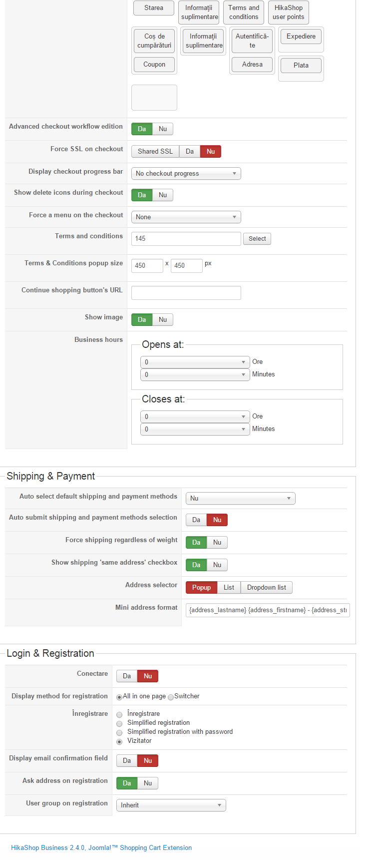

Can you provide a screenshot of the Checkout tab of the HikaShop configuration ?

Sorry for delay. I uploaded a screen capture with the settings. However, I would say that the inconsistence between the two checkout stages, shipping and payment, is the one wich should be adressed, and not to do some tricks with the settings.
