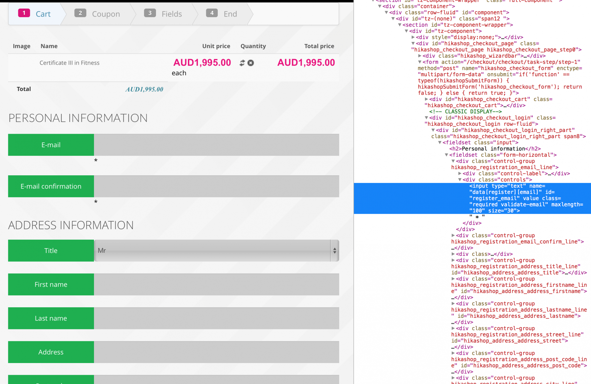

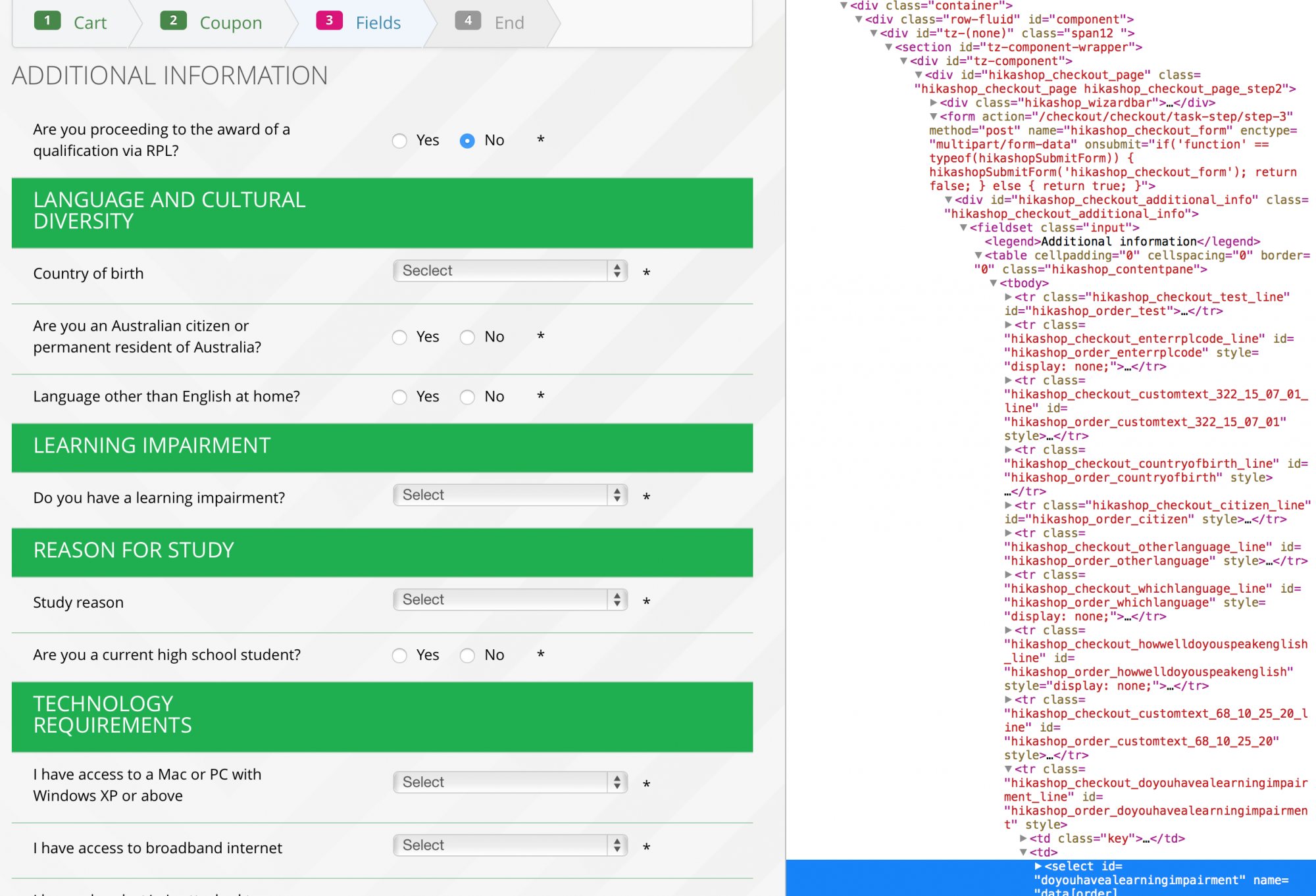

  • Posts: 11
11 years 6 months ago #194978
i'm using hockshop for business version 2.3.4
on the checkout process i have settings to enable bootstrap, on the login, register part of the checkout process the code when boot strap enabled used DIV's, but when it gets to the custom fields, the forms uses Tables to structure the form, which is non bootstrap friendly.
bootstrap
non bootstrap

11 years 6 months ago #195011
You will find the view "checkout | fields" and "checkout | custom_fields" which display the custom fields in the checkout.
Thanks for the "user | registration" and "user | custom_fields / custom_fields_bootstrap" you will have some samples to see how manage the bootstrap and non-bootstrap design.
The checkout is currently in re-factoring, we are re-designing a lot of the checkout views for a future big release.
