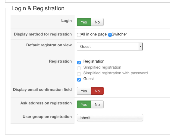

I have set the Default registration view in the configuration to guest (see attachment), yet when I go to checkout the default is still Login. I have tried three different templates, including the Protostar and get the same results.Am I missing something?
11 years 6 months ago #194929
I tried to reproduce the issue on my end thanks to your screenshot.
But using the same parameters than yours is working fine, I have the guest form displayed by default.
Don't you have any view edition/override of the view "checkout / login" ?

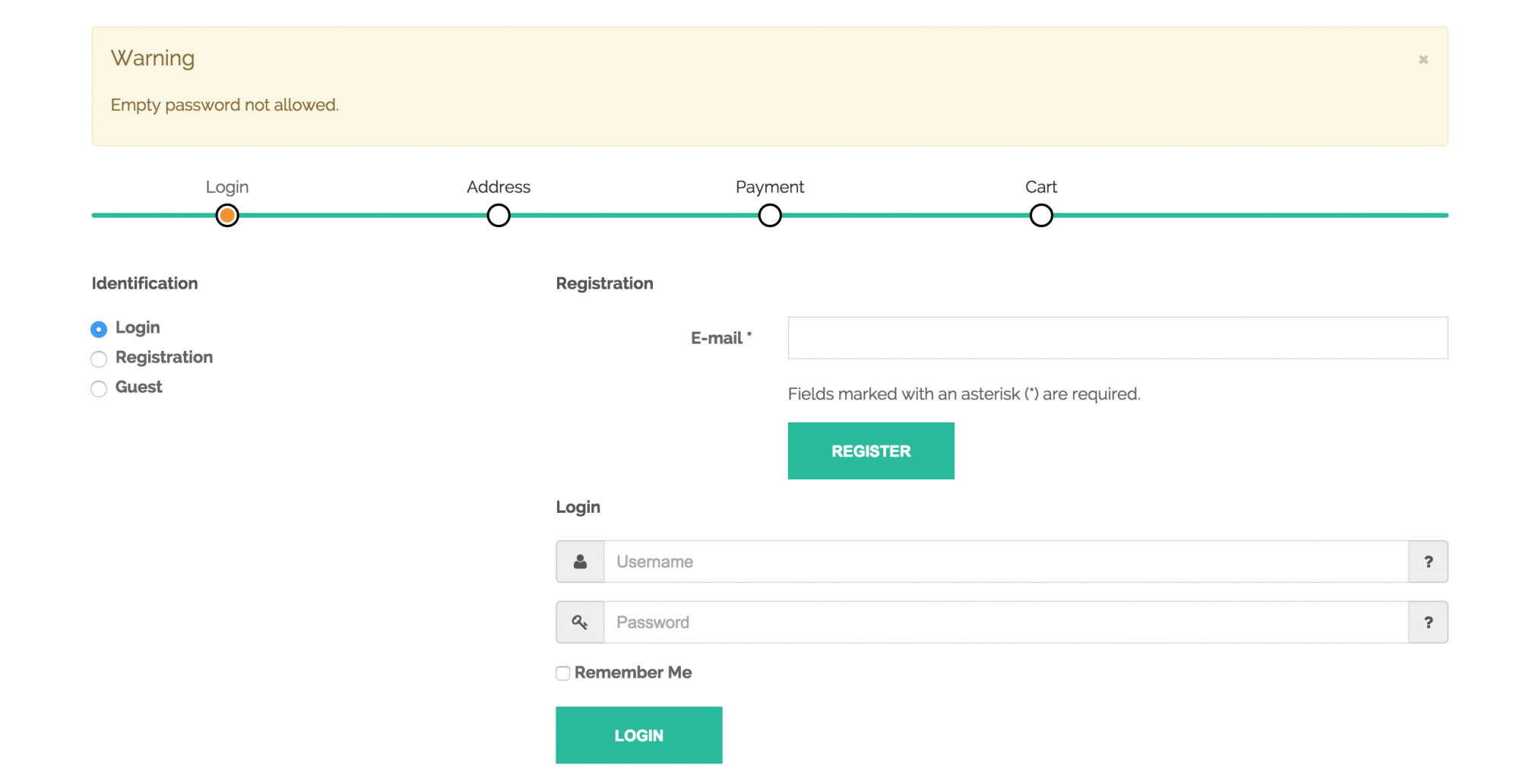

Hello:
Mine also seems to be the same case. I added the codes to the Checkout > Login page, but it is still not working.
Because the switcher isn't hiding any elements from this page, users misses the switcher and instead directly tries to register, but end up with a 'empty password not allowed message'.

@dennis3m
Your issue is different.
From what I can see the issue is with the CSS of your template preventing HikaShop from hiding the different pieces of the interface.
Without looking at the page I wouldn't be able to say exactly what CSS to change or add to fix that.
If you don't want the activation system for registrations, then just turn it off in the options of the Joomla user manager.

Your template is missing the CSS:
.hikashop_hidden_checkout{
	display:none;
Add it and it will then work properly.
