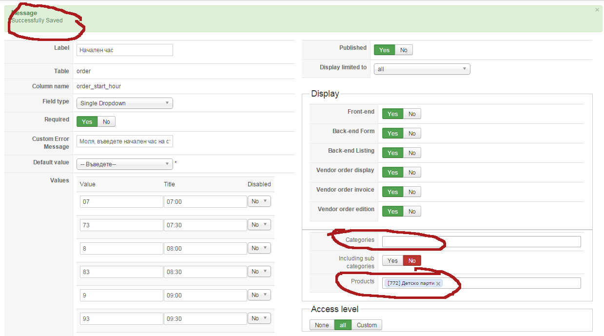

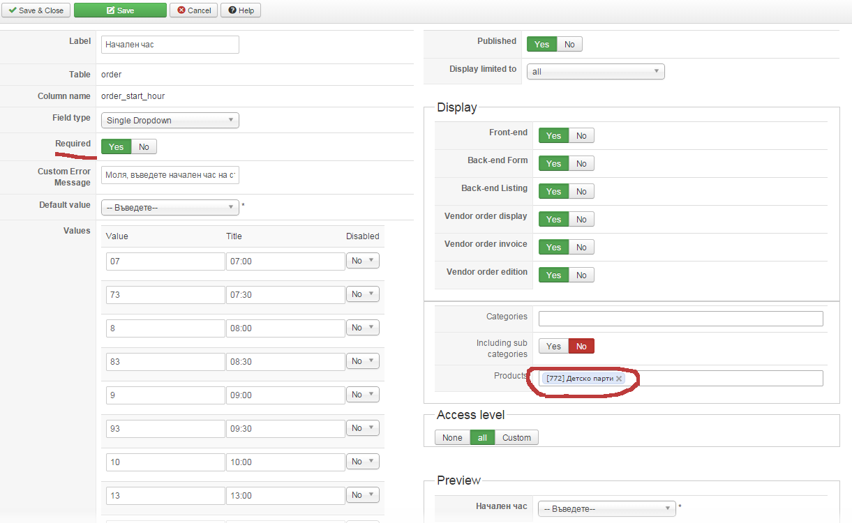

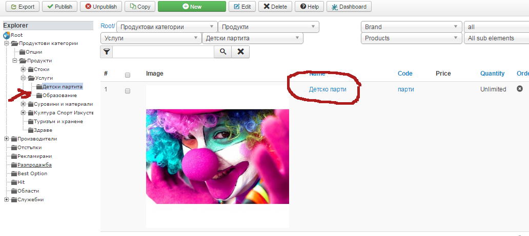

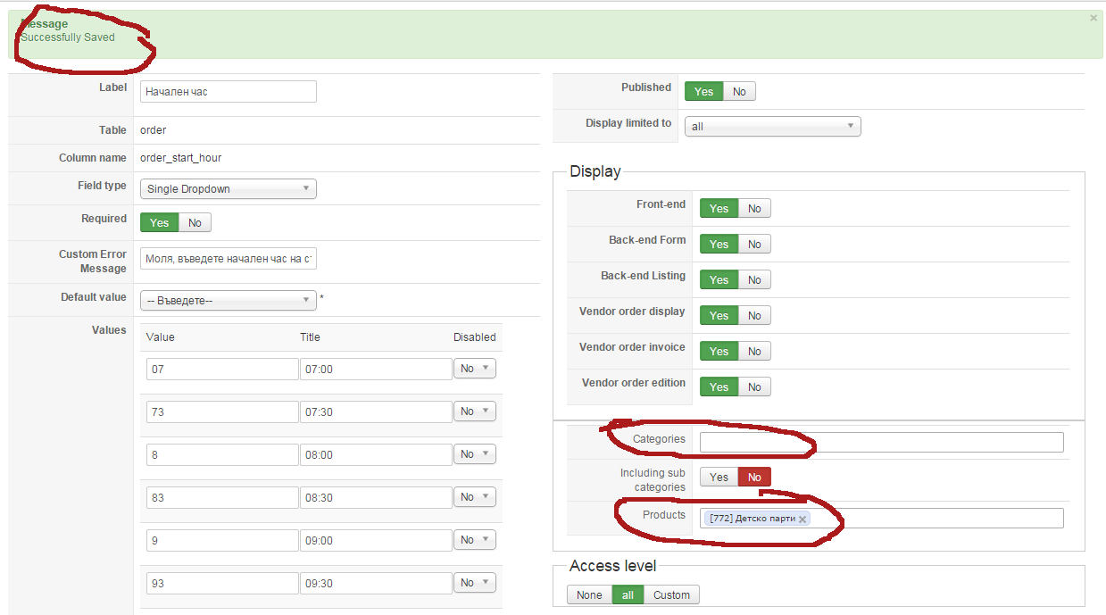

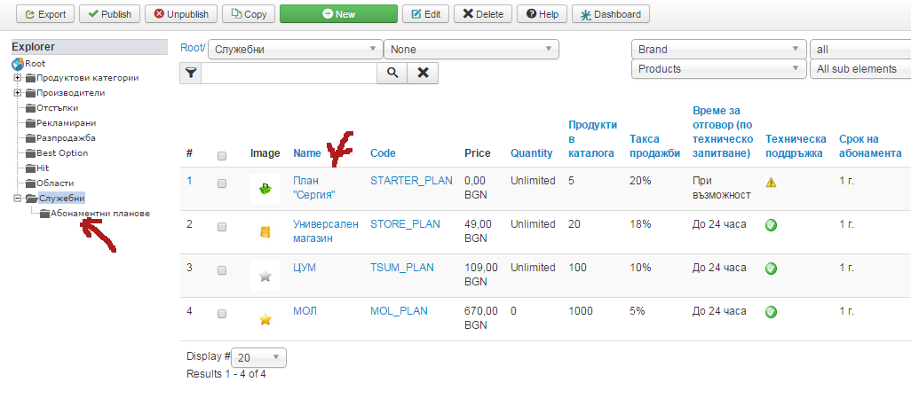

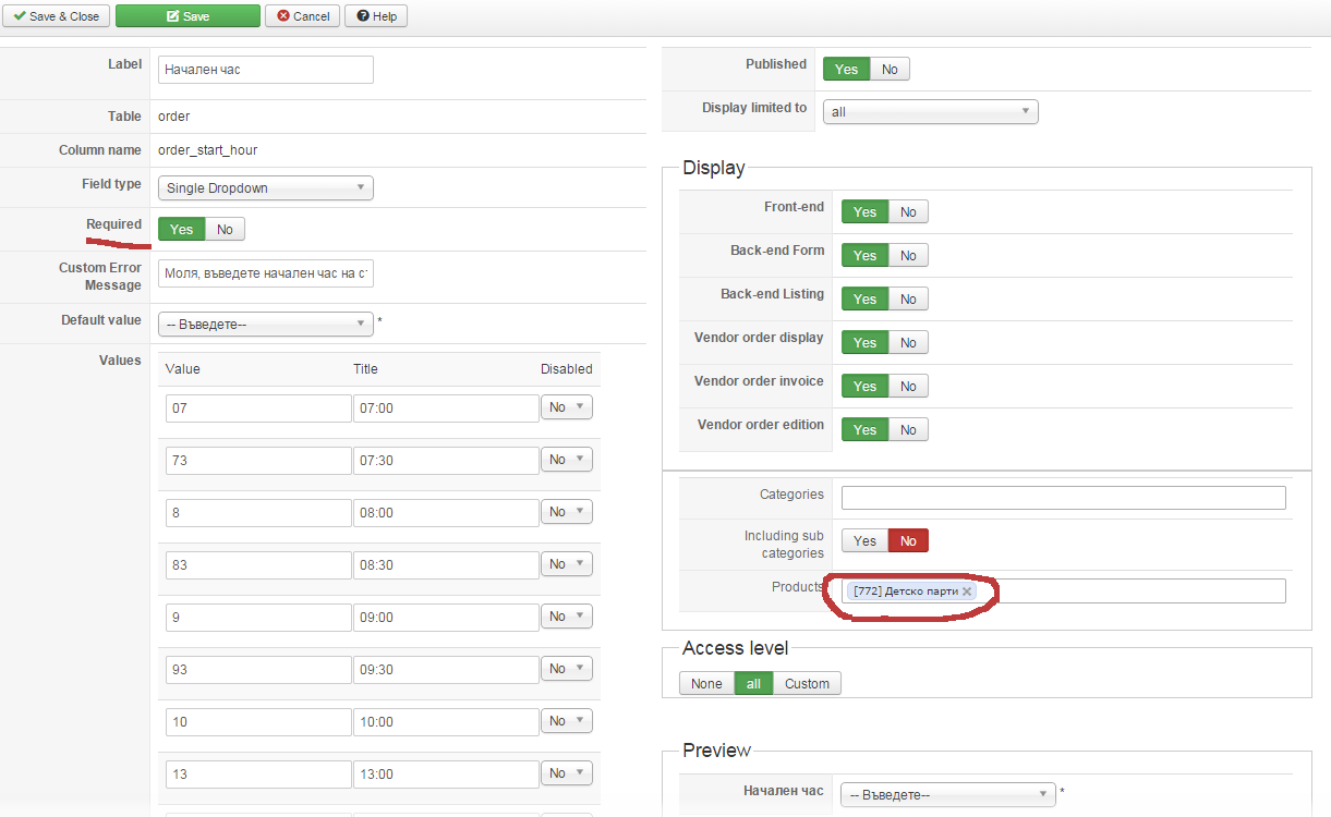

11 years 4 months ago #195737
1. New required order custom field "Начален час" is created for the product 'Детско парти'

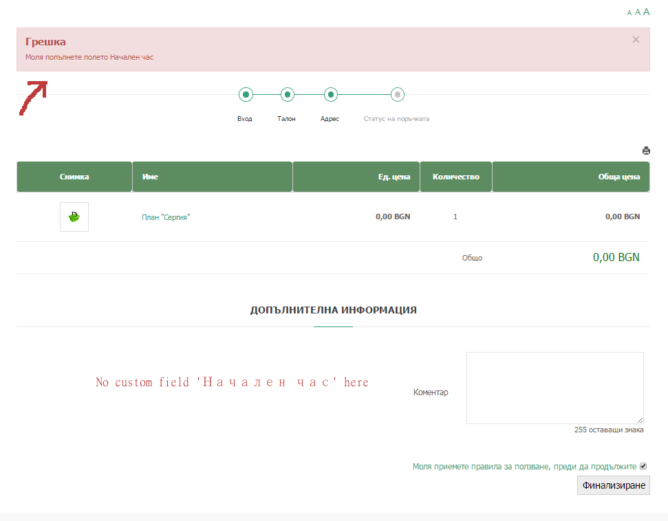

2. Another product 'План сергия' in totaly different category is being ordered buth the process can't be completed because the required field error is displayed for the custom field "Начален час". This field is not even present in the form itself.
Custom field creation

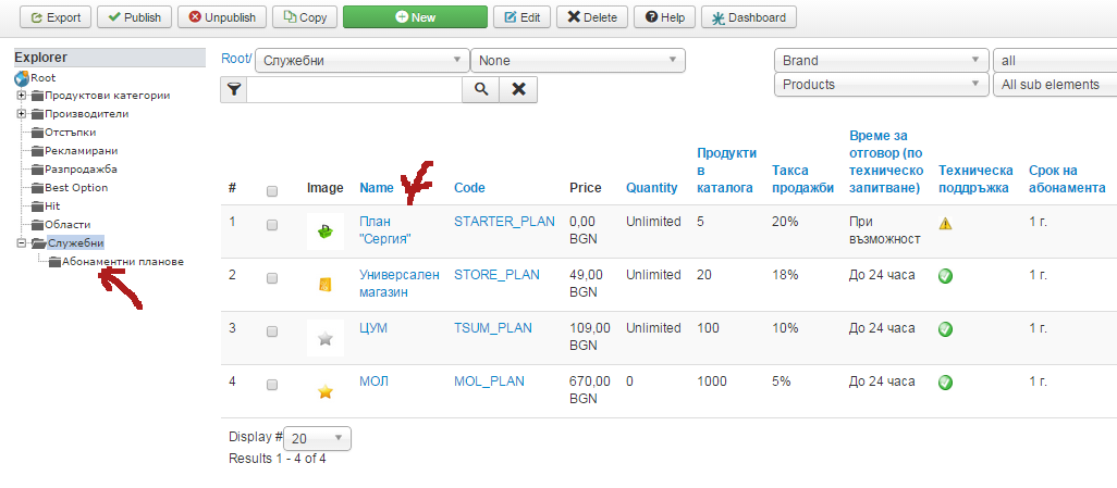

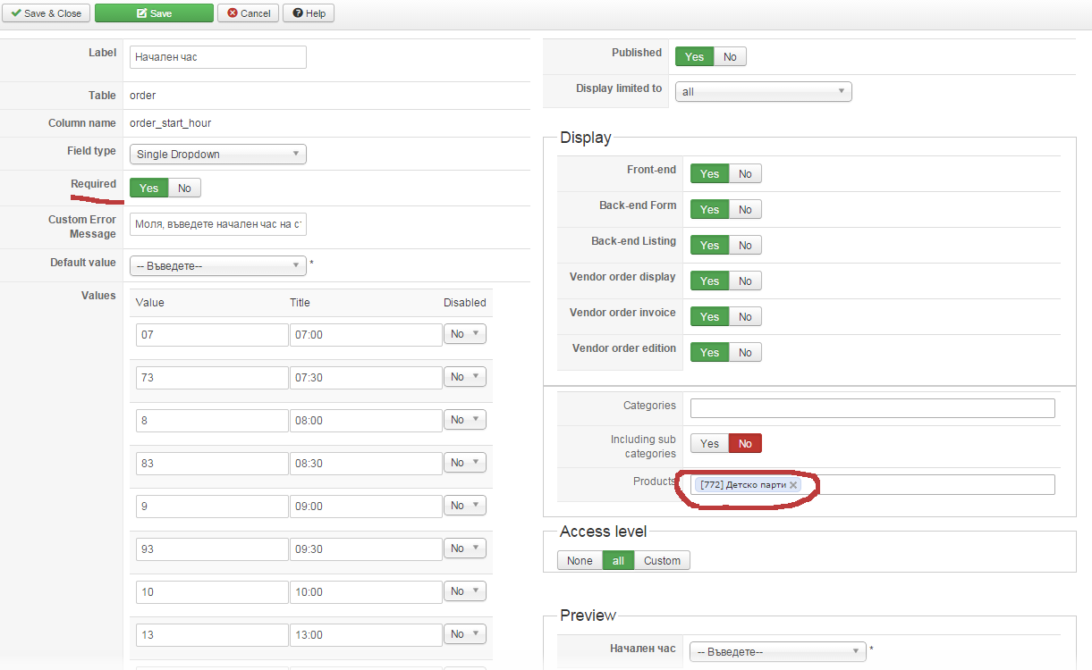

The product and it's category that the field is created for

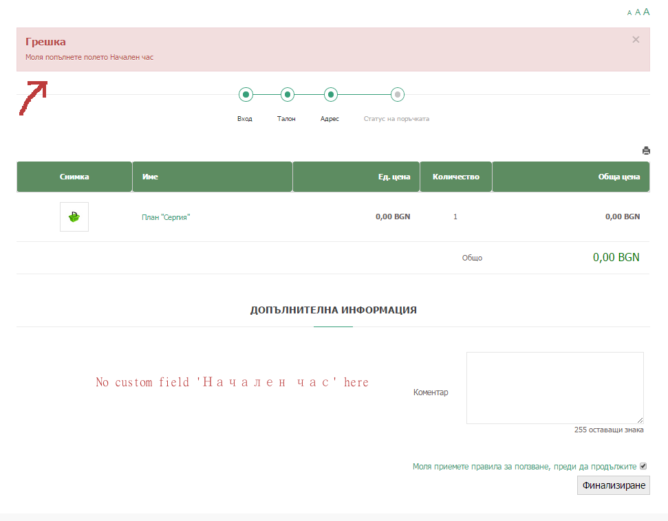

On ordering another totaly different product an required error is displayed for the custom field "Начален час". This custom field is not present in the form
And the ordered product is not even in the same category as the product that the custom field is for
Regards!

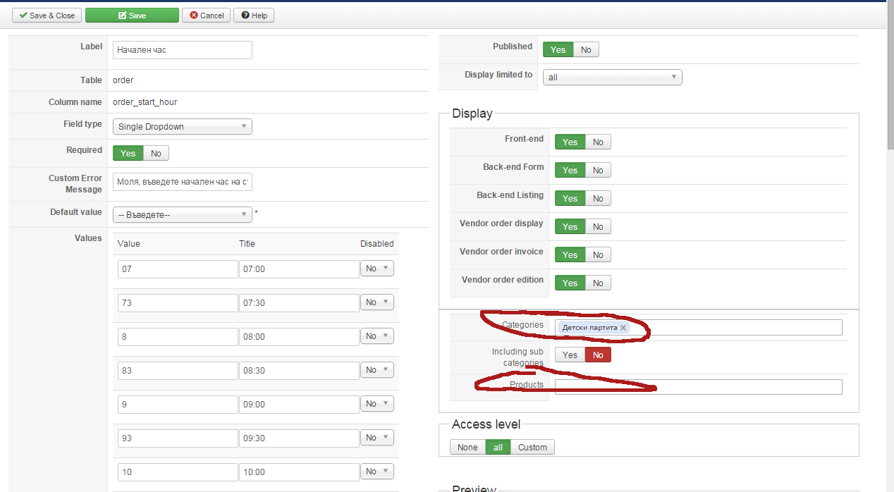

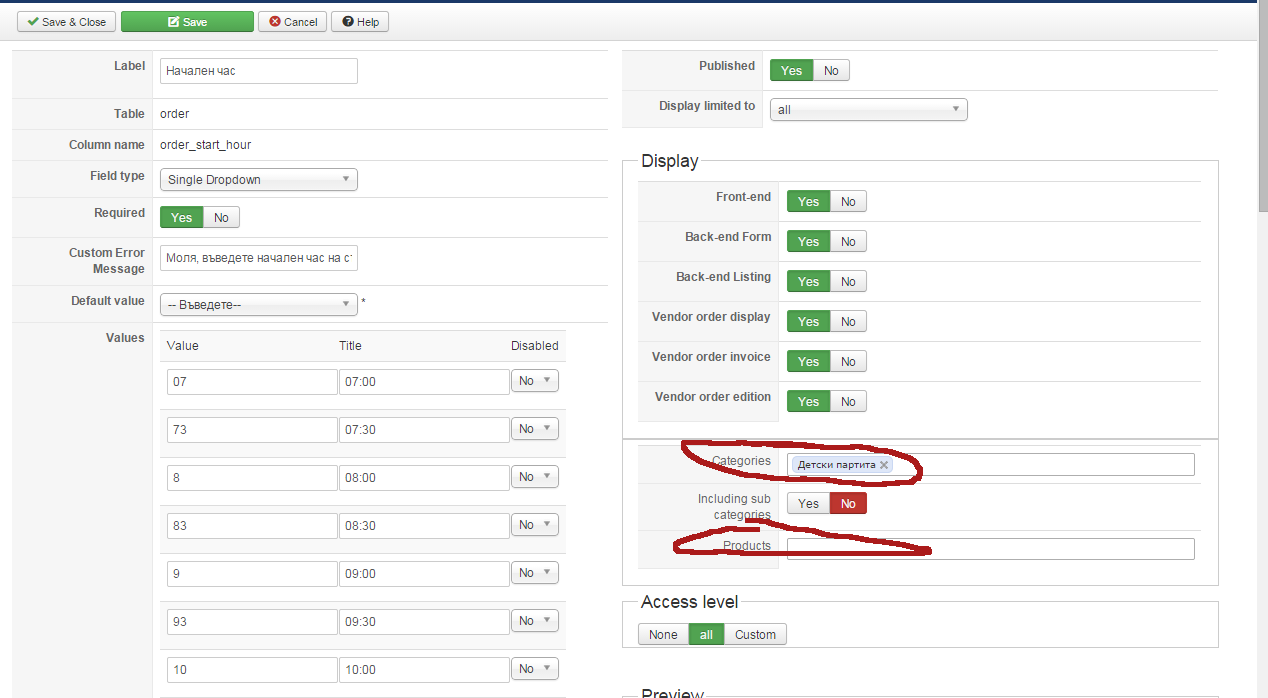

11 years 4 months ago #195738
About the second bug.
I will use the same custom field to describe it.
So I would like to assign the field to category and not to the single product. I delete the product(s) that the field has been assigned to and choose the category.
After the save has successfuly been done no category is present in the edit form (although it exists in DB) and the products are not deleted.
Last edit: 11 years 4 months ago by filiar.

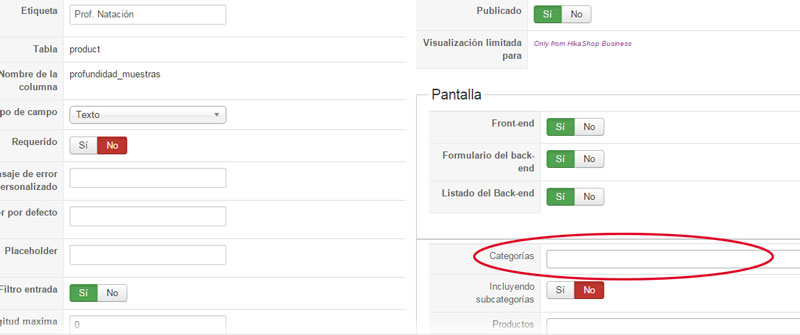

  • Posts: 7
11 years 4 months ago #196036
I have similar problem and I added the line
$field->field_products = '';
after line 1084 in file '/administrator/components/com_hikashop/classes/field.php'. It seems the only difference between both pieces of code but there is no change when I access custom field section:
Maybe I am wrong?

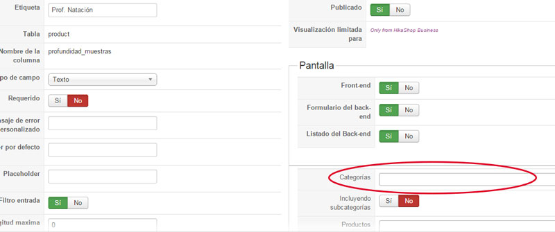

  • Posts: 7
11 years 4 months ago #196114
nicolas wrote: Hi,
What do you mean ?
The issue reported on this thread was about the deletion of categories/products selected in custom fields. Not about selecting categories/products in custom fields.
When you click on that field, you should be able to select the category you want. Isn't that what you get ?
I see the matter is different. I am sorry. My problem is, also, about custom field restrictions. When I create a custom field for products table, I can select which categories will include that custom field (ex. Colors for a car, size for clothes, but not both custom fields for both products, just one for each one). Then I save the new custom field. If I access to modify that custom field, restrictions category field is empty (as you can see at above picture). So, when I change anything I must re-enter the restrinctions category again.
  • Posts: 134
  • Thank you received: 6
11 years 4 months ago #196119
Yes. That's it - the same to me. But in fact the category is actualy saved in DB. It is just not visible.
