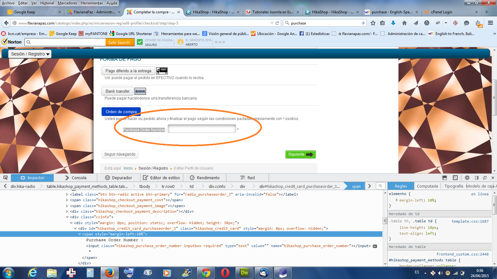

It's not what I meant, please see the image below. The payment option plugin that is used is "HikaShop Purchase Order payment plugin", and when I select it, a form appears that needs to be filled in before continuing, but whatever I fill in, I can't see it appearing anywhere, so what does it do?

What @Brotha refers is that when you create a payment method using the Purchase Order plugin, and the customer selects this method, (in the checkout) it appears a hidden <div> asking for a number. (see attachment)
What I know is that every company has their own numbering schema for purchase orders, but not anyone uses numbering (it depends on the nature of the product or service you are purchasing via internet or phone call).
So I think it is necessary that this field was not mandatory or even not present (in my case).
Where can I edit this? If you answer "Display>View>xxx " ,please, tell us which line.
Thank you
P.S. edition: I'was wrong :blush: : is mandatory because purchase orders implies obligation...how to say...some kind of contract, and the number is important for charge what they (customer) should pay you.

@Brotha: this number is shown in the "History" of the order (go to your backend>Hikashop>Orders>theorder>at bottom
@Xavier/Mohamed: in the Invoice, at bottom, it is said "Payment Method: Purchase order" but don't mention the number. I think is useful that the Invoice invoke the P.O number: how can edit this invoice template (or view or whatever) and which line should I edit?
And as @Bortha said, the number don't appear in the email, it could be useful appearing there, too.
