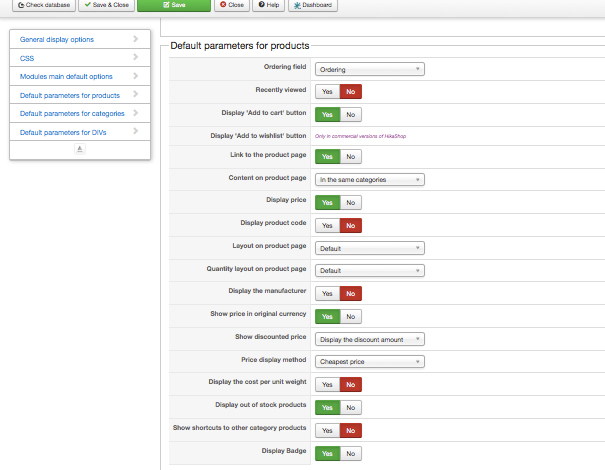

11 years 4 months ago #199822
Does this product has stock ?
Please give us screenshots of the product edition page and the settings under Configuration > Display > Product.
Do you have edited the view "product / quantity" ?

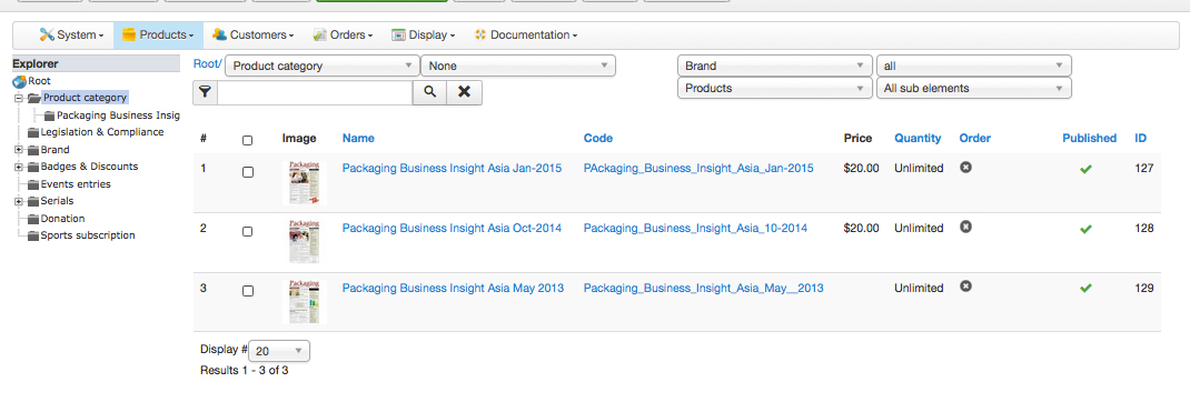

  • Posts: 14
11 years 4 months ago #200032
screenshots attached.
The product quantity is set to 'Unlimited' - since it is an e-book

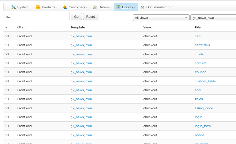

11 years 4 months ago #200055
You can check it via "Hikashop->Display->Views"
  • Posts: 14
11 years 4 months ago #200162
Do you mean this? I didn't touch or edit it
  • Posts: 86212
  • Thank you received: 14220
11 years 4 months ago #200220
You must have turned on the "catalog mode" option of the HikaShop configuration which removes all the add to cart buttons from your website.
  • Posts: 14
11 years 4 months ago #200231
Thanks - that worked .... I didn't see anything about "Catalog Mode' doing that in the Documentation or FAQ
