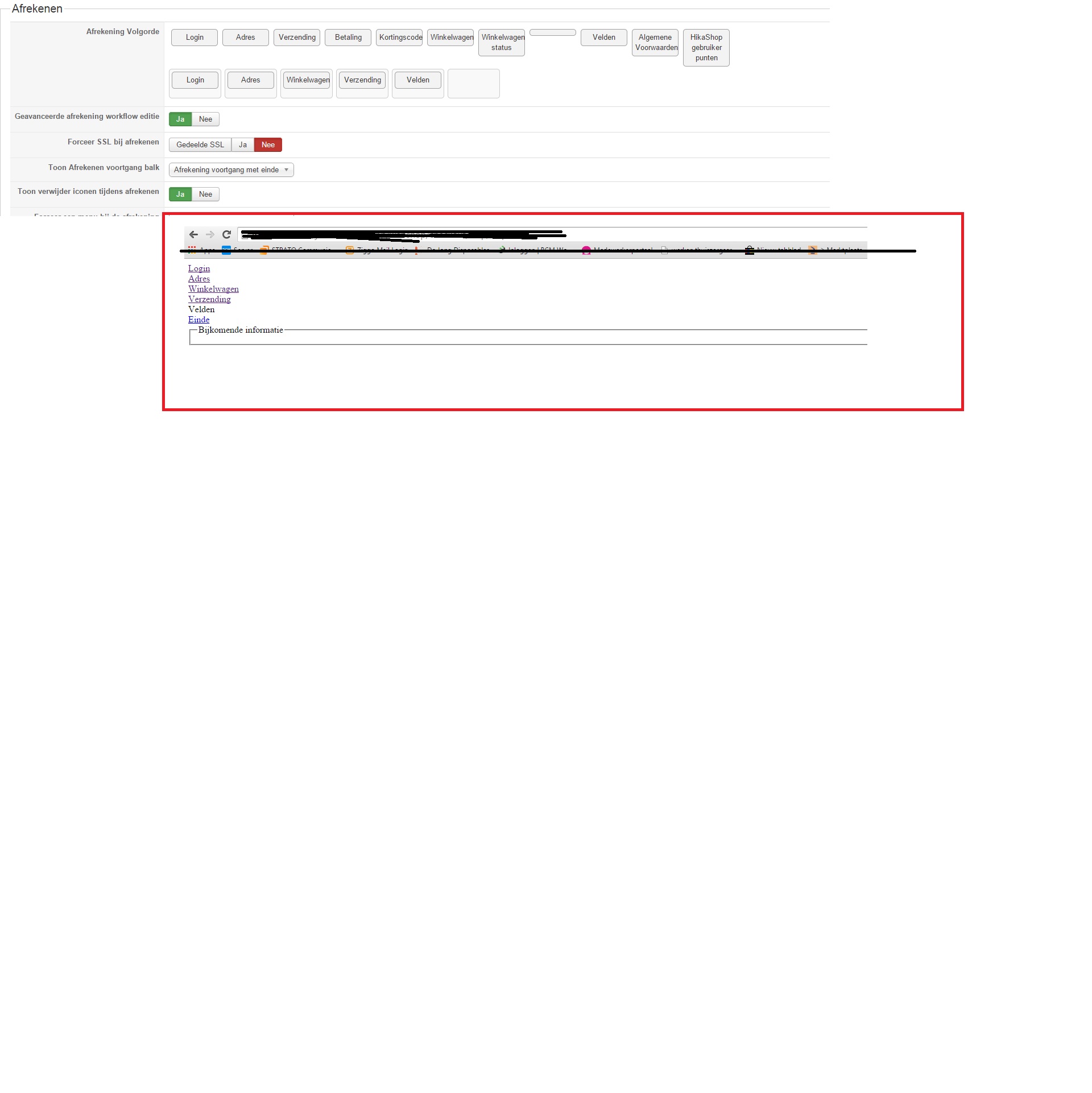

When im in the checkout and getting to my own fields, then the website is going to a white screen with only showing text.
I hope that the screenshot can help me explain the problem...
Many Thanks !

I think you have a PHP fatal error in your page.
The easier will be to check your PHP error log or to set the "error reporting level" to "maximum" in your Joomla global configuration.
Thanks to that, you should be able to see the error message and so, help us to find a fix for your issue.

Thanks for youre anwser, i set the reporting level to the max. and i get this message :
Parse error: syntax error, unexpected ';', expecting identifier (T_STRING) or variable (T_VARIABLE) or '{' or '$' in /volume1/web/joomla/components/com_hikashop/views/checkout/tmpl/custom_fields.php on line 21

Here the line 21 of the line that we got in HikaShop 2.4.0
<tr class="hikashop_checkout_<?php echo $fieldName;?>_line" id="hikashop_<?php echo $type.'_'.$oneExtraField->field_namekey; ?>">
Do you have the same content for the line ?

No my line was changed, i don't know why.
Anyway, i have change the line back to the line you send me today, and it worked !!
