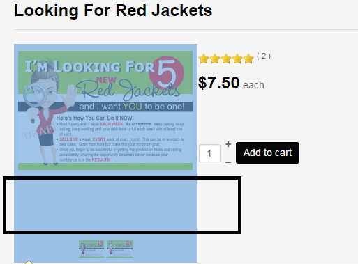

-- Joomla version -- : 3.4
Sigh....
How do I remove the space at the bottom of the product when there are other variations to choose?
It's just too far away...AND they are pretty small.
How can I make them closer to the top image and change the size to be larger!
11 years 5 months ago #199425
I guess that in your image settings you have set the product image height to 270px, so that's why it is forcing the height of this div.
Else you can use code like:
.hikashop_product_main_image_thumb, .hikashop_product_main_image{
    height: auto !important;

11 years 5 months ago #199515
WooHoo! RIGHT ON!
Nice.... sigh...finally!
And...is there a way to make those 2 little images underneath larger?
  • Posts: 86212
  • Thank you received: 14220
11 years 5 months ago #199541
Yes, you can modify the CSS for that:
www.hikashop.com/support/support/documen...ling.html#thumbnails
