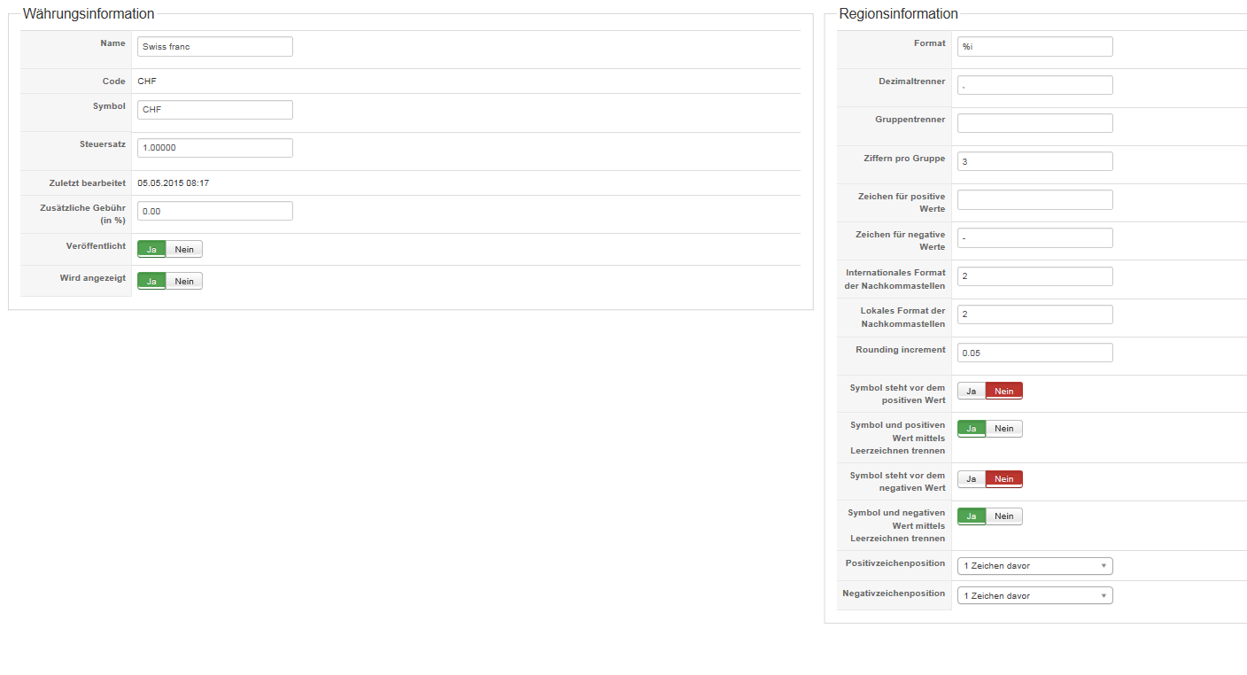

11 years 2 months ago #200389
Yes. Edit your currency via the menu System>Currencies and change the "Rounding increment" option to 0.05 and the system will round the elements by steps of 5 cents.

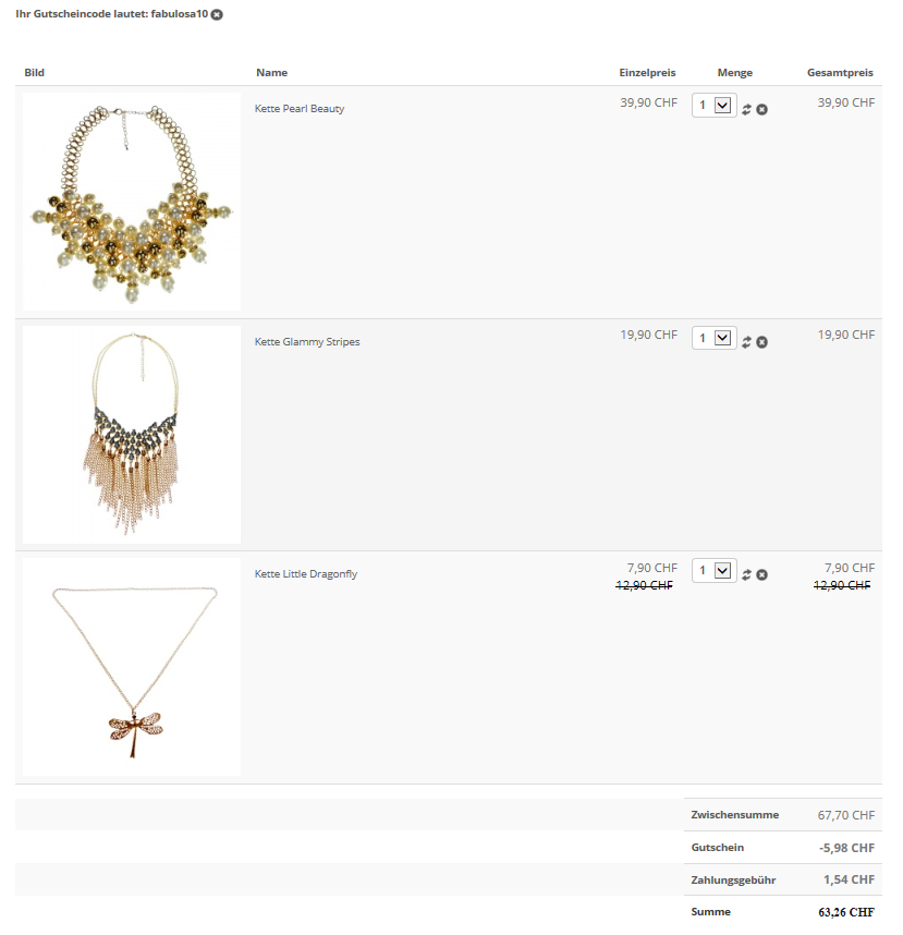

  • Posts: 62
11 years 2 months ago #200487
Hi nicolas
Thanks for the answer. I changed it to 0.05 in the options of swiss franc. But unfortunately nothing happened. It still shows the price for example:
Product Price: 39.8 CHF
voucher: 10% = 3.98 CHF
Price=35.92 CHF
regards

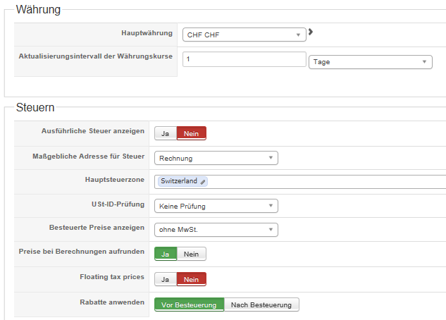

11 years 2 months ago #200495
Please make sure that you have the "round prices during calculations" option turned on in the HikaShop configuration.
  • Posts: 62
11 years 2 months ago #200569
Hi nicolas
If you mean in the main configuration under taxes, it is turned on.

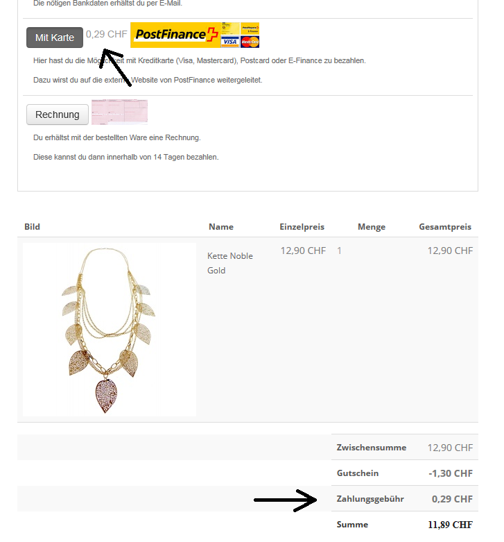

11 years 2 months ago #201220
Hello
Maybe the pictures in the attachement will show my problem more clear.
florcar

  • Posts: 62
11 years 2 months ago #202250
Hi Nicolas
Thanks a lot for the solution and the efforts. And dont worry for the delay.
I replaced the attached files and it seems to work for the discounts. But unfortunately it has no effect on the payment fees. See attached Image.

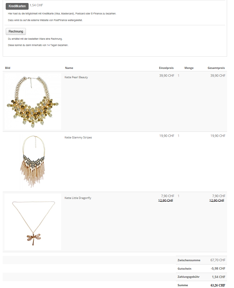

  • Posts: 62
11 years 2 months ago #202352
Hi nicolas
The problem still exists on the listing of the final price. The payment fee is correctly rounded in the "Choose the payment method" but unfortunately not at the final price :blush:
See attached image.
florcar

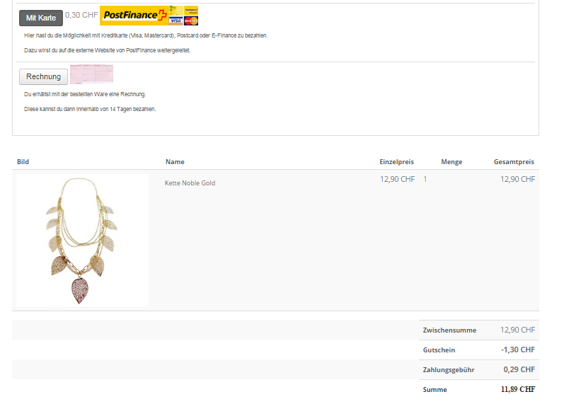

  • Posts: 62
11 years 2 months ago #202435
No, it didnt change anything :blush:
I think you have one semicolon too much in your code. I tried both but it didnt work anyways.
