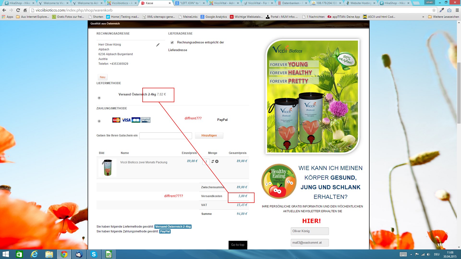

Hi friends.
I have a hopefully simple question:
In checkout the shipment method is autoselected correct with the correct price shown, but below the price for the product is shown correct with tax and the shipment price without.
Any ideas of my missconfiguration?
Thanks a lot in advance!

That shouldn't happen. Check if your have the file templates/YOUR_TEMPLATE/html/com_hikashop/checkout/cart.php and if you do, rename it to something else. That will deactivate the override on that file and use the default view file of the current release which doesn't have that problem as far as I could test.
