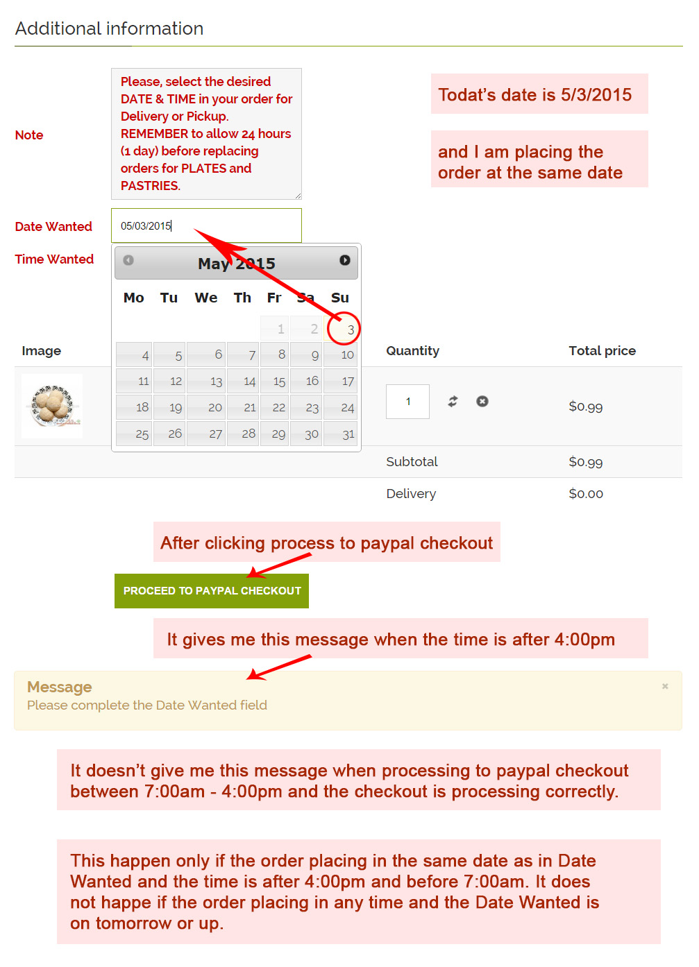

After purchased and installed Hikashop Business Version, Everything is works as it should to be. The only problem I have is this:
I added a custom filed called (Delivery/Pickup Date Wanted) to the Order Table so this field will be displayed at the checkout.
The Delivery/Pickup Date Wanted filed type: Advanced Date Picker
Allow field set to: Only Future Dates cause no one is allowed to select a previous date for delivery or pickup.
It works fine, but, I provide pickup or delivery at the same date and most my customer will need it at the same date.
At the checkout, it shows today's date and the future date and I can select today but when click "process to payment" it stays on the same page and gives me this message "Please complete the Delivery/Pickup Date field". So, costumers can not process to payment checkout if they will choose today's date. If they select tomorrow and up dates, the process to payment works fine.
i.e. Today's date is 5/1/2015. The "process to payment" will works only if the date selected to 5/2/2015 and up. I need to process to payment even if I select today's date which is 5/1/2015.
How can make today's date included on future's date?

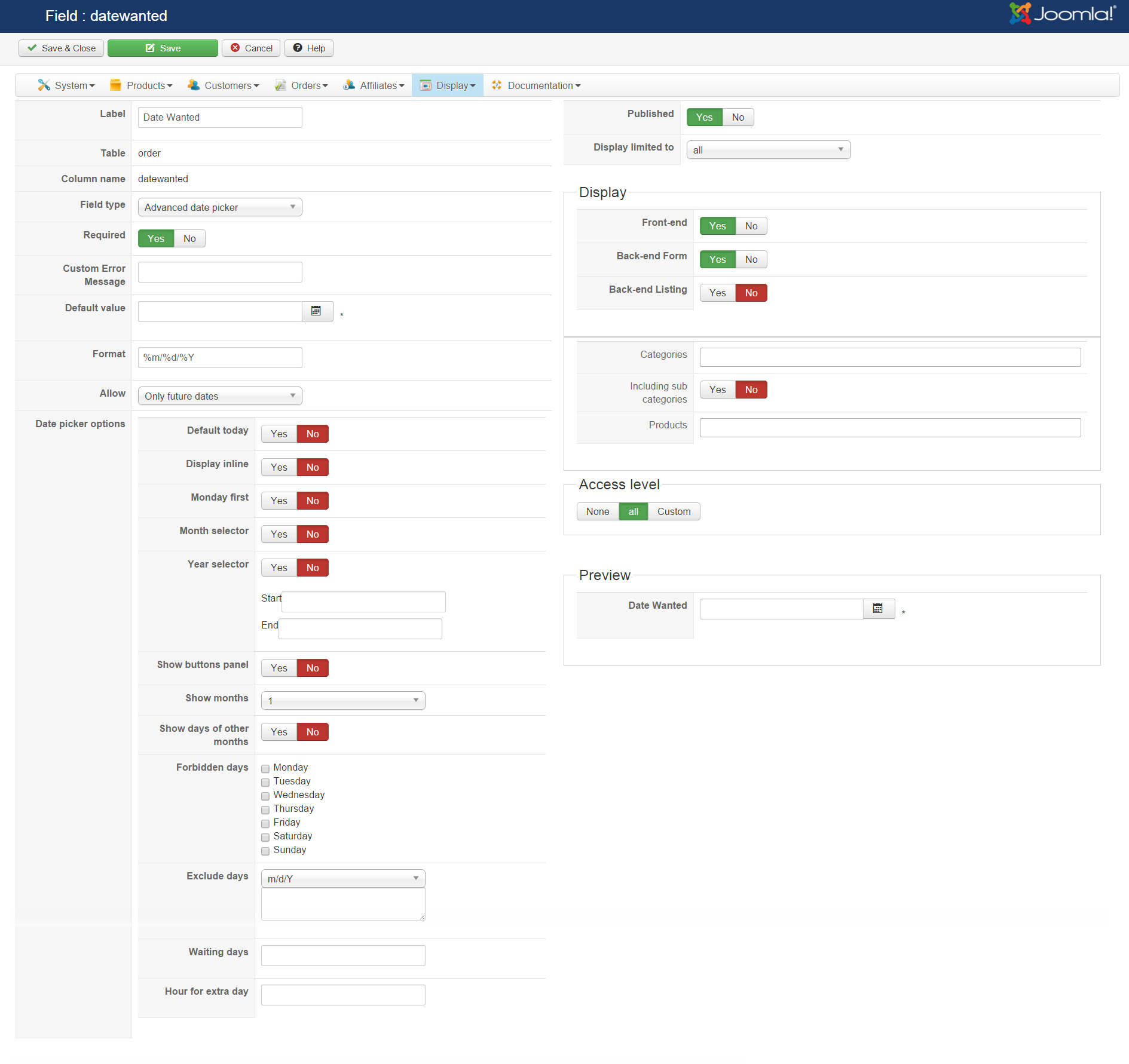

Could you provide a screenshot of the settings page of your custom field so that we can reproduce the situation ?

Yes, I already create a custom field of the table "simple dropdown" for the time. I just was wondering if it can be more professional. The time field is very important for me and without it can not complete the order. May be it is not important for some projects like "electronic, auto part, etc...", but in my case I am selling food online (sandwiches, plates, appetizer, etc...) and the time is very important for pickup or delivery. If someone want a lunch, he will need it in specific time and he has to select the time so I will know when he need it. I think there is "requested features" in submit form. I will submit a request to add professional time field like the date to be consider it in future :)
However, about the date. I checked it and it seems I can select today's date if the time is between 7:00am - 4:00pm. It is fine for me for now. But, If I want to play with this time and make the today's date between 8:00am - 8:00pm, how can I do that? After 4:00pm, today's date is still active, but when click on "process to checkout" it gives me "Please complete the Wanted Date field" I attached a screen shoot for the date setting and the message.

  • Posts: 86212
  • Thank you received: 14220
11 years 4 months ago #200716
I don't see why that would happen unless either your web server timezone is not correct, or your Joomla configuration timezone is not correct (and thus it thinks that the day changes at 5pm instead of 0 am).
  • Posts: 11
11 years 4 months ago #200783
The Joomla Server Time Zone set to: Phoenix (Which is correct)
PHP information for the date is:
date/time support enabled
"Olson" Timezone Database Version 2014.8
Timezone Database internal
Default timezone UTC
Directive Local Value Master Value
date.default_latitude 31.7667 31.7667
date.default_longitude 35.2333 35.2333
date.sunrise_zenith 90.583333 90.583333
date.sunset_zenith 90.583333 90.583333
date.timezone UTC UTC
Is there any incorrect setting on above parameters? Also, if after 5:00pm the system counting the day as tomorrow, then it should disable this date (non clickable) , but what is happening it is still clickable.

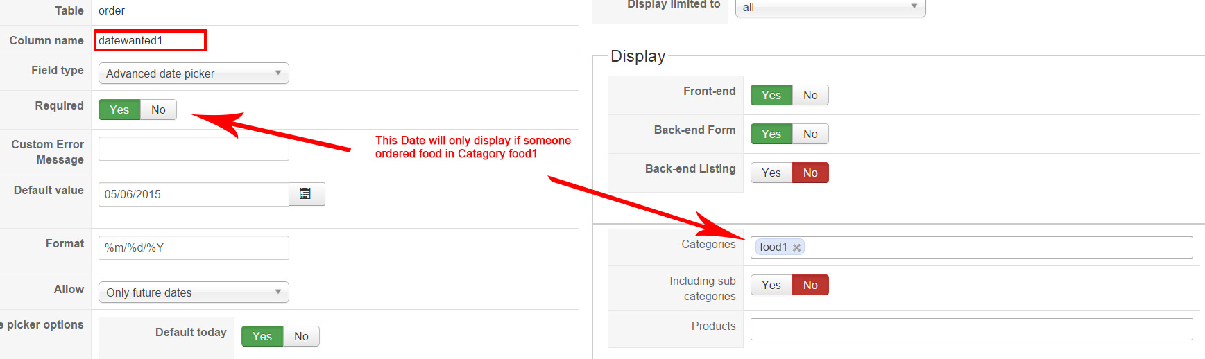

Another issue I am getting that I do not know if it is a bug or not.
I create 2 fields for the Wanted Date in Order table and each one will display for certain products category. i.e.:
Wanted Date1 - This date will display only if someone ordered food in category food1.
Wanted Date2 - This date will display only if someone ordered food in category food2.
Both Required is set to YES.
Now, if I ordered a food in category food1 ONLY, Wanted Date1 will be only displayed during the checkout as it suppose to be. The problem is when click on finish your order it gives me message to fill the Wanted Date2, which should not because I didn't order a food in category food2 and I can not complete the order. If I set the Required to NO, it will works fine, but I need to set it to YES so people can not leave it blank.
Any suggestion how to fix it?
Thanks,
RAID
  • Posts: 26387
  • Thank you received: 4078
11 years 4 months ago #200997
Yes, it's a known issue and we already have a ticket in our system for that.
www.hikashop.com/forum/checkout/875842-c...s-errors.html#196310
