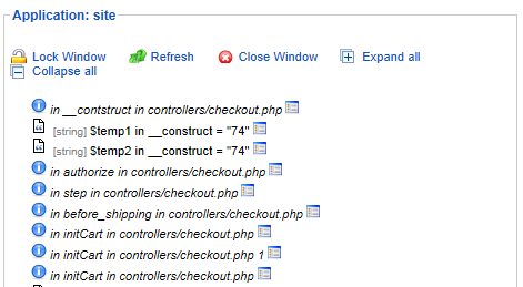

The default shipping and billing addresses are already set in the __construct function in the file components/com_hikashop/controllers/checkout.php. As a test, I have added the following code into the __construct function.
function __construct($config = array(),$skip=false) {
dumpMessage('in __contstruct in controllers/checkout.php');
$temp1 = $app->getUserState( HIKASHOP_COMPONENT.'.shipping_address',0 );
$temp2 = $app->getUserState( HIKASHOP_COMPONENT.'.billing_address',0 );
dump($temp1, '$temp1 in __construct');
dump($temp2, '$temp2 in __construct');
The results are as attached.
As per the results, the default values are already set in the __construct function (presumably when the user logs in).
Please let me know where these values are set; I think they are set even before the before_address function that you refer to in your code below.
Thanks.
Take care!
  • Posts: 86212
  • Thank you received: 14220
11 years 4 months ago #200718
It depends how you test actually.
But yes, it would be possible that these were already set before.
In that case, you want to look at the code:
					$app->setUserState( HIKASHOP_COMPONENT.'.shipping_address', $address->address_id );
					$app->setUserState( HIKASHOP_COMPONENT.'.billing_address', $address->address_id );
in the onLoginUser function of the plugins/system/hikashopuser/hikashopuser.php file.
