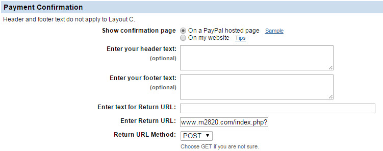

11 years 4 months ago #201722
Solution:
I would like you to answer the questions above, but I did find a solution on PayPal website until you guys fix the shopping cart. Here it is in case others need a fix:
1. Sign in to your account on manager.paypal.com
2. Go to "Service Settings" tab at the top, then click on the "Set Up" tab underneath that tab.
3. Scroll down to the "Payment Confirmation" section (see attached image) and set "Show confirmation page" to "On a PayPal hosted page." This will bypass your shopping cart and PayPal will take care of letting the customer know that the transaction has completed successfully.
Brad
Sunday School Teacher Training
www.m2820.com
