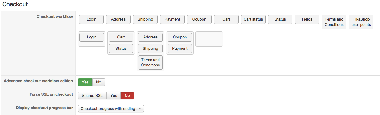

1. Remove the "payment" view from the first step of the checkout workflow setting of your HikaShop configuration.

1. The first step in the checkout workflow is Login. Payment doesn't appear until the 4th stage (see attached screenshot)

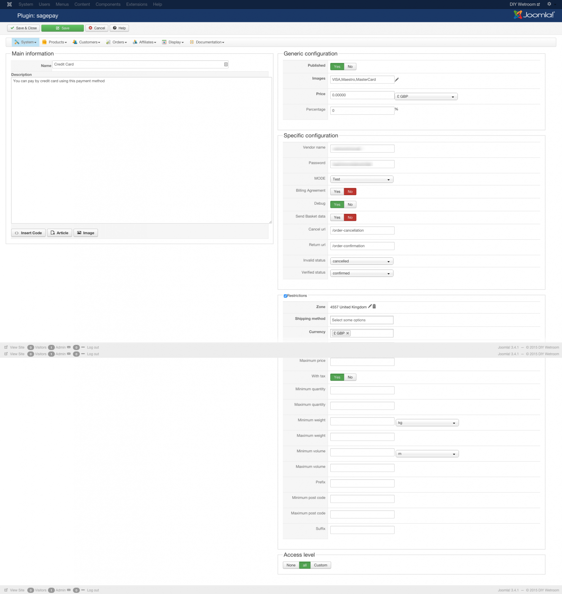

Could you edit your payment methods settings and provide a screenshot of their settings via the menu System>Payment methods ?
  • Posts: 35
11 years 4 months ago #201760
Sure,
here you go..
  • Posts: 86212
  • Thank you received: 14220
11 years 4 months ago #201761
It must come from the zone restriction for your payment method.
Try to remove it and you should hopefully not have the error message anymore.
