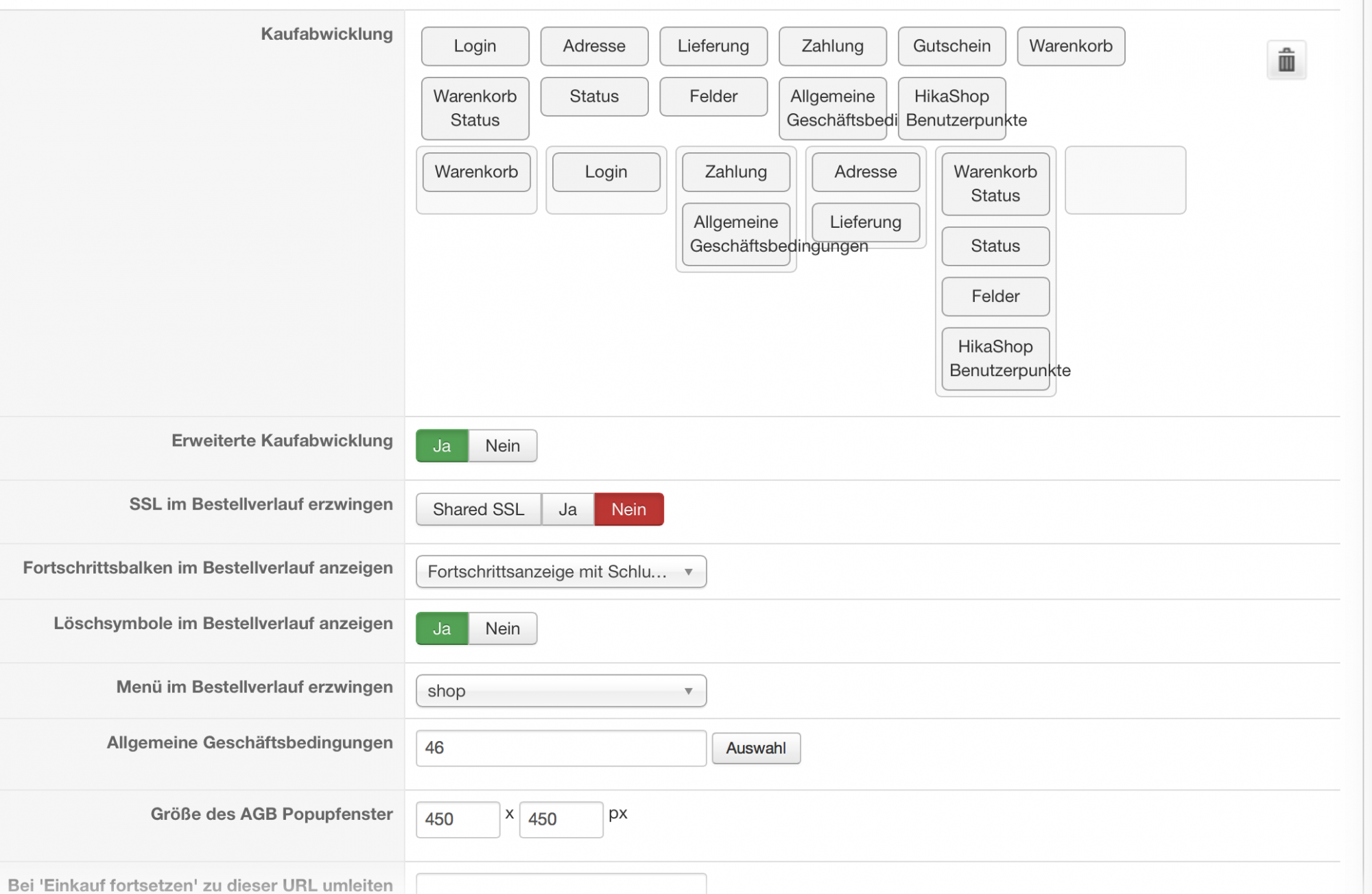

Could you provide a screenshot of all the settings of the "Checkout" tab of the HikaShop configuration so that we can see how you setup your checkout ?
  • Posts: 8
11 years 4 months ago #202244
of course.

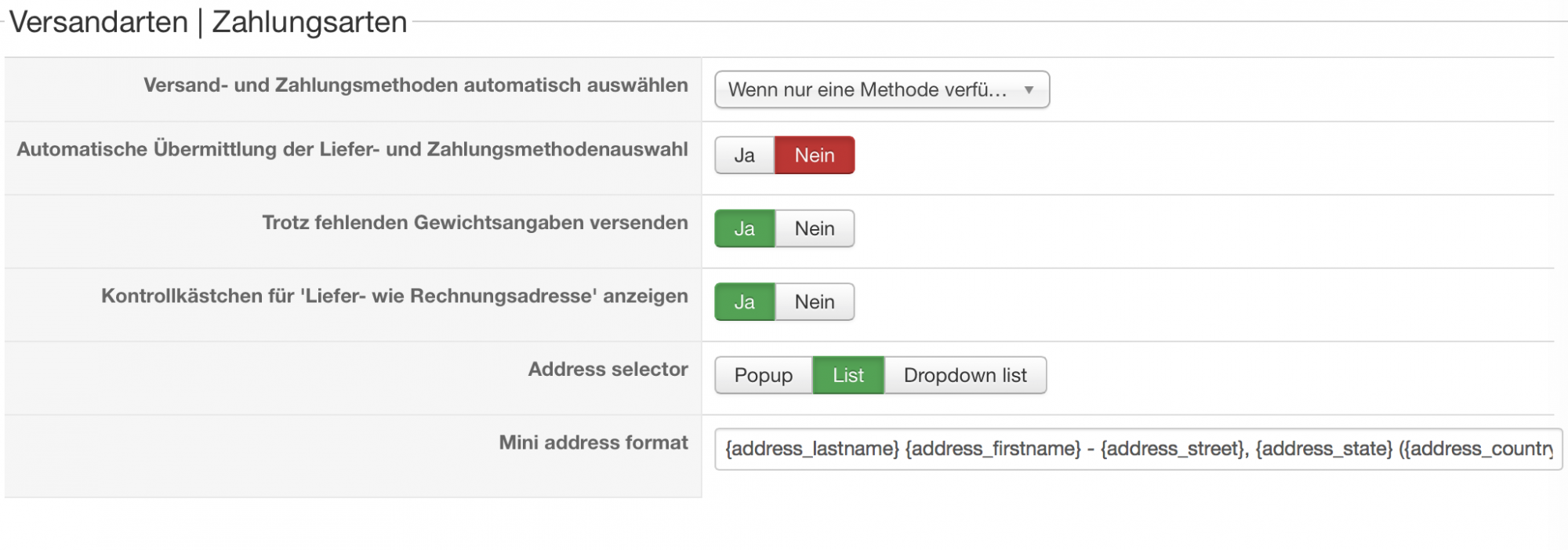

11 years 4 months ago #202282
1.
In your case you should set the "Auto submit shipping and payment methods selection" option to YES

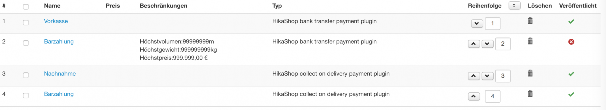

2. 3.
Your issue is probably coming from the way you have configured the payment methods that you are using on your website, can you check that you correctly configured them through "Hikashop->System->Payment methods->'Your Payment methods'" , and also show me some screenshots of how you configured them ?
