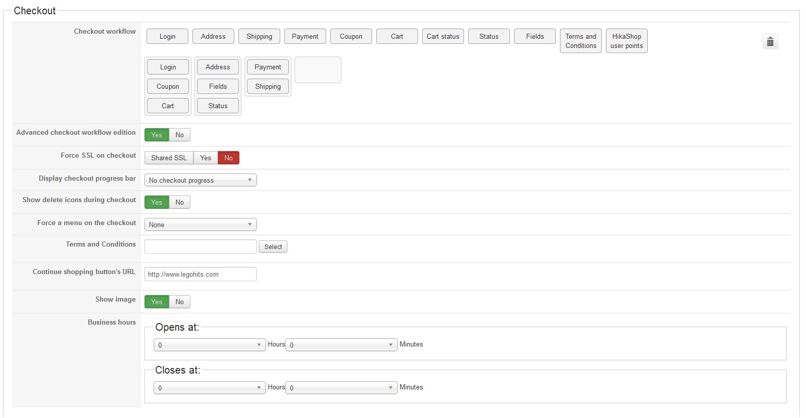

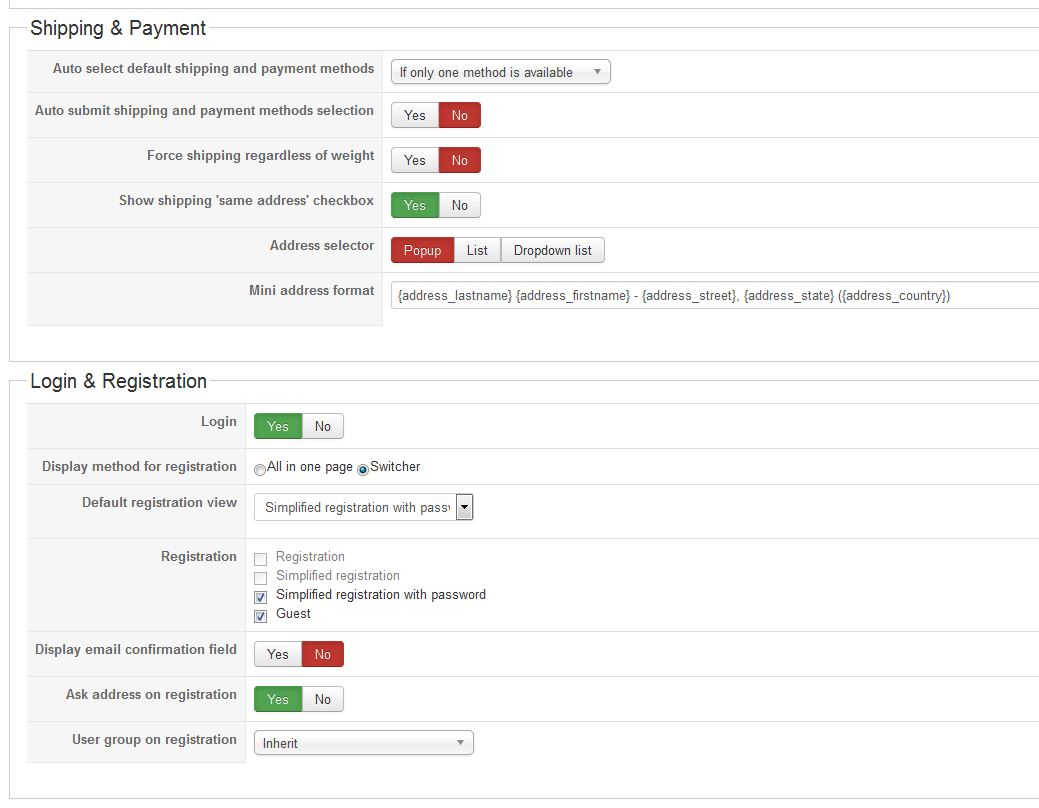

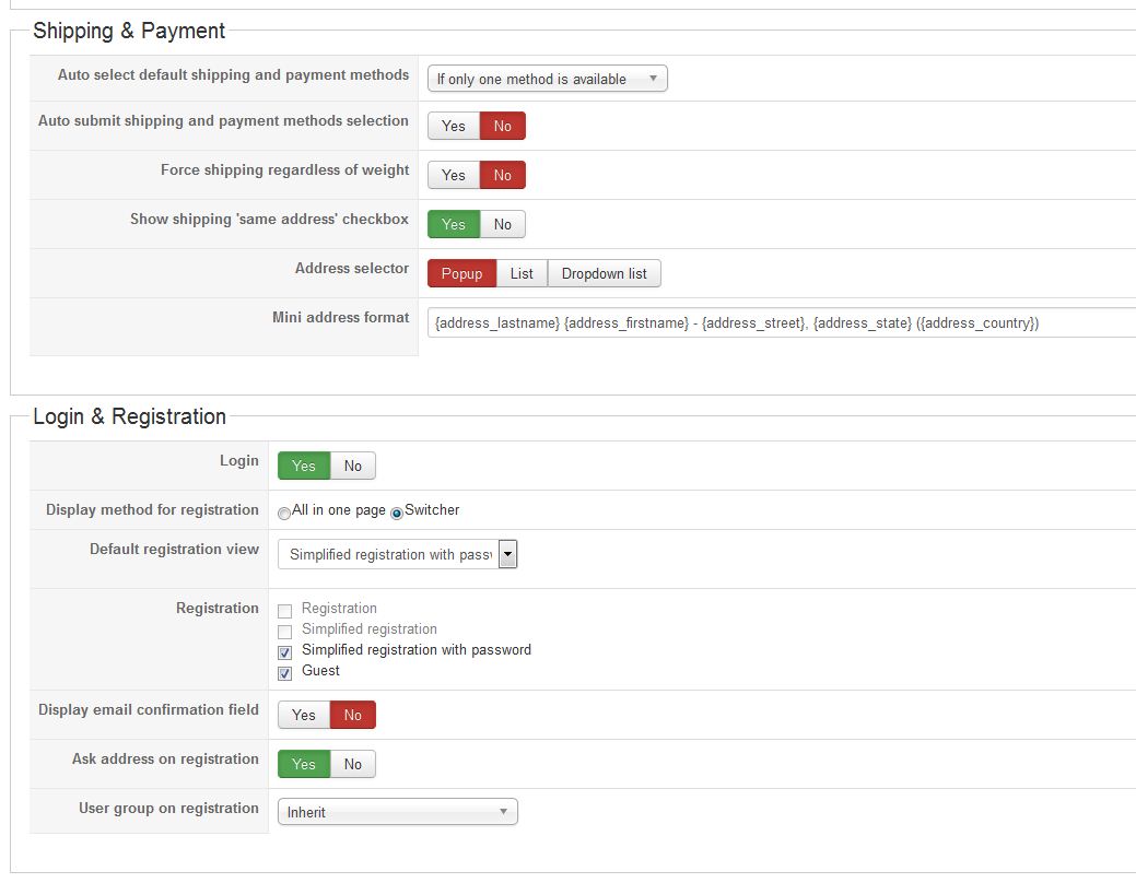

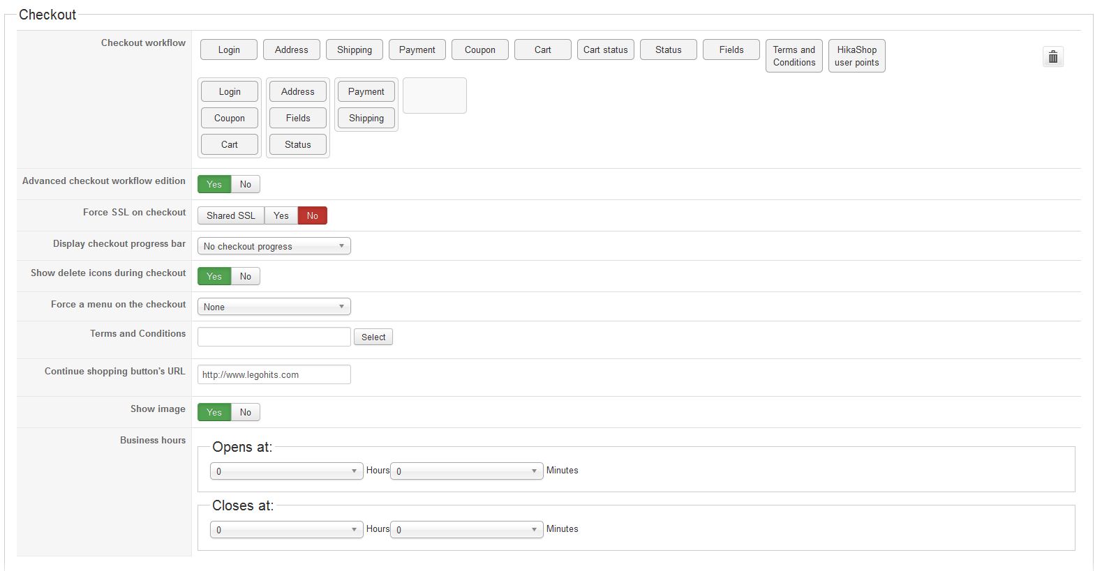

  • Posts: 108
11 years 3 months ago #202820
sure, here it is
The following user(s) said Thank You: Marklimwel14
  • Posts: 86216
  • Thank you received: 14222
11 years 3 months ago #202837
Please make sure that the auto submit and auto select options of the checkout tab are activated. You should then not have that issue anymore.

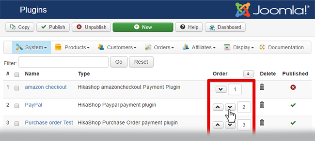

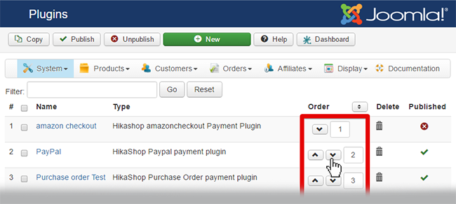

9 years 10 months ago #255832
I have maybe an idea, the auto select payment method option will always pick the first payment method, and so I guess that the one with the credit card form is the first in your payment method order.
Maybe you can modify order for have at the first place, a payment method without this kind of form maybe you will have what you want AND keep the auto select payment method switch on.
Hope this will fit your needs.

9 years 9 months ago #256106
I moved it to be second in line and preselected. I still have to click finish (send my order) twice for it to be submitted.
