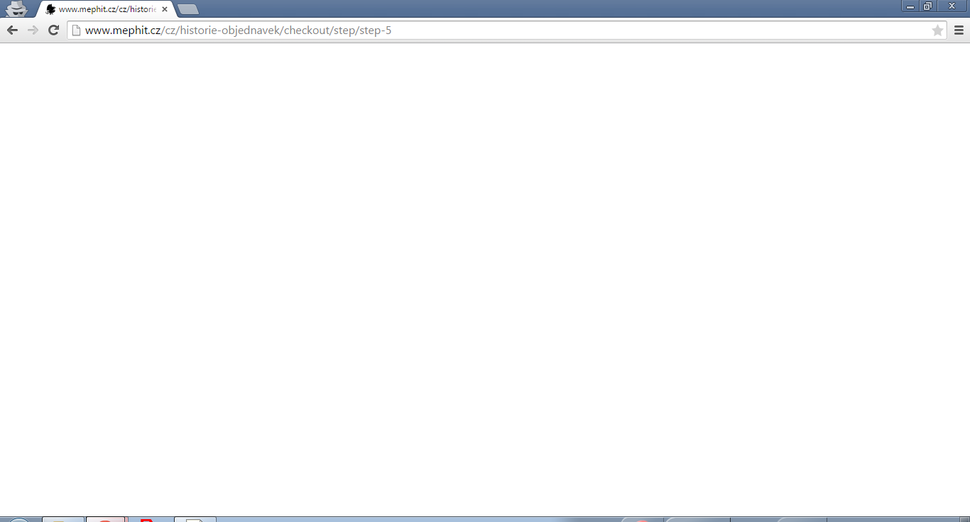

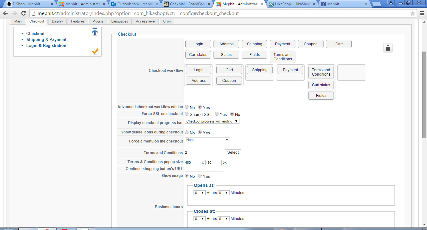

I have problems with checkout on my page, for checkout configuration see:
1) Add an item to cart.
2) Proceed with the purchase till the end (as either guest or user)
3) At the end of checkout there will be blank page see also:
I am expecting to see the confirmation page that the purchase was succesfull

11 years 3 months ago #203415
It happens for all payment methods, error message is:
Fatal error: Class 'JMail' not found in /home/cp10150/public_html/libraries/joomla/factory.php on line 765
