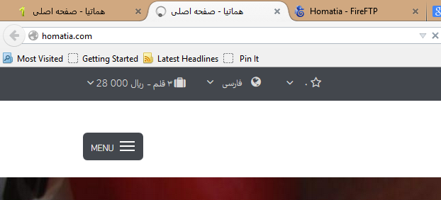

In fact, when I add a product to the minicart, I will see the detail of the transaction, instead of just a quick number changing up. See the 1.png.

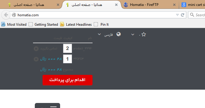

But when I refresh the page, minicart shows correctly. (2.png)
The strange thing is that wishlist mini is showing correctly, even when I add something to my wishlist.
What's wrong?
