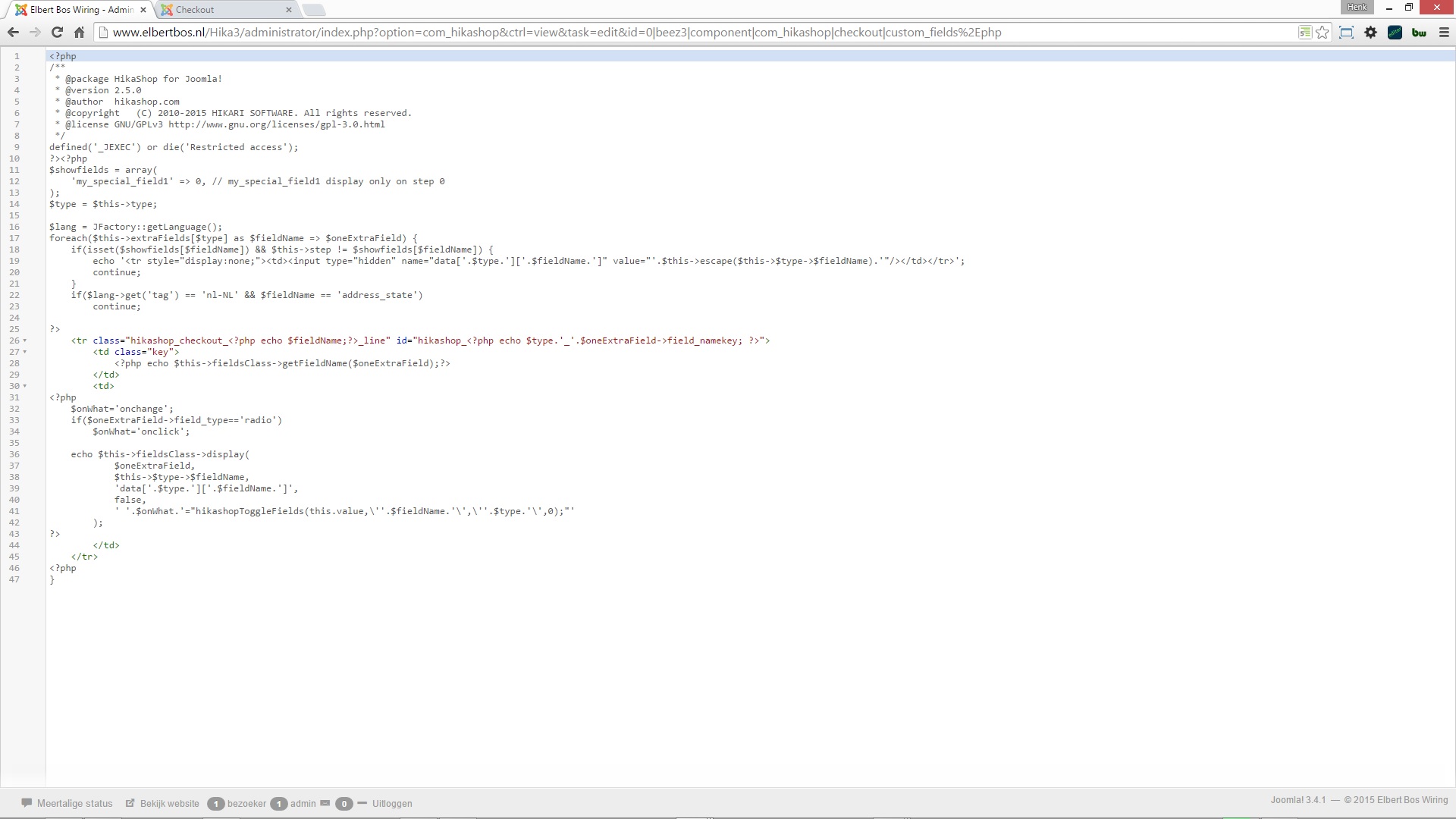

I replaced the code but it has no effect. Perhaps I did something wrong?
I assumed that I had to replace 'Your_Customfield_Column' by 'address_state'.
Is that correct?
11 years 2 months ago #206742
Yes.

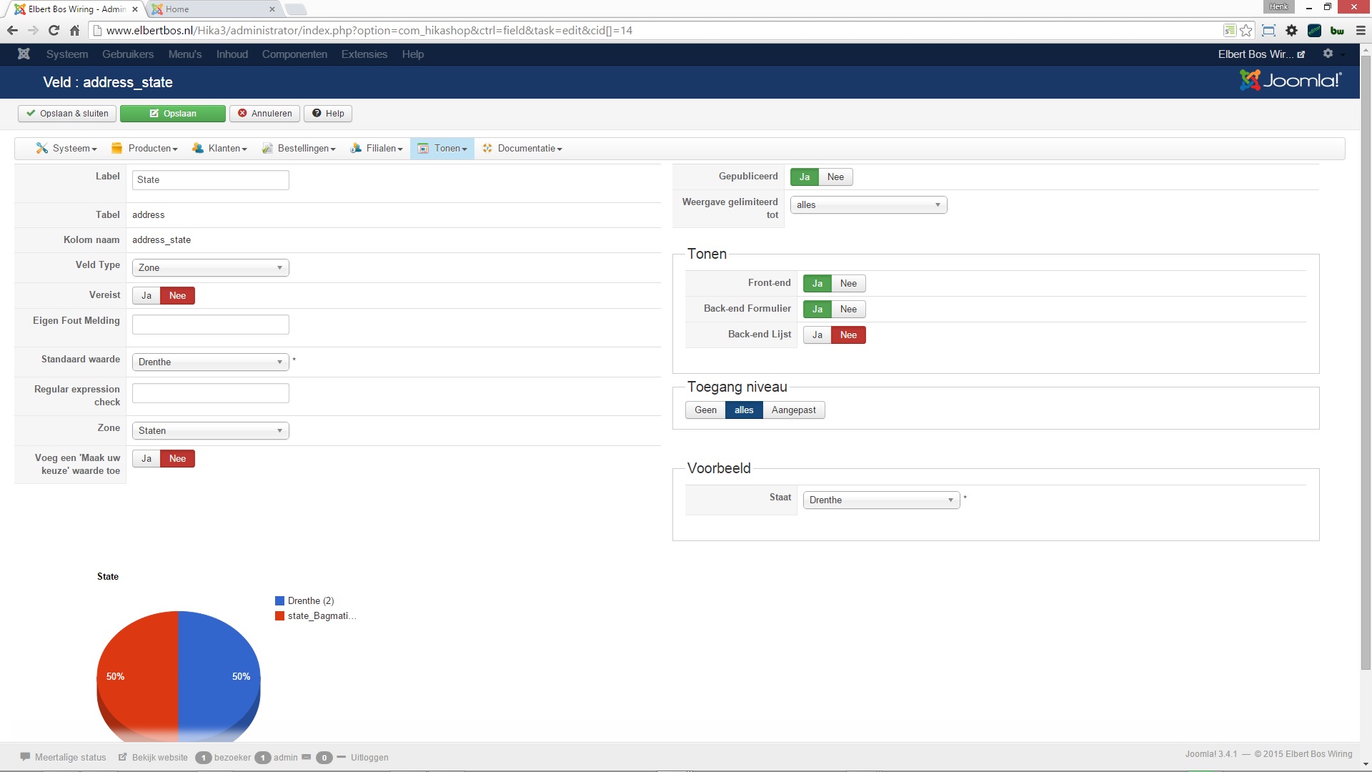

11 years 2 months ago #206880
But I still see a field labelled 'Staat' in the Dutch version.
11 years 2 months ago #206892
Can you show me how did you edited the code that I gave you and how you configured your "Staat" custom field through some screenshots ?
Thanks.

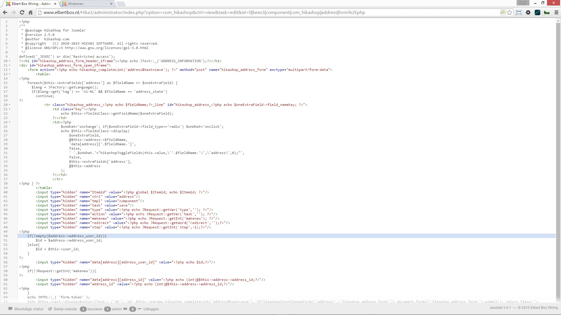

11 years 2 months ago #207378
If my editing is correct (see screenshot) I 'm afraid I edited the wrong file.
"Staat" is still there in Dutch.

It depends on which front-end template you're using (you are editing the view for the template "beez3") and which kind of address selector you're using in the checkout.
Depending if you're using the "popup", the "list" or the "dropdown" address selector, the used view in HikaShop might not be the same.
The "list" and "dropdown" selectors are using "address | show" while the popup is using "address | form".
The following user(s) said Thank You: elbertbos
  • Posts: 43
11 years 2 months ago #207452
You're perfectly right. I wasn't paying attention so I edited the address / form file for the beez3 template.
I should have edited this file for the favouritedark template. Now I've done that the problem is solved.
