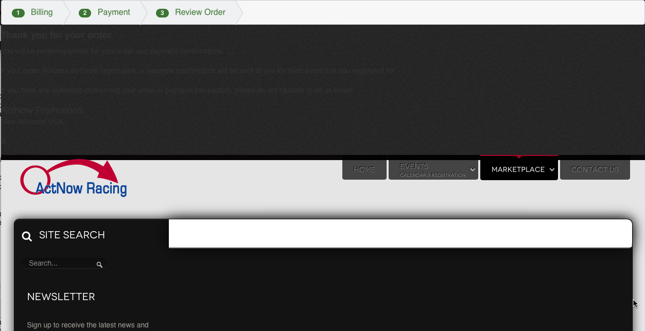

I can't figure out where the problem is with our installation. We updated to 2.5.0 a few weeks ago and started getting complaints from customers that they can't read the last page of the checkout.
It is our Thank You page, that is somehow now merged into a different locaiton on the page. It used to be in the main section of the template. I'm sure its CSS or something I'm overlooking, but it isn't correct.
Can someone take a look at it and offer some suggestions on how to put this back the way it was working before? I have removed almost all of the overrides that we had with the earlier versions.

I was able to check on the issue. I can only think at something else on your website flushing the output buffer at a wrong moment.
That's because even the HikaShop hidden footer tag is displayed before the beginning of the page:
take.ms/bUuvj
And so it means that Hikashop finished the processing of the page and hand out the HTML to Joomla/the template.
So to identify the source of the problem, I would recommend several tests.

Okay, downgraded and still getting the problem. No reports of this until this last couple of weeks so I've gone back to a backup from a couple of months ago and it wasn't there at that time. So I've made a clone of the site and have it running to experiment with.
What I've found so far is that I disabled ALL plugins (what a mess!!) and the problem goes away. I enabled only the Hikashop plugins and the problem returns, so its in one of the Hikashop plugins I guess and there are soooo many of them. Trying to enable one at a time, but I'm going to start with Shipping (USPS) because that is the only module I've had to update outside of the normal package updates.

The problem is with the Hikashop Mass Action Order plugin ... there really should be a better way of diagnosing this without spending 12+ hours enabling and disabling plugins.
There was a mass action for the trigger after an order is created. When the plugin was disabled, everything works correctly. When enabled and if I disable the action, everything is okay.
But when the mass action is enabled, and triggered on order creation, the output is corrupted.
The mass actions should really do a better job of formatting output in case of errors or misconfiguration. I'm not sure what the user was trying to do...it looks like that they wanted to create an export CSV file of any order created. I will need to contact them to find out what their objectives were.
But really, this shouldn't mess things up as badly as it does...either validate the action and prevent it from executing or control the output to prevent it from disrupting the presentation back to the browser.
