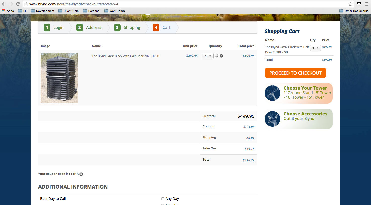

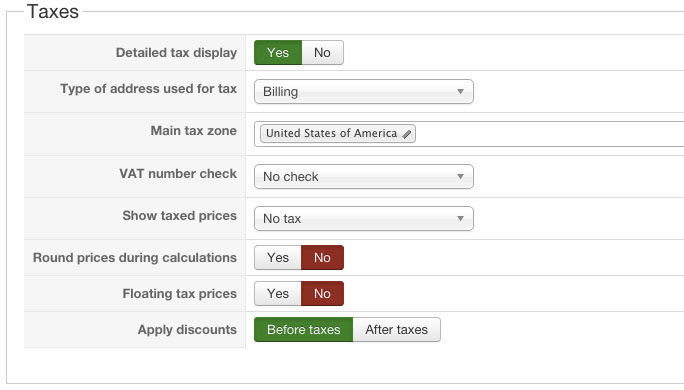

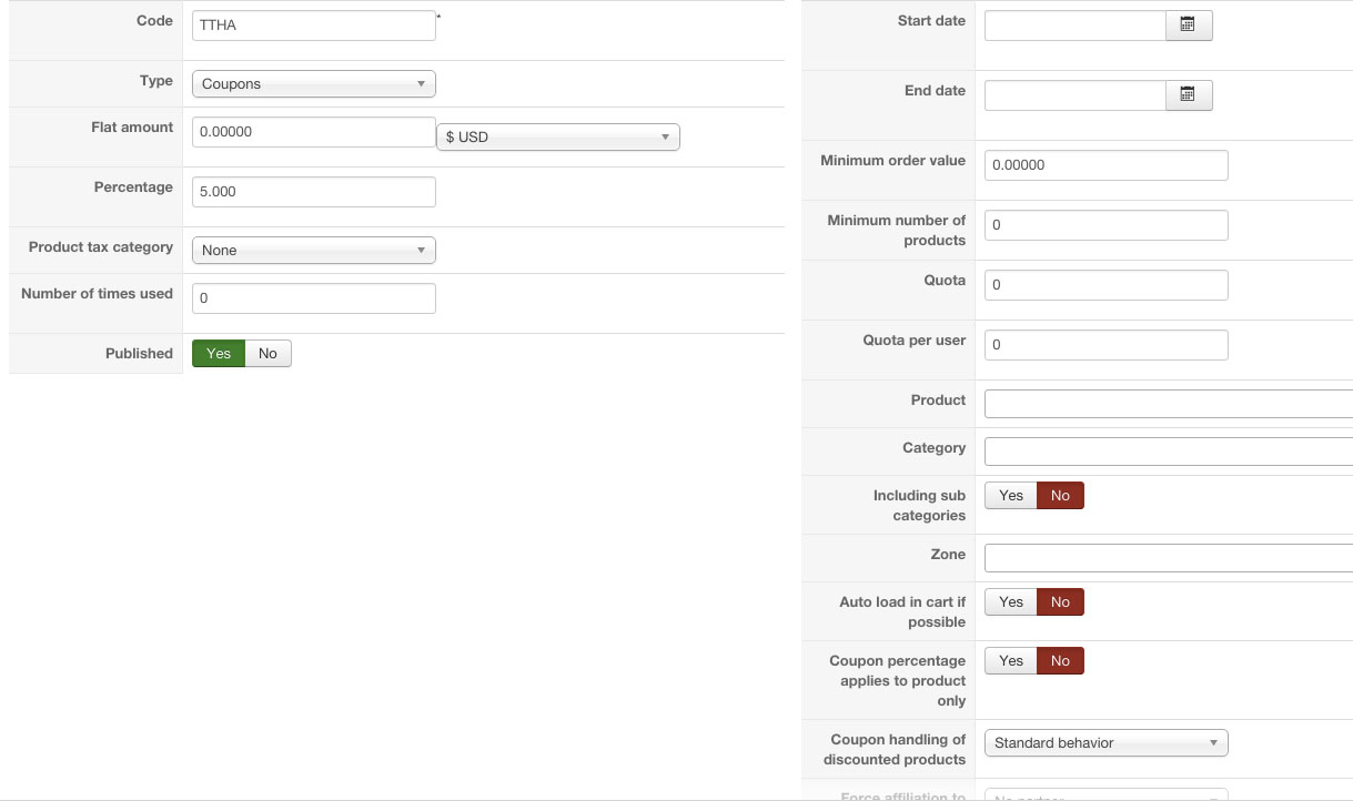

Tax is only charged on orders within the state of Texas, USA at the rate of 8.25%. Coupon is set for 5% off. Shipping cost is just set to 1 cent right now. All values are correct except the total is a little more than $2 too high. See screen shots for this, taxes configuration, and coupon configuration. I've read through some other forum posts, but they had other things going, like discounts, that mine does not have.
Please give me some direction on how to fix this. I can give you access to the back end if you would like.

Change the "tax category" setting of your coupon to the tax category of your product.
I that's not enough, change the "apply discount" setting of the HikaShop configuration.

Excellent! I set the coupon to the product tax category and ran a couple of tests. The total is now correct. Thank you!
